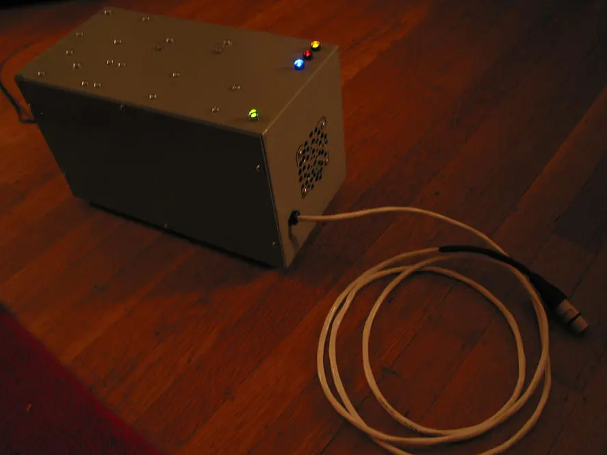

Power supply unit for Allen & Heath ( MPS8-P clone)
Hello,
I found this thread via google.
I just wanted to let you all know that I am now building (on demand) power supply units for many Allen & Heath mixers. Out of frustration of not being able to find one (and a local night club, here in Portland needing one), I built one based on the MPS8-P. Except that it has a built in fan and can withstand more use, heat, work, etc.
After materials and labor, the final cost on these will be $865
There are 4 LEDs (green for power, blue for -15v, red for +15v & amber for +48v).
The next revision will include individual fuses for each power supply at no additional cost!
If anyone is interested, I can crank one of these out pretty quickly (depending on my regular work load and schedule, etc.).
Check out my website at: www .wireaudiorepair. com/mps8p/ for pictures of the power supply unit.
btw, I realize this as my first post might seem offensive to some, as I just registered. Yes, I am promoting my product, but I am a musician of 24 yrs., an audio tech of 17 yrs and run my own independent business. I am here to provide help to the growing demand of A&H mixer users in need of a power supply for their mixer! Thanks again.
Sincerely,
Eric
