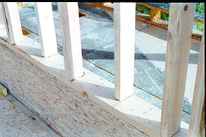

If you're talking about a "staggered stud" wall then the studs are staggered between each wall surface. The top and and bottom plates would be 2"x6" and the studs 2"X4". The studs on the control room side would all be flush with one side of the 2"x6" plates while the studs on the tracking room side would be flush with the other side of the 2"x6" plates.
Sorry I didn't have a good picture of when I built mine but attached is one I found on the web. I would highly advise you to use resilient channel to mount the sheetrock to studs.

Cool picture, I understand staggered studs now. But we are doing two walls with an air gap between them. Sorry for not being more clear.
