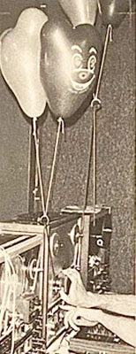

Bob Ostertag has a novel way of suspending his loops:
