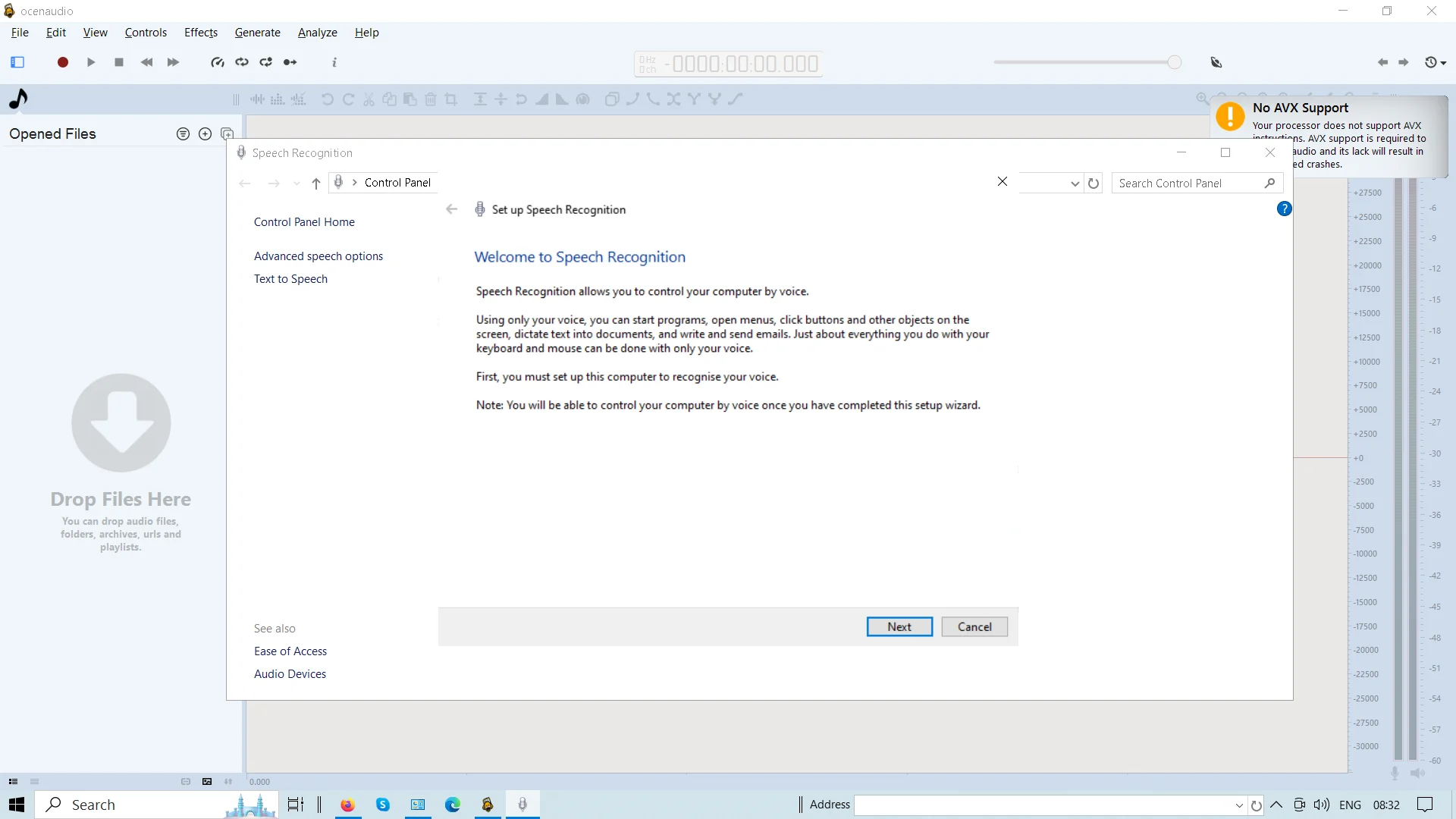

Is it possible, now that we know that he's using the built--in mic on his laptop, that it's perhaps a "voice/noiselevel" activation situation requiring a threshold adjustment to initiate the "recording" process on his laptop?
A dog not whimpering loudly enough to activate the recorder, but a barking dog crosses the threshold and the laptop records?
I'd like to hear what sounds he has been capable of recording recently.
Somewhere, out there, there's a simple solution.
This ^ is certainly a possibility . Audacity definitely has a level sensitive record function. Ocenaudio not so it seems but it does show the option attached.
I don't usually suggest them but in this instance a USB mic would probably give better results than the built in unit. If nothing else it would allow the laptop to be positioned in perhaps a more 'secure' place with the mic closer to pooch?

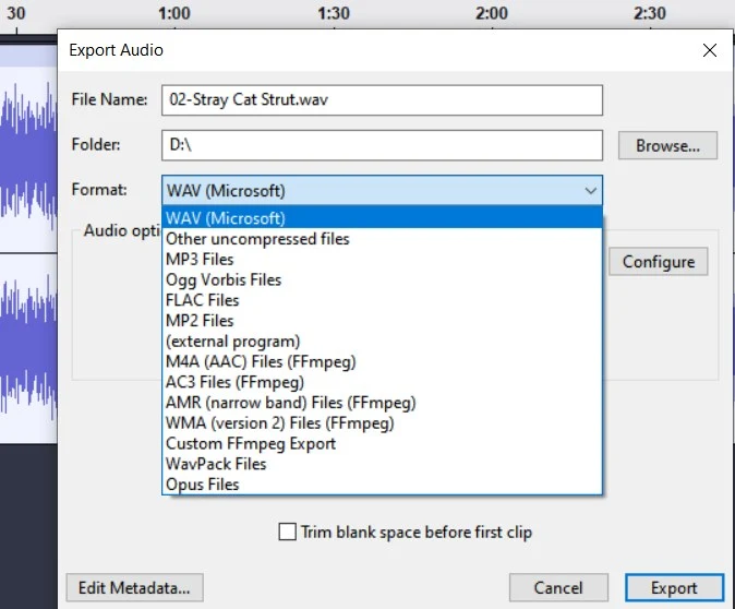

How can i make sure Make sure you aren't converting to MP3 in audacity?
When you export the recording, it gives you choices. Choose WAV, not MP3, FLAC, OOG Vorbis or any compressed format. It takes a much longer time to compress the data than to just save the data.

Slight issue there I think Rich? Audacity ALWAYS converts on export because it does not natively save as .wav but to its own special format.
Simply saving to that format will therefore be quicker AFAIK and OP can still review the material in that format, edit it and simply export the bits he wants.

Audacity will stay with the last format that was chosen for export. I generally use WAV, unless I need MP3.
It's in the Export window:
