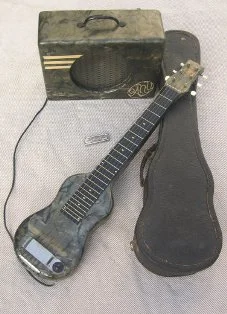

I just got this off of e-bay. Its an Oahu lap steel set from (I believe) the early '40s. Does anyone have any info? The amp doesn't work, I'm trying to find a schematic or manufacturer. Oahu didn't make their own stuff. Any help would be appreciated.
I'm thoroughly jealous based on cool factor alone. If you're unsure, it's probably best to trace out a schematic as I think those are all of two tubes maybe and one knob. Really simple circuit.
Three tubes and no knob. It doesn't even have volume control.
Do you have any idea where I can find anything about this rig?

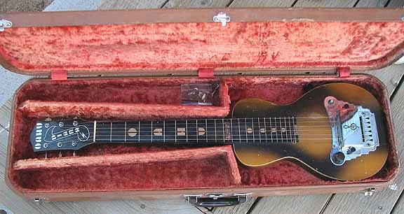

i thought i had one
in my pile of guitars
no amp though
and missing a knob
Cannabis,
I was actually looking for that model. My wife's name is Diana. How does it sound?

it plays a tune if you guide it along
but the strings are at least 30 years old
so the tone is variable
from one string to the next
also, i only have a solid state amp
available at the present
it's a little strident and might sound better
with tubes
i haven't really played it much
as i'm more into acoustic resonator
Cool piece anyway.
I got the rig. There's a short in the guitar. I'll have to trace out the wiring and break out the soldering iron before I can tell you how it sounds. It looks great. It'll be a good buy even if the pickup's gone.
The amp is a total mystery. It has 3 GE tubes marked XE5. One of them is 4 pins to a 4 pin socket. They are coke bottle style. I can't find any reference to an XE5 anywhere. I haven't traced out the wiring fully but it looks like it may be the rectifier. It has a 4th tube by Philco that looks similar to a 5y3 but it has no markings. As I said I believe it was made by Dickerson. I'm thinking it was made between '38 & '41. Any information would be helpful.
