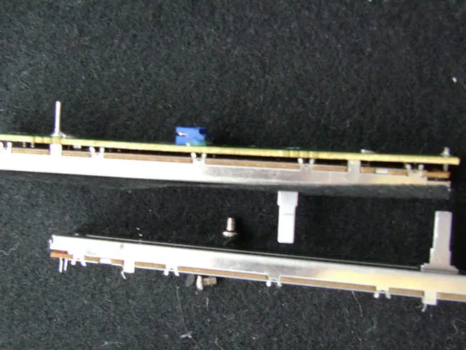

This is a bit of a story, so bear with me, here:
I've been having some kinda difficulty finding Numark TT500 Pitch Faders. One of the main selling-points of the TT500 is the "user-replaceable pitch faders," but because I'm Canadian, I can't buy direct from Numark (and they immediately delete any email I send them). I've thought about getting an American to order it for me, but I'm afraid that they might receive the wrong part, as Intellimix (Canadian distributor for Numark) sent me the wrong part (two slider-pots with no circuit boards - a pitch fader consists of a slider pot soldered in six parts to a circuit board that has a clip at the bottom, making it very easy to replace the whole thing). Apparently, Intellimix only sells the pitch faders as two seperate parts to be soldered together by the customer (not exactly living up to Numark's 500 marketing campaign). I tend to favour Long & McQuade (Edmonton, AB) for most of my music-shopping, simply because the staff there have always been good to me. Luckily, they've been more patient with Intellimix than I would be - playing phone-tag, getting hung-up on... the last time my rep spoke to Intellimix, the latter asked my music rep to send a picture of the piece in-question! I've been dealing with this (yes, I've attempted to utilize other music shops in town and I've tried to get a hold of intellimix myself) since May 2008.
Ultimately, has anyone here ever had to deal with something like this? Does anyone have any suggestions?
My pocketbook may not be as expansive as other clients that Numark has, but I've been using Numark turntables for years (inter-changeable tone-arms, more pitch control in the 500's - +/-50% - which is probably why it's giving me such a hard time), and have stood up to the 1200's-fans out of blind loyalty (I'm one of those poor people who tries to eke out a living on their hobbies, and so Numark tends to be affordable). Maybe it's time I broke down and traded-up for Stantons?

hello mate i live in the uk and have been trying to get these for a while and got them yesterday. basically the pitch fader slide pot you received is the correct part all you need to do is get your hands on a soldering iron and desolder the metal that sticks through the circuit board and then solder the pitch fader pot onto the old circuit board. it is the slide part that is faulty not the circuit board.
shouldnt take you to long to do to be honest as its only a flimsy metal connection thats needed with them.
also ive just found out from phoning numark support line that the tt 500s do NOT come with user replaceable pitch faders at all! what a good little marketing gimmick that is then! :mad:
good luck! im getting on it tonight as have been without working pitch faders for a couple of months now!

hello mate! i have no idea it was about a year ago and the old noggin aint that good. have you tried numark europe (if in the uk) i think they put me onto their spares deptardment and i got it from them. they sent me an extra set cos i said the first parcel never arrived cos it was such a mission. you will need to solder the new chipboard onto the sliders as well

no problem. i've looked into getting a replacement and i have a few options. i'm going to look into getting my current one cleaned up first as well, to see if that makes any difference. it seems that other (better) turntables have an internal calibration resistor for the fader but i can't find one inside the tt500

fixed!
in the spirit of being a good netizen, i'm reporting back with how i've been able to solve this problem: was finally able to order the replacement pitch fader from numark uk (£6 + £6 p&p), then solder the circuit board from the back of the old fader to the new one. once installed this fixed the problem
