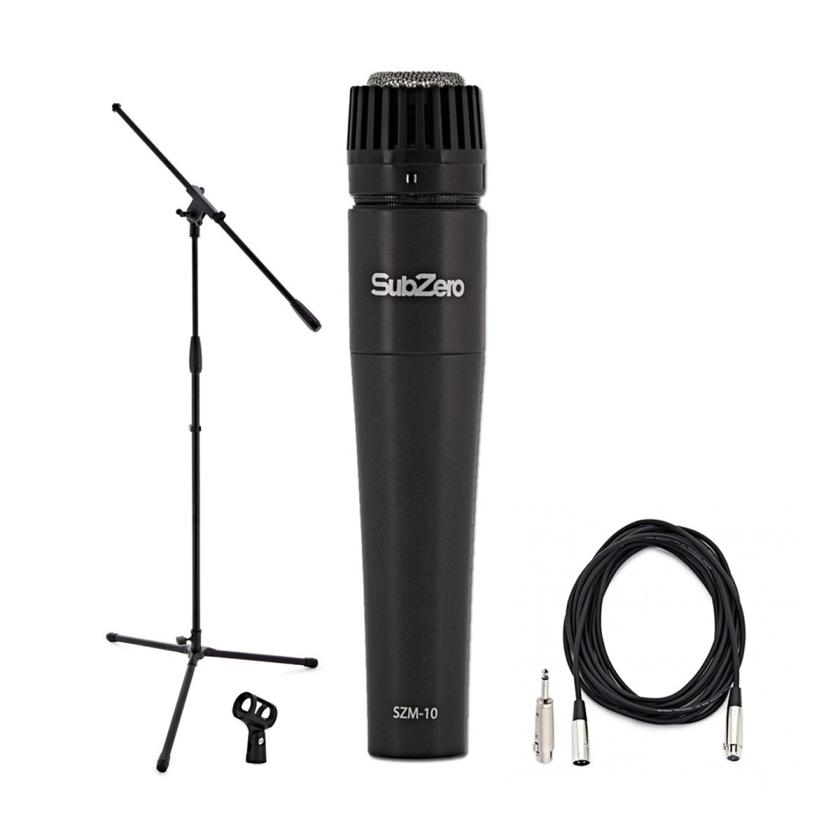

HI everyone, im just starting out recording, my setup comprises of a macbook with garageband, a subzero dynamic mic and an XLR to USB cable plugged into my computer. Ive started trying to record some stuff today and there is a horrible background hiss that ruins the sound (ill attach a sample). any advice on how to solve this would be greatly appreciated.

I'll cut to the chase here: Get an interface, something designed to send in signals from mics and line signals, as well as give you the ability to monitor what you're doing. Something like the Focusrite 2i2, for instance. There are resources here that can show/explain how to properly mic up an acoustic guitar. That USB mic is really suited for podcasting, and the subzero dynamic appears to be a knock-off of an Shure SM-57, a fine mic, but not necessarily the best choice for an acoustic instrument. There is a huge range of affordable condenser mics to be had out there, so look into that.

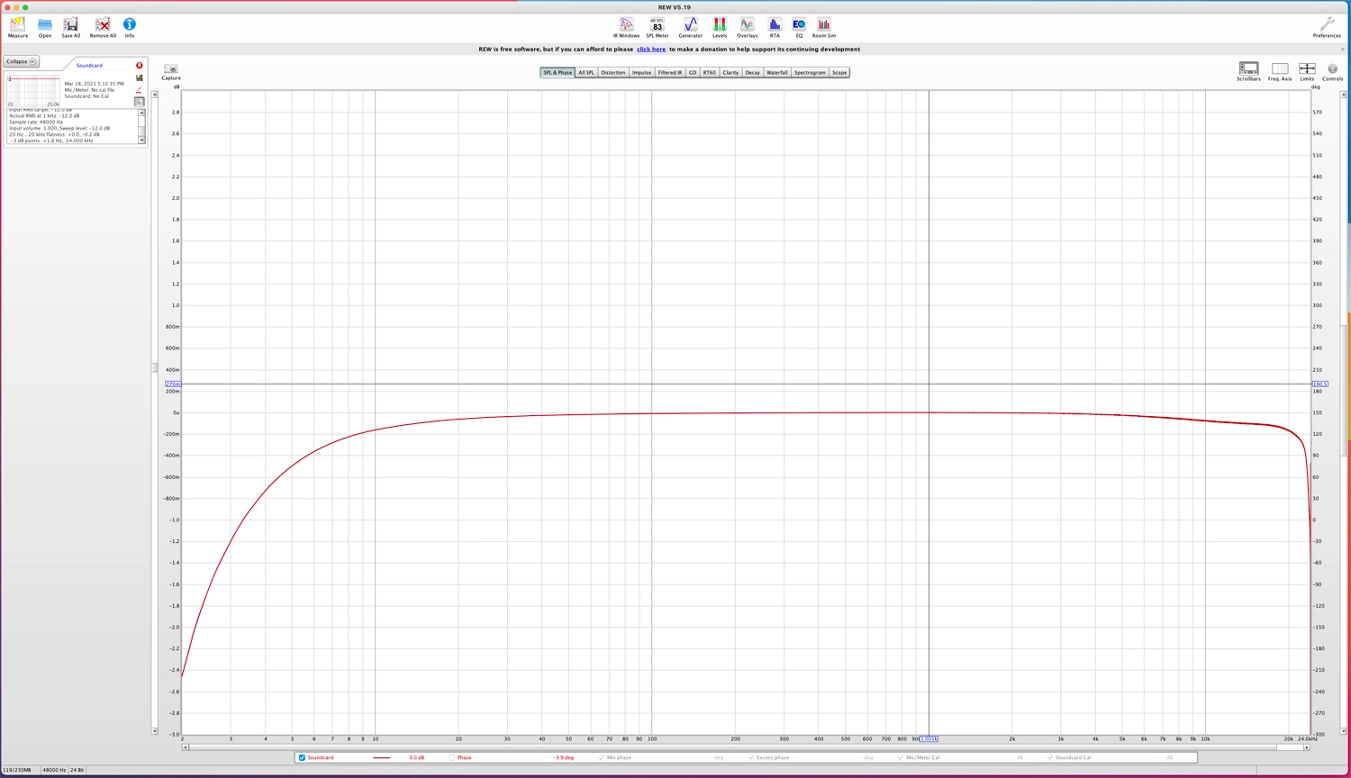

I picked up the 204HD for my video editing system but have been using it to take room measurements of the studio. One function of REW (Room EQ Wizard software) is calibrating the interface. I was more than a bit curious how the calibration would turn out as everyone beats up on cheap Behringer stuff. This is the response graph of the interface. Impressive for a short money device.

Folkcafe, it might sound rather flippant or arrogant but I am not in the least surprised at the very good result of that response sweep of the Behringer interface. We have been able to make electronics with a flat, 20-20k response for decades, what IS gratifying is the lack on that curve of spikes and artifacts.
The "cheap versus high priced" audio devices debate will ever rage and I will concede that IF you have a set of Neumann/PMC monitors at $8k the pair AND avery well treated room AND some wide band IMPECCABLE sound sources you probably CAN tell a 204 from a Prism or Benchmark but in the world 99.99% of HR peeps inhabit, no way. That is NOT to say I agree with Behringer's business practices and I look for alternatives when I can (I don't buy much these days anyway) I am, at the moment quite taken by one of two very cheap interfaces by M-Audio and intend to get one to size up soon.
The 204HD does have its 'faults' however. One is the very low maximum output of, iirc, +4dBu (1.22V). This WILL drive most active monitors adequately but it is wise to check if yours are rather lower in gain than most?

This was a purchase for a video editing set up that has modest needs. I mainly purchased this because it has inserts which was harder to find in a 2 input interface. Allows me to keep a Drawmer comp plugged in. I always found it sounded neutral. My point is simply that I was surprised how well it measured when I set it up to do acoustic measurements. Clean hasn't been an issue but I'm also not pushing anything that needs a lot of gain such as the OP of this post.
