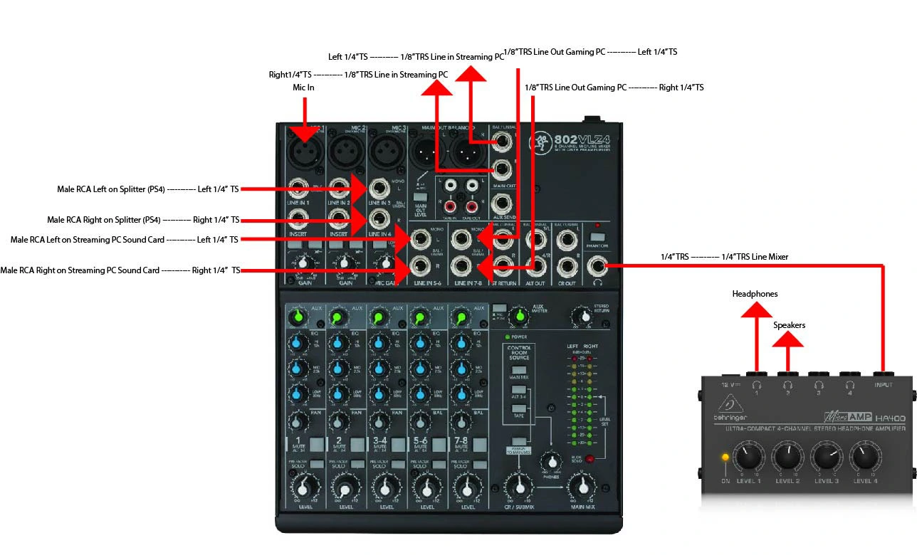

As a preface I am new to the audio world. I have a two pc streaming setup. The issue I am having is that my game audio is not in stereo but in mono. I have trouble shot the source of the issue down to my mixer. The game audio comes out of my Line Out of my gaming PC and into channels 7-8 of my Mackie 802VLZ4. The jack out of the PC is 1/8 stereo and the input to the mixer is dual 1/4 TS. The Headphone jack on the mixer will only output Mono. I am very confused. The Cables are not the issue as I have swapped them all around. I think it's just a lack of understanding how the mixer works on my part. I would appreciate help. I will leave I diagram of my setup. Not sure if it will help. Please ask if more info is needed. Also its isnt my PC. I get stereo when I plug directly into it with headphones.
). The solo button does appear it would kill the other channel(s) as well, unless a couple more are pushed in(?)
