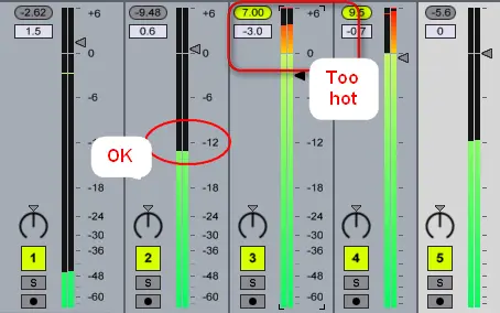

You should have VU meters that deflect with the input audio signal similar to the image below (this is supposedly Live 6). As Jimmy stated you likely want to be around -18dBFS. The level shown that is "OK" is a shade below -12.

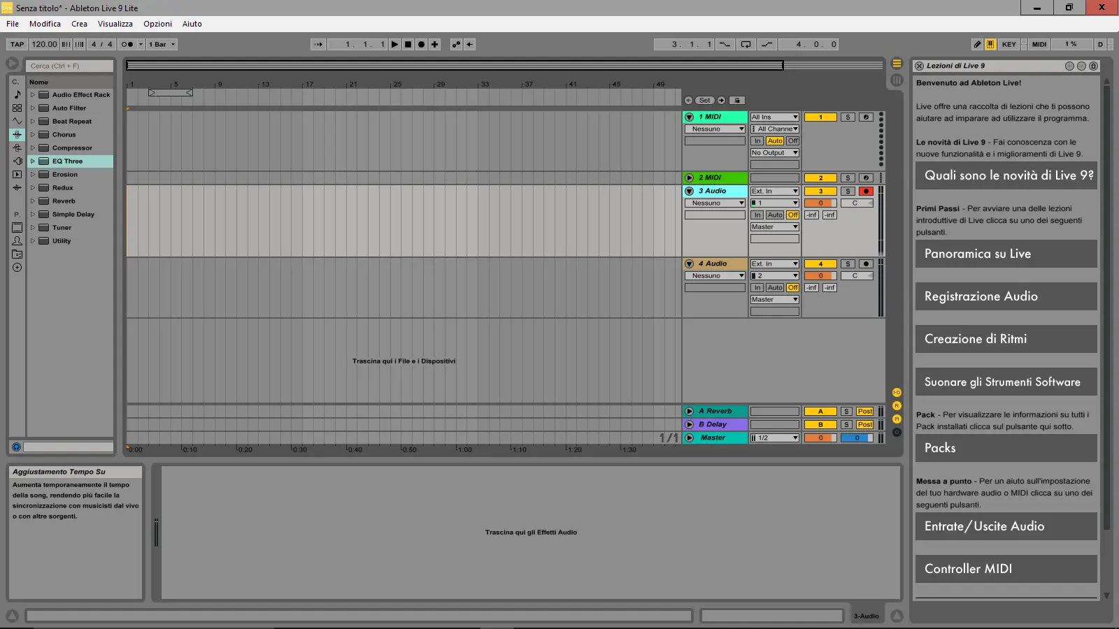

I tried to attach a picture of Ableton!
It's in italian, but I guees you can help me anyway :p Where can I set the gain?
