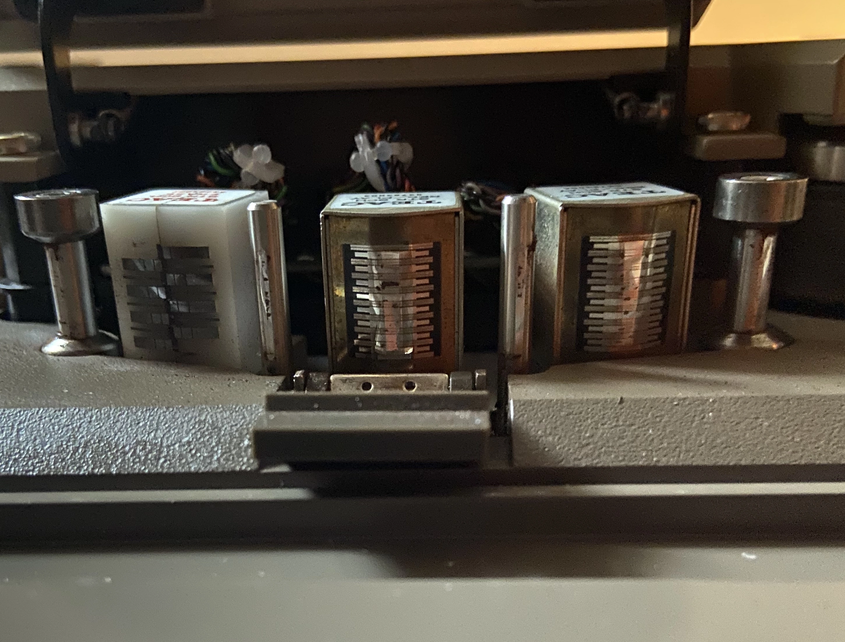

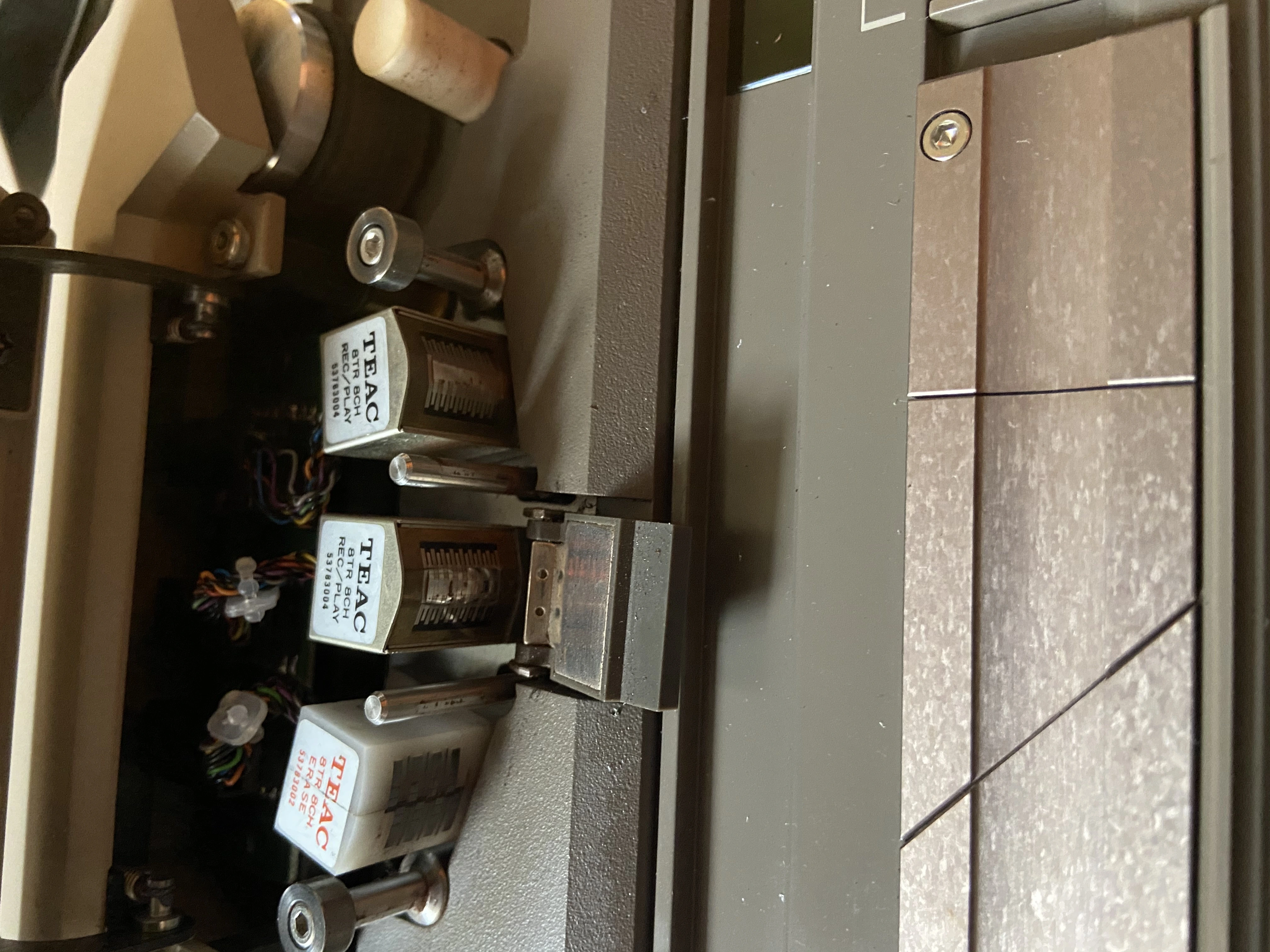

Post a close up pic of the heads under good light.
We can verify they are clean. There can be a layer of schmutz on them that looks like clean but is not.

So here are some pictures of the heads.
They are definitely dirtier than I thought, and I know it is because I only had an old baked Ampeg 456 Reel that to came with the machine to demo it. That was my first experience with sticky shed, and I can see how quickly it gunked the clean heads up. My new reel of ATR just arrived yesterday.
Getting isopropyl alcohol during the pandemic has been difficult, I have been waiting on a bottle I ordered for 2 weeks now. I do have some American Recorder Cleaning Fluid arriving this Thursday.
I went through and tried to record on tracks 1-8.
Track 7 seemed to retain a little bit of signal, and Track 8 came back perfectly. The rest, nothing.
You can go to the hardware store and get denatured alcohol. Make sure it is virgin and not reprocessed. It should say in the detail on the back. Denatured alcohol is as good or better than 91% iso alcohol.
Use high quality cotton makeup remover pads, the kind that look quilted, to clean the heads, lifters and guides. That will work better than cotton swabs.
Then use your new tape and retry your test, tracks 1-8 and report back the results.
If you can record at all then it is not a problem with the bias oscillator...that was my first thought. Once the tape path is truly clean and you are using new tape then we can get a baseline for what is working and what is not, and if the problems are stable we can start swapping amp cards around to see if the problem follows the card to further narrow down the problem source, and if the problem isn’t stable and “moves around” it is usually related to faulty relays.
All of this we need to methodically take step by step. Okay?
Start with a good and proper cleaning using the proper supplies and then retry your record testing across all tracks using new tape and report back.
