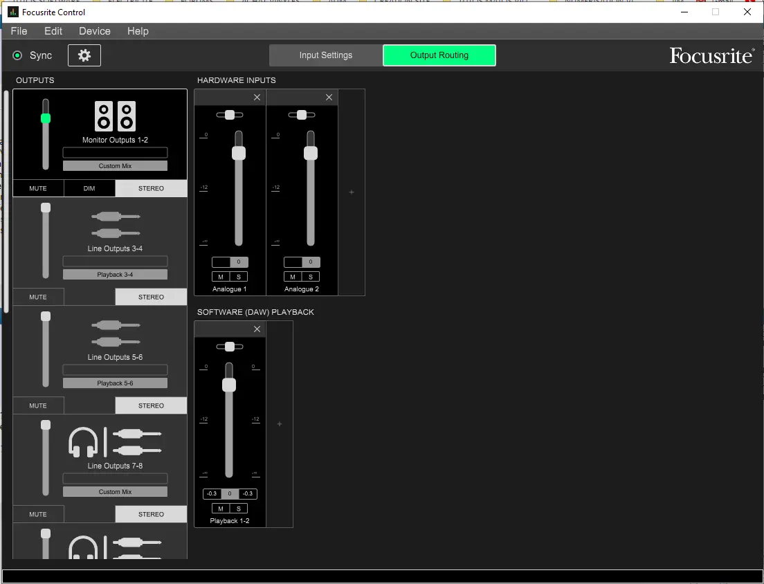

Post a screen shot of the Mix Control setting. Will mean little to me but might to someone here.

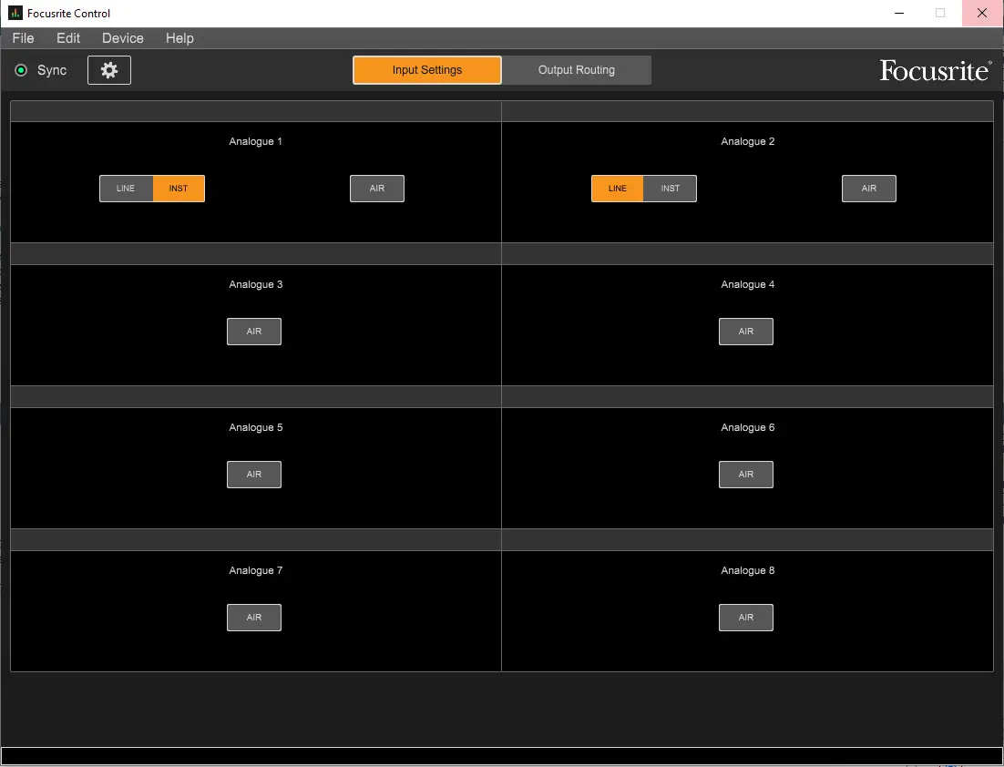

Here are 2 screenshots : 1 for the input settings, the other for the output settings.
I plugged a guitar on input 1 and a mic on input 2.
Nothing appears on the units meters when I play guitar or sing in the mic with gain knob at maximum range.

You probably don't want LINE lit up for a mic do you?, or is that irrelevant when an XLR is plugged in, and that just a radio-button type of control (i.e., one or the other must be selected)? My old Saffire has hardware buttons so they don't show up in the Mix Control app.
I guess the question is whether you can clip the pre (red light?) on the interface by cranking the gain there. Is that what you mean by the "units meters?" Looking for life at the first stage of the interface first, and then the DAW. That would show, at least, that the preamps are working on the F'rite.
Is there still that weirdness with some input level in Windows Control Panel audio messing things up? Did you check the Control Panel settings? (Not a Windows user now for almost 4 years.)
