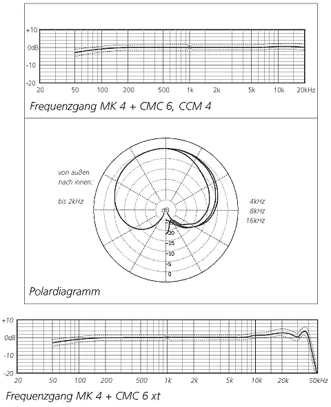

A "bump" is a voltage (volume) increase for a particular frequency range (e.g., 4k Hz to 8k Hz) within that microphone's overall frequency response (e.g., 20 Hz to 20k Hz). A "dip" is a decrease in the voltage (volume). Mic response is represented by two graphs, one is x-y for the frequency response vs. volume and the other is a polar graph which shows how well (how consistently) the mic pics up various frequencies at different angles from the front of the mic.
Flat response mics are more difficult to make, and cost more. They are more accurate. All mics will lose some response in the higher frequencies off axis, but some lose less than others or "lose" it more smoothly than others.
Most mics do not have a flat response. Indeed, many mics have bumps on purpose.
You can find the xy and polar graphs for the C4 and 4041 at the Studio Projects and AT websites, respectively. Many will say (and they're right) that these graphs don't tell all. Nonetheless, learning how to read the graphs helps in a basic understanding of how the mic will work (or not work) for you. Here's the graphs for the Schoeps CMC6/MK4 small diaphragm mic, my favorite mic for solo fingerstyle acoustic guitar. The x-y response is flat, nearly "ruler flat". The polar shows a smooth fall off of 4k, 8k and 16k Hz frequencies off axis (at 90 degrees).
