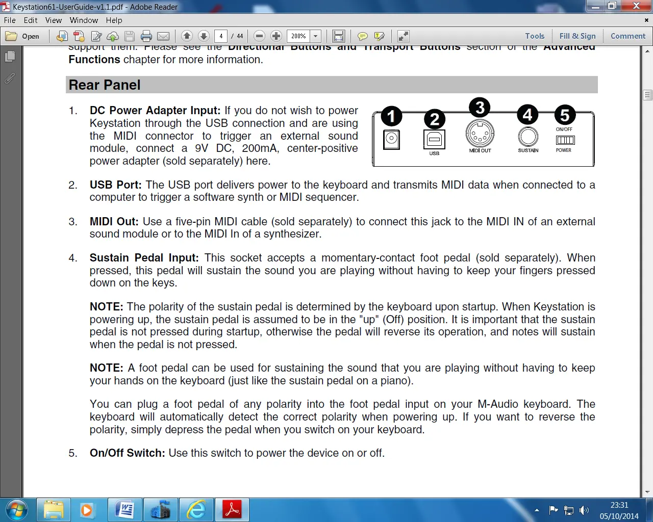

Attached is the rear panel connections of the M-A Keystation 61.
The DIN out can be taken to the MIDI input of an AI such as the UR22 when it can play software instruments in a PC.
N.B. this connection regime will NOT give any better or worse latency than using the USB connection protocol. It WILL however give more flexibility if other MIDI devices are to be added in the future some of which might not have USB capability.

Just realized. That is EXACTLY the same rear panel layout as my Ekeys 49!
