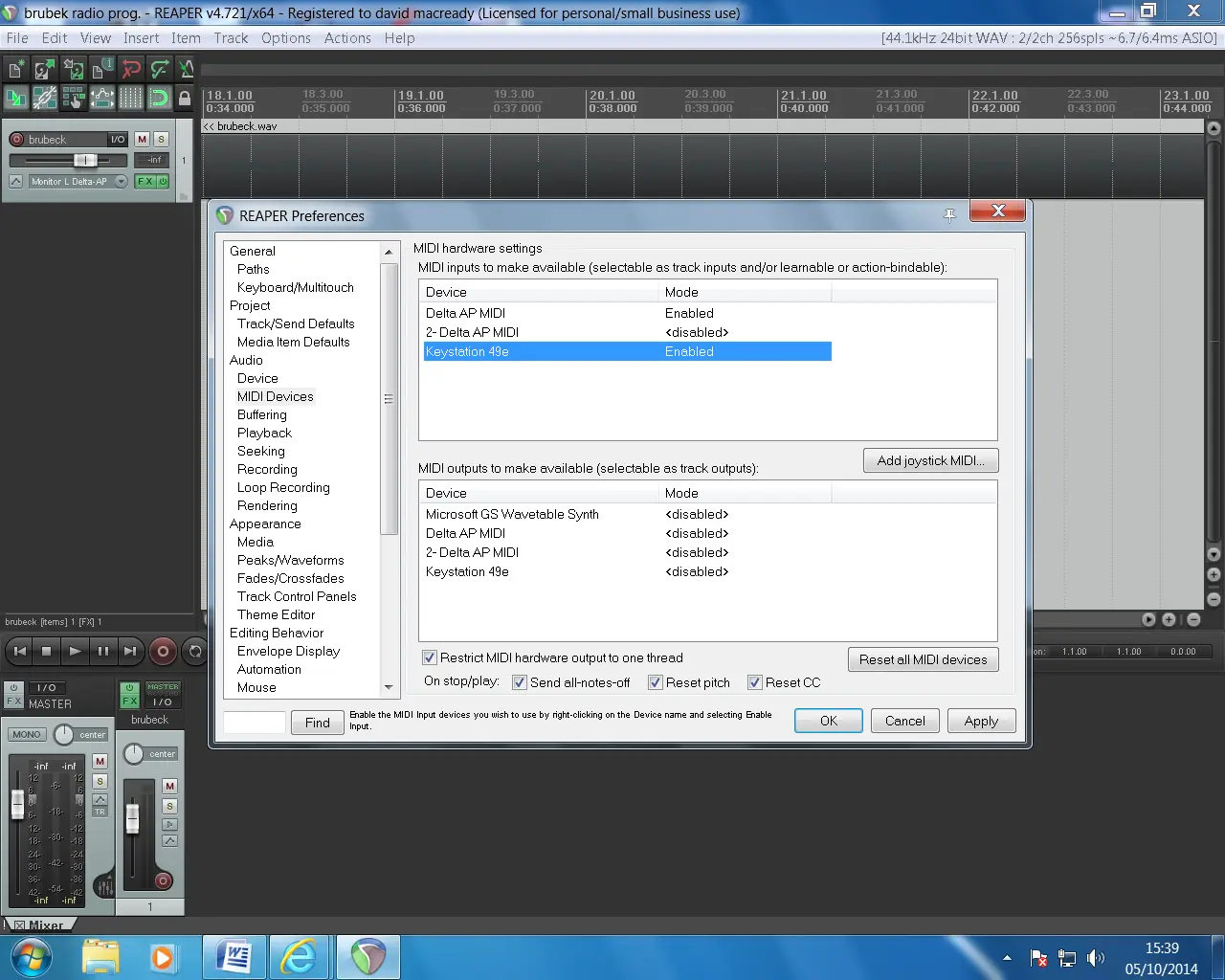

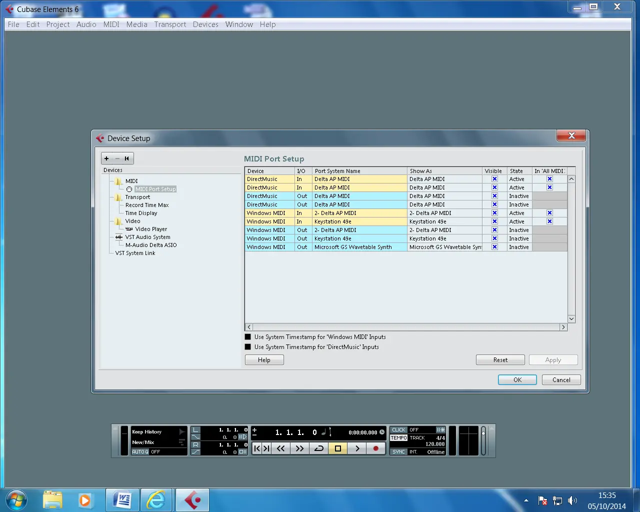

The Oxygen will just plug into the USB port of the PC and if it is like my Evo it will install in a minute or less.
If you are using the Cubase Steinberg provide you should find the screenshot I have attached. If Reaper I include that as well.
Don't be awed by the complications, just proceed in an orderly fashion and you will sort it. Then there are several Cubase experts here to help. I know a tiny bit.
