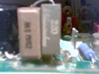

What are these? i dont like how they are attached together so crappily.
Those are two power resistors that someone has jury-rigged in there in series (probably to replace a single one of higher value.) Looks like there might have been problems with this amp in the past.:)
is there a way to find out what value resister needs to be there, so i can replace it?
