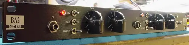

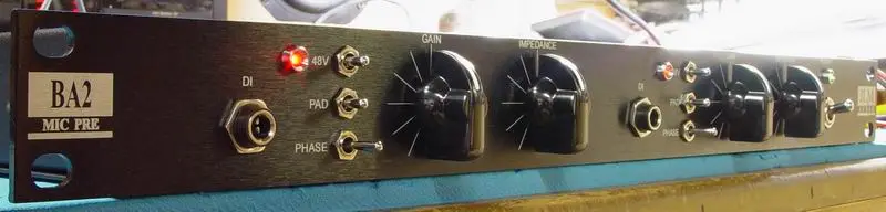

I finally found time to assemble my JLM Audio Baby Animal 2.
For this build, I used Joe's custom 1:4 input transformer, John Hardy 990c opamps, and Carnhill output transformers. Because of the high gain of the JH opamps, I was able to tweak the gain to achieve about 78dB.
I have only done very quick listening testing to confirm operation, but so far so good. This preamp has variable input Z which certainly influences the timbre of the input signal.
Must say that after a long DIY drought, it sure felt good to smell solder again :cool:
And no finger burns for a change :facepalm:
Here are some pics. (Apologies for the size. I thought that the uploader might resize them...)

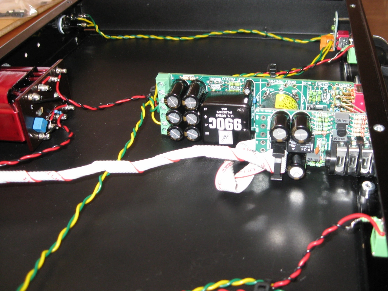

I have to ask, what are the resistors you put on the 5 and 8 pins on your transformers?
This is a Zobel network on the output to help ensure that the output doesn't oscillate. It is a 1.5kOhm metal film resistor in series with a 0.01uF cap across the output.
To be honest, I don't know if it is strictly required, but several schematics I have seen in which the Carnhill is used have a Zobel installed. I do have a o'scope, but haven't bothered doing much testing.
Some schematics also place a load resistor of 820Ohm across the output. I didn't bother with that.
Hope that helps.

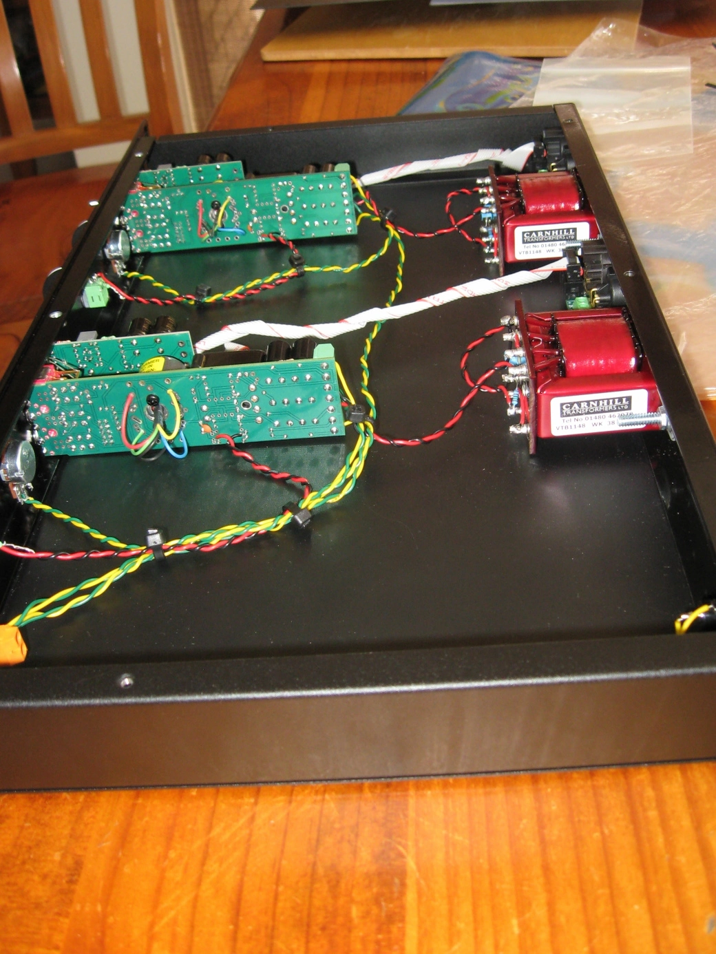

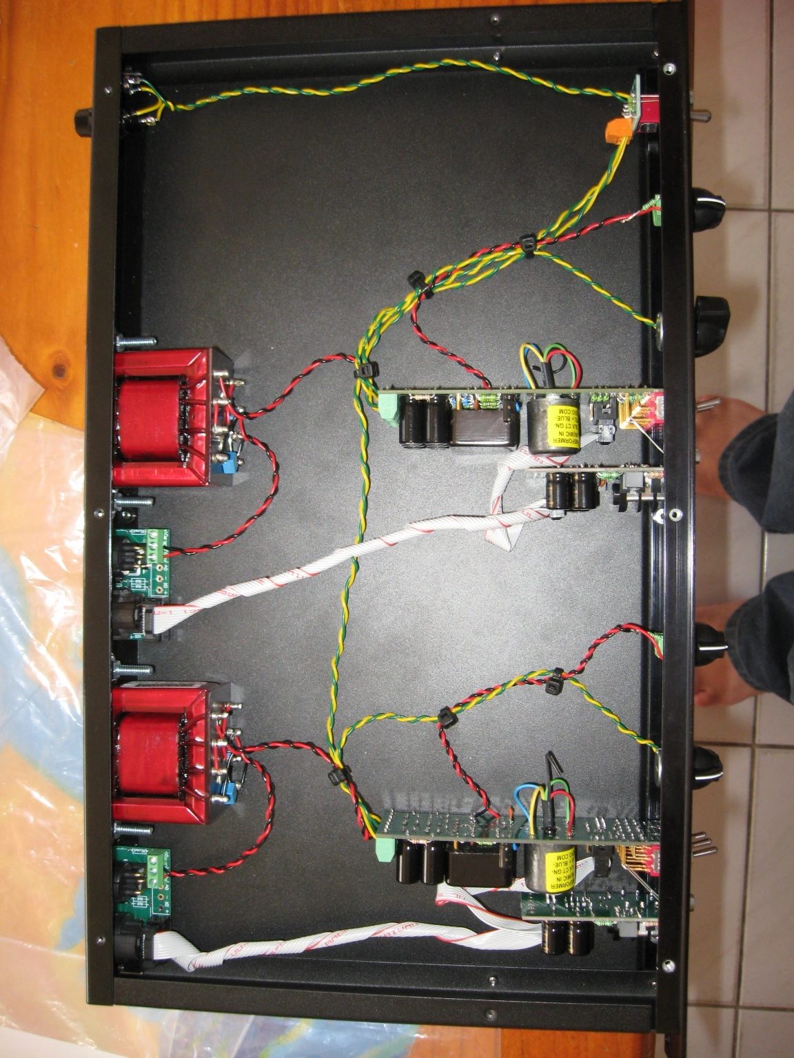

One thing I did build in the meantime is a 4 channel JLM Baby Animal Neutral preamp.
They sound wonderful - clean and clear and smooth and quiet.
I installed these in a 2RU case. If I can get the finger out, I'll put up some photos.
