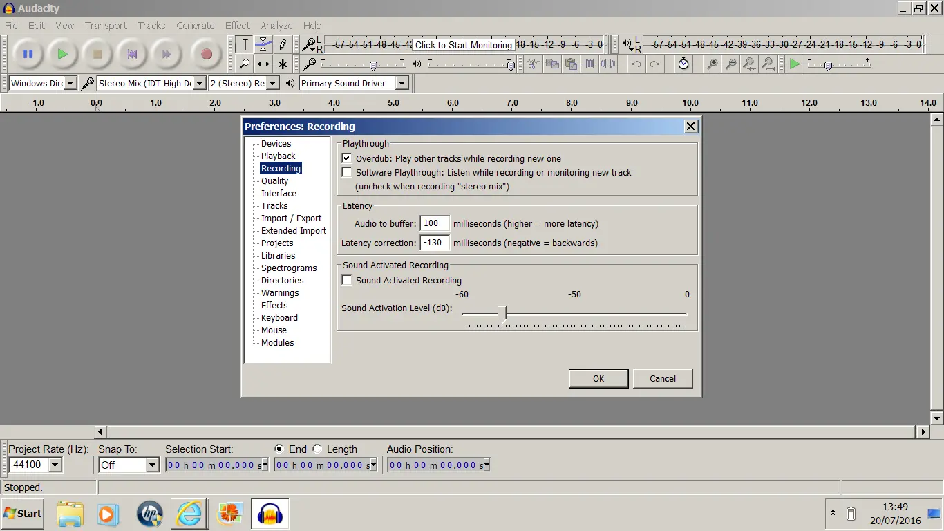

All may not be lost. See attached, this HP laptop gives the default latency for Audacity as 100mSec, that is A LOT!
You get that screen from "Edit> preferences" While there check a few other things. The default driver is Windows Sounds but MME or WASPI might be better (and try ASIO4ALL)
Check the bit depth is 16bits, since that is what the mic will be and that the bit rate is 44.1kHz (or you might have to go with 48kHz) N.B. Audacity saves work in its own format, best to "export as .wav"
But! Reducing the latency to say, 10mS will probably cause crackles and stuttering. Check any redundant services that are eating CPU cycles. Stop any Wireless kit. You should find a value for latency that works.
