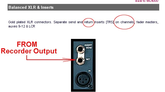

Why so many ways for a simple straight forward question? :confused:
But, anyway.
So I take it as by "mono line inserts" you mean channel insert's return jacks. Correct? Please confirm, just to avoid any potential confusions.
In case if "colorful language causes some problems", here's visual:

Yup.those are them.
Bypasses the internal pre-amp and goes to EQ and summing amps on the mix bus.
So, recording path goes directly to the tape machine for the simple reason that you only introduce the pre-amp and the recorders line amp. Since a line amp has low voltage gain, the "coloration" is held to a minimum. This is one reason why different tape machines *sound* different and people like the "coloration".
Mic pre-amps have a gain of *thousands* and any coloration added by them will be simply HUGE.
Most consoles line input is the mic pre-amp with a 1 to 1 gain (unity) and the mic pre-amp is the same amp with a gain pot.
Adding the consoles pre-amp together with the outboard pre-amp is adding 1 more stage. You know that the purer the path, the better the sound, so using the insert only adds the EQ (better, not best) and the summing amp (Mackies and Behringers have very weak summing busses BTW).
So, in record mode, the best path is outboard pre to deck directly because you have the best possible signal recorder *reguardless* of what you mix it on. In mixdown, you are pretty much stuck with what you have, so choose the shortest possible path you can because adding the onboard pre-amp is adding 1 more stage. If you use the line in for record/playback, you end up adding 2 more stages and what you didn't like about the sound (why buy a better pre-amp if you LIKED the sound of the stock ones?) will be done to the recording twice.
Maybe this makes sense, maybe not. Who knows?

EXCELLENT!
There are still:
... some "glitches" there for a "picky head", like "1 to 1 gain", which I suppose would mean "gain of 1" which comes from "X to X", what ever "X" value may be. But this kind of stuff is not 'critical', so can be ignored.
..and argueable lines like: "the purer the path, the better the sound", which I can't agree with as a general rule, because to me art of recording in general is all about messing up the path.
As for mic amp vs line amp. Physically the same amplifier (or say, - circuit) can be "configured" (set up) as a line amplifier or as a mic amplifier by altering some components or their values or both.
Bypassing amps where ever you can spot one and get away with it may or may not make sense (and I mean practical sense first). And it is so regardless of how it is/has been done here or there by Mr. X or Mrs. Y.
And an amplifier is a mic amplifier is not because of it is called (or labled) "mic amplifier", but because of it is an amplifier that is capable of providing appropriate interconnection and amplifying the microphone output signal to the line level.
As for "coloration". Coloration is not that an amplifier "adds to the signal", but rather is what an amplifier "adds to the signal" at specific setting. Setting of an amplifier can be fixed or can be selectable or adjustable.
