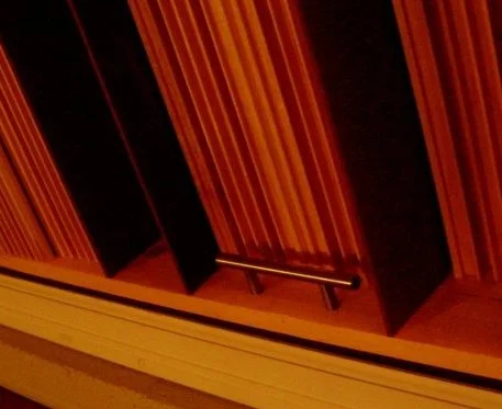

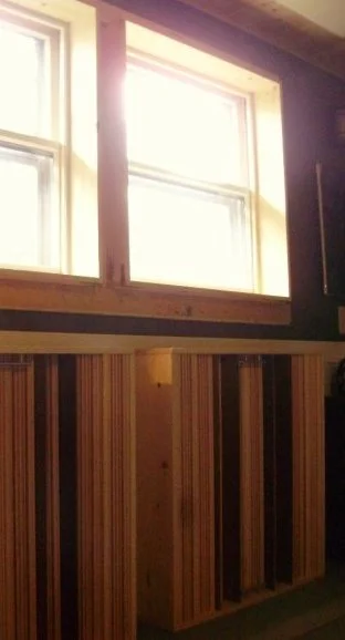

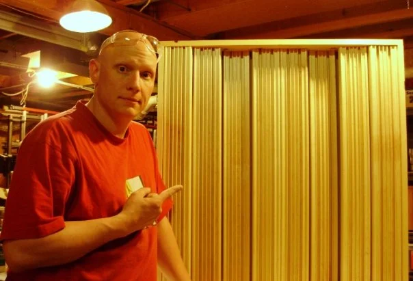

Kinda like this! (I made some for the front half of my window plugs!
:D
Scott.

How did you make the mini QRDs?
I was working at a high-end cabinet shop, we got a job making QRD diffusers for a round church which had a very high ceiling. We milled the maple at the shop with our molding machine, the knives that cut the QRD profile were custom made. Because maple is a hard wood, each piece had to be run 3 times to get to the spec depth/profile. There was a bunch of scrap left over and I was able to take it. It's been in a tidy covered stack in the corner of my garage for about 3 years now.
