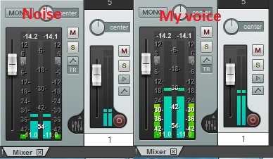

It's ok, I think I got it to work pretty good. Here is the sound of the noise and then my voice without the reafir effect. After I did it the noise was at 0 and my voice was still at around the same level. YAY! Is there anything else I need to do?

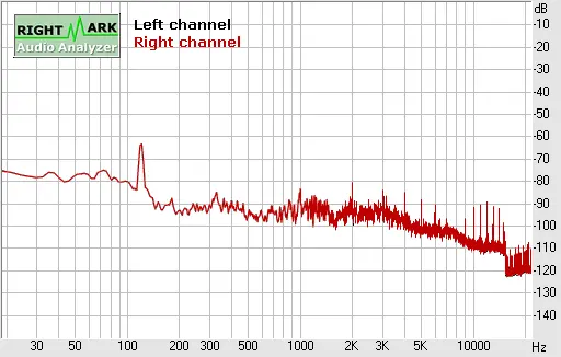

Attached is the spectrum of the last 10secs or so and you can see I hope the 120Hz spike?
Being second harmonic mains means that is power supply hum from something. Induced hum would be 60Hz or 180Hz and harmonics thereof.
Sooooo! HPFilter (bass cut Call') at 200Hz should stop it and not going to hurt a gals voice?
