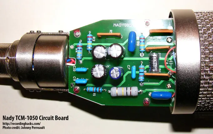

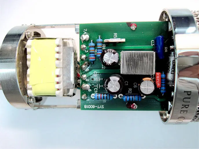

...here's a closer look under the hood...stock Nady TCM1050 (photo courtesy of Recordinghacks.com) on top, Stellar CM-6 below...

Yeah that would be pretty rare for a mic. It's funny; it's practically universal for input transformers, but preamps are more likely to be in close proximity to low frequency EMI than mics . . . still, I would use mumetal if I could fit it . . .
No real need for mumetal inside a mic. It isn't near a power transformer. The body of the mic + ground is shielding enough (usually).
I saw this mic on eBay yesterday. Looks like he's spot on for the most part. I would change the capsule to a K47 style for sure. I'd also ditch the 2.2uF for a 1uF. I know most people think its going to improve the low end, but in reality...
Another reason I like Lundahl and some of the Jensen transformers. They come pre-encased in mumetal.
I don't think it is. I think its just nickel plated brass like the rest of the body. I should probably cut into one to be sure.
Nope, there is very little sense for brass to be there. If you check it, it is actually magnetic, in other words, mild steel. Not as good as mu-metal, but not nearly as useless (for shielding purposes, of course) as brass.
On the other hand, as you have already mentioned, there is no real good reason for it to be there, to start with--they could save a quarter.
Best, M
Yeah, but it's a crazy world and getting crazier. I hear report of cell phone interference--you figure that should be way too high to be troubling, but . . . and there are some portable units with switching power supplies that spit out all kinds of garbage, and the units themselves aren't well shielded. Especially in the low end, the days of the mic in the controlled studio environment are slipping away . . .

How can you tell it has a 2.2uf cap philgood ??DB
...yes DB...it states so in the auction description...same thing Dave Thomas does on his CM-47...
Best, M
In all honesty, I think they devised that case as a way to keep the transformer in position instead of rattling around. Its held in there with double sided foam tape, as you well know.
Its a very simple procedure and a direct fit. PM me for some more info. The only thing I would want to check is the capsule bias voltage to make sure its not too high.
