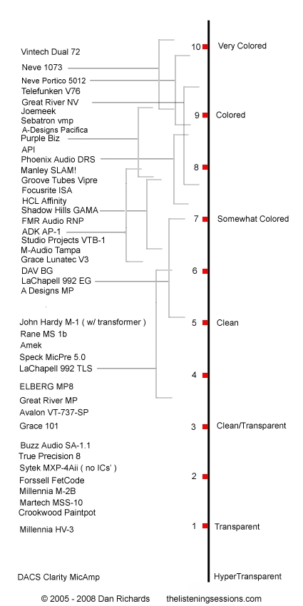

A GAP Pre73, Warm Audio WA12/TB12, or Focusrite ISA One can give some 'character/coloration' to a vocal going into your interface. The Avalon per the chart below is a 'clean/transparent' preamp.
