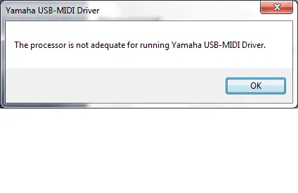

ido1957 9K Gold Member Dec 16, 2012 #1 I need the Windows 7 driver for my DGX305. I need it to use Musicsoft downloader software. If you have a link let me know here or via PM. Thanks

CrowsofFritz Flamingo! Dec 16, 2012 #2 It doesn't need to be a specific driver, just a global one. Yamaha Downloads USB-MIDI Driver
ido1957 9K Gold Member Dec 16, 2012 #3 Yeah I tried that one already.... Attachments Untitled 2.webp 5.2 KB · Views: 716
ido1957 9K Gold Member Jan 7, 2013 #5 Fixed - I was instaling the 32 Bit Driver. I tried the 64 Bit driver and it worked. I was using 32 Bit as the app was 2004 and I wrongly assumed 32 Bit was necessary.
