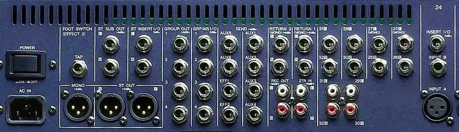

Here is an image of the outputs section of the back panel

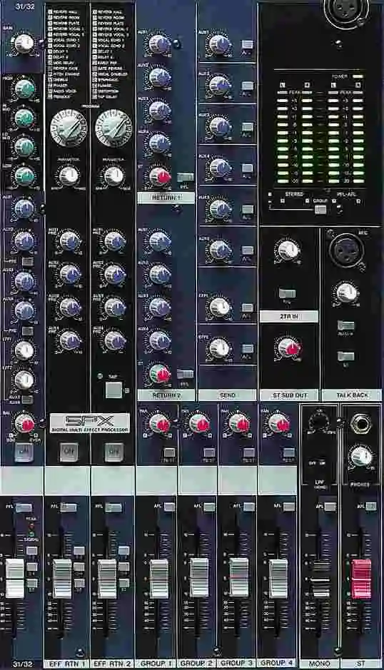

And here is an image of the output controls on the front panel
