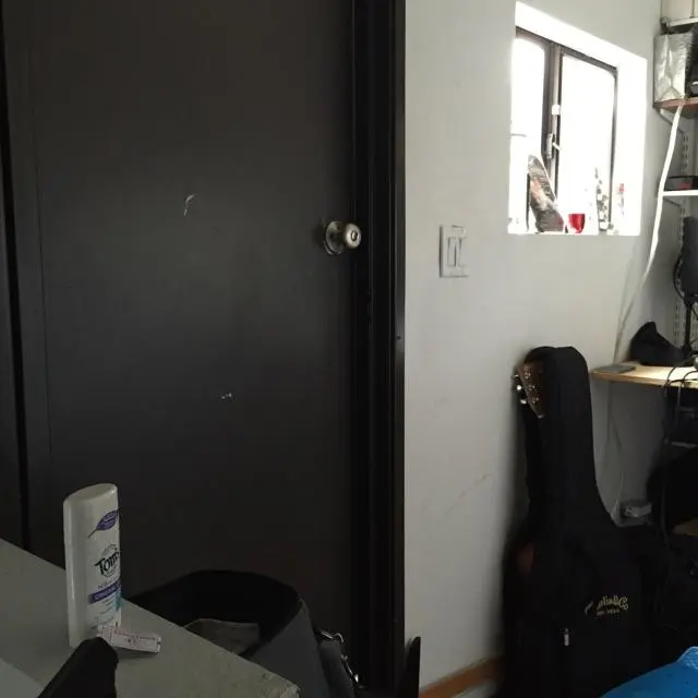

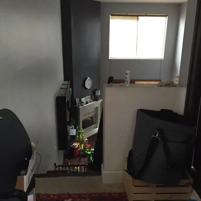

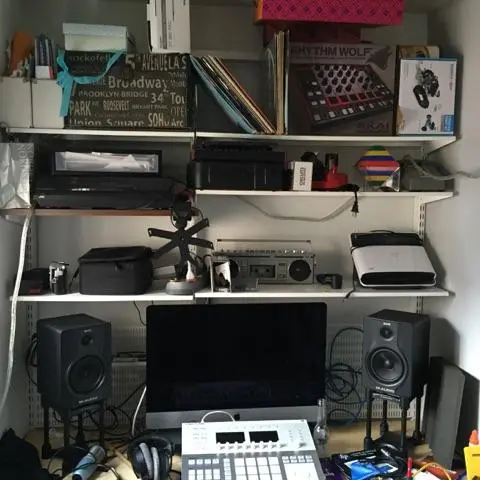

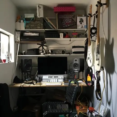

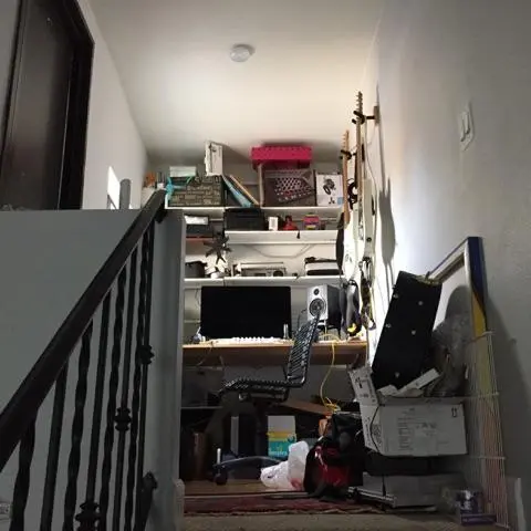

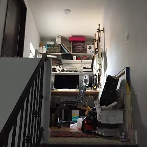

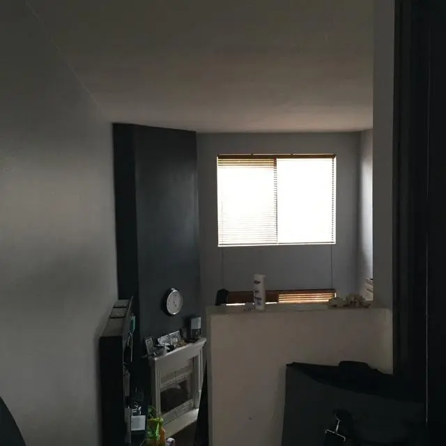

So I have this staircase landing in my condo that I want to turn into a studio. The space is 10x5 and there isnt much room for anything besides the complete essentials for a solid studio. I have attached some pictures to help get the ideas. The way I would ideally want it to be set-up is with the computer and studio equipment at the back (like where it is in the picture, then have a pony wall between that are and than build another area from the pony wall to the stair case where the booth will be and sound treat all areas around the booth and computer section. In the pictures you'll be able to see that to the left od the staircase, once youre on the landing there is a door to the left that goes to an outdoor patio. Im not if that is exactly a benefit or a detriment yet.
I also would ideally like to have the whole area sound proofed or sound treated as possible so that I can contain all my noise to that area.
I would really appreciate any help possible or input as to how I should go about this, what materials to use, and if this is even possible. I think that this would be a really cool to get soem recording done if it is done right. PLease let me know and thank you in advance

5x10 is too small in my opinion. Not good dimensions either. Pick another room in your condo.

yes unfortunatley it's just too small, although the huge room down the stairs might help the sound and allow the music to breathe... but it's going to leak into that room even with soundproofing, there's not much you can do about that. I would start with deadening the side walls and ceiling as much as you can with rockwool panels in wooden frames + cotton, you could try making bass traps but you will end up in a ridiculously tiny space especially with floor to ceiling 2x4 traps.
Find another space. 'Essentials' in that space? Adding bass traps (4" thick minimum) in corners, behind you, in front of you, ceiling cloud, is just not going to work. And forget making it 'sound proof'. Forget making any room in your place 'sound proof'.

Try it, but you'll be disappointed. Soundproofing takes mass and isolation - the sound will conduct thorugh the walls
For the amount you gain it'll be really labour intensive - needs must but I don't think it's a great solution.
The space is really too small for any serious acoustic treatment/proofing (you want to be able to fit a computer chair in there, right?)
It's one of the few situations where I'd probably say 'get some decent headphones' rather than putting lots of hours into treatment/proofing.
For what it's worth, and I know the last post was a week ago, but I went through this with a small room(roughly 8'x8'x6'high). After the proper treatment, and after moving everything back into the room, I could barely breathe in that space, and was always bumping into things, knocking things down, etc. I damaged a couple of cherished instruments in the process. I ripped all the treatment out and trashed it. Now I mix in headphones. Not anywhere near ideal, but it's what I have.
