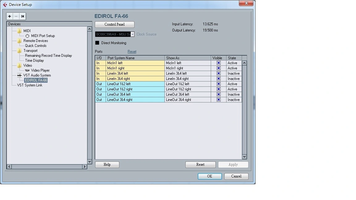

I have changed the main Settings in Cubase:
VST Audio System is set to FA-66.
I have included a print-screen on some parameters that I don't really understand.
I hope the attachment works.

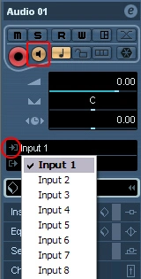

Light up (turn on) the speaker icon on the channel. Also make sure you have right input connected to this channel.
I think that is also correct. I can now get sound from Guitar Rig, but still nothing out of Cubase.

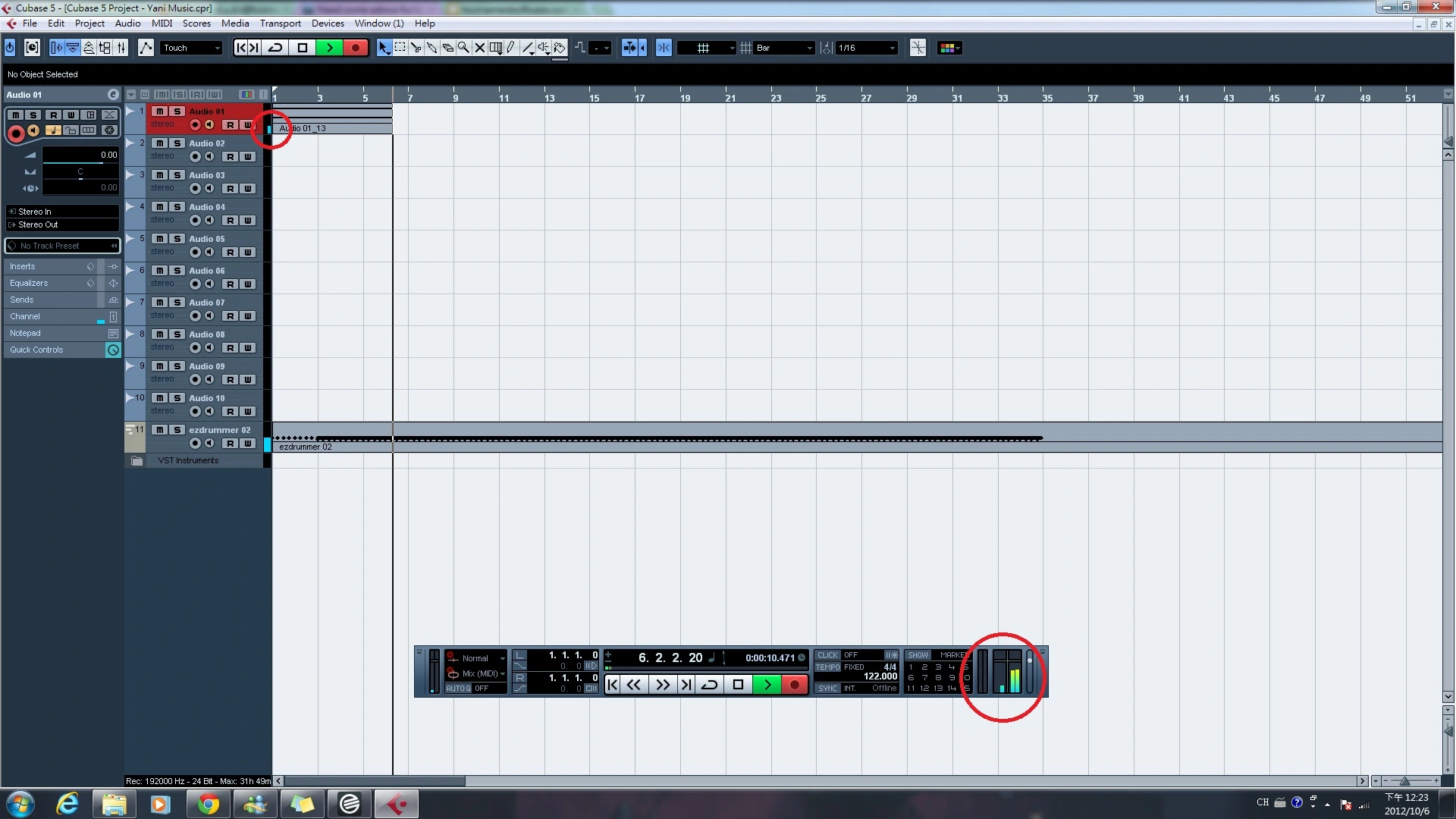

When I push record I can see the activity in both Stereo In and Out, MIDI drums play perfectly but even though I hear the sound from my guitar and I see that there is activity in Stereo In nothing gets recorded.
This is how it looks when I record
Only R is showing activity, I guess that's because Edirol FA-66 has Input 1/L and Input 2/R and I'm using Input 2/R.

First of all, I see that you are trying to record a stereo track - guitar is a mono source. If you can't select mono inputs press F4 (Devices->VST connections) and under inputs tab set the inputs.
And no, you don't have to open any other software.
