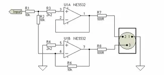

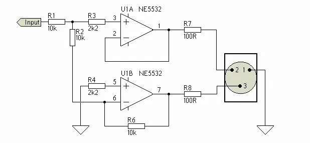

Most solid state Amps use a dual inverted output to create a Ballanced Signal (Non phaze inverted wouldn"t really be Ballanced, Or would it??) useing a Dual Opamp like the TL072 or NE5532...so to create a ballanced output you really don"t need many more Parts than an Unballanced output if useing an Opamp...You can create a Ballanced Line driver from 7 Resistors and One opamp and only take up a PCB space of about one Square inch useing a Circuit like this...
