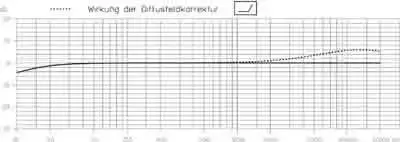

What are the differences between nearfield and diffusefield omnis?
A high freq rise (relative.) Which is which? Rise on the diffused field?
Technically it's "free-field" and diffuse-field. Diffuse-field has signal arrivals from random (all) directions, free-field is a theoretical reflection-free environment (outside or an anechoic chamber). As the room gets large and you get relatively closer to source vs. size of room, then you approximate a free field. That is why you might think of it as "near-field"; because you'd probably want to select a free-field omni for close-micing.
The difference is diffuse-field omnis are designed to be flat off-axis, but they will have a rising high frequency response on-axis (again dependent upon diaphragm size, but let's use the same >10kHz figure). Free-field omnis are flat on-axis, but will have a decreasing high frequency response off-axis (in theory you don't care because there are no off-axis signals).
The amount of difference between on- and off-axis high frequency response is mainly dependent on diaphragm size; in theory a point-sized capsule will exhibit no difference. As capsule size grows, the difference gets larger. Some omnis are designed with accessories that can accent the on-axis response (and decrease the off-axis response), like the DPA APE (acoustic pressure equalizer) balls. This effect is frequency-dependent according to the size of the device; at the large extreme you get a boundary mic.
Normally you would select diffuse-field for applications like recording an ensemble and free-field for close micing, but truthfully if you have a HF shelving EQ (like on practically every mixer) you can convert from one to the other.

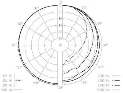

Can omnis be used in XY configuration?
If you want - but they will act like a single mic. at low frequencies and give you a little stereo spread at high frequencies. But this depends on what microphones you choose - a normal SDC omni acts like this (see polar-pattern below).

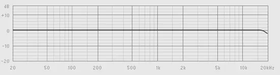

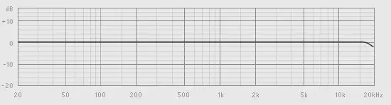

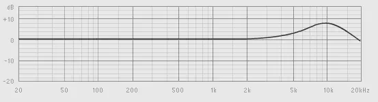

What are the differences between nearfield and diffuse field omnis?
A nearfield omni will have a flat frequency response, a diffuse field omni will have a treble boost to compensate for the loss of high frequencies in the diffuse field.
See below (top is nearfield omni, bottom is diffuse field omni):-

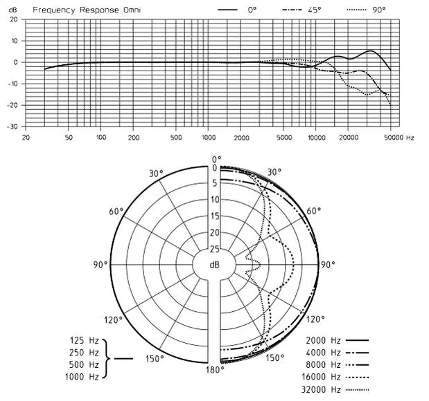

Since it seems that the OPs original questions have been answered, I'd like to pose a related one of my own: Do dual-diagrahm omnis have the same "neutral" off axis response as single diaphragm ones? If not, how much do they differ (in general, of course) and what benefits might there be to a dual diaphragm omni, of there are any at all?
It depends on what you mean by a "dual-diaphragm omni"?
If you mean making an omni by back-to-back cardioids as in a switchable-pattern mic. The answer is no as the single diaphragm one is much better in both frequency response and polar-pattern.
Sennheiser MKH 20:-
Sennheiser MKH 800 in omni:-
Please note that the MKH 20 frequency response is only drawn to 20kHz - the MKH 800 response is drawn to 50kHz - so for a meaningful comparison you should only use the 800 response below 20kHz.
Please also bare in mind that the MKH 800 is more than double the price of the MKH 20 - you can see clearly that the frequency response is not so smooth and the off-axis response is very different. And the MKH 800 is technically about the best dual-diaphragm mic. on the market when it comes to frequency response and polar-pattern, others would be a lot worse in this respect.
