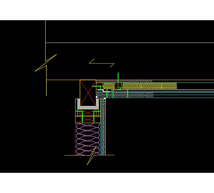

Not only does mass contribute to TL, but the depth of airgap will too. If high SPL is what you are trying to isolate, I would consider DOUBLE WALLS instead of staggered stud, with as much airgap depth as you can afford to loose in the rooms. And then there is the matter of the connections between the wall framing and the existing floor joists above. Direct fastening will negate any isolation attempt at the ceiling. Wall framing needs to be de-coupled by use of "sway" brackets with resiliant material between the bracket and the wall. Here is a design one member here used. See the drawing below. This was a SINGLE wall between studio and sound lock. Double walls or staggered stud would be similar. This one happened to have a beam in line with the wall, so the bracket design was fairly easy and straightforward.
