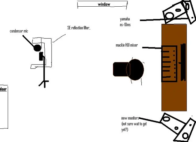

my question is will it be alright to record rap vocals and miox & master tracks in the same room as i will be gettting the se reflextion filter?
and where should i p[osition the acoustic foam i have already got?
i have done a paint picture as a rough guide for you
help appreciated, thanx

heres the pic 4 ya

Awesome drawing. :D
Ever tried using SketchUp?

Place the foam in a fire. That'll take care of that. Keep away from the fumes. Then go get some OC 703 and wood and build some real treatment.
Next, nix the idea of getting the Behringer monitors. Get something else.
haha thought u might like the drawing
anyway how come ditch the acoustic foam? i thought that was the proper way to go like most recording studios?

People here don't like acoustic foam, they say that it has no effect and it's popularity is down to marketing hype. I know a couple of studios that have got good results from using foam diffusers and Bass traps. All in all it isn't the best thing in the world and what people will suggest to you about making your own will grant you more efficiant results. . . but foam won't hurt.
The reflexion filter will be fine being in the same room, I have one and it helps to keep the sound nice and sharp, although it isn't always good to use.

My mentioning of burning the foam was more of a joke but, really, once you get proper acoustic treatment (which you need), the foam will become relatively pointless. All it does is tame high frequencies. And the barn burner of a small room (bedroom) is bass. The foam will do NOTHING for bass. So when you get some proper bass trapping going on and some treatment at your first reflection points and above your mix position, your foam will be of little more use than as decoration.
And the reflextion filter or whatever it's called is fine in the same room. Preferred, even, in your scenario.

Anyway...OP, invest in decently treating your room and it'll pay off in the long term. Forget the Behringer monitors. You have some decent ones already and, in my opinion, the Behringer monitors would be a downgrade. You can respectably treat your room a bit for not a lot of coin.

You've already asked the question 10 different ways and got about 10 different answers saying the same thing. Foam is not good for acoustic treatment. Period. As has been mentioned already, all it does is kill your highs. 99% of the problem in 99% of rooms is bass, especially in bed rooms. So, by killing your highs with foam, you're now making bass 100% of your problem. I know it's not what you want to hear and you'll probably still say that you think it will work...but it won't.
Throw it out. Or wait until you get proper bass traps and treatment and you can probably put a few pieces of foam here and there for whatever reason you want to convince your self you need it.

Well, it's open cell so it's at least legit. BUT, this line is...well, bullshit. "The tiles are convoluted or 'egg box' profile which offers a greater surface area over flat tiles which enables them to ‘catch’ sound waves more easily and effectively." I think what they're TRYING to say there is that it's kind of diffusive. But really, it's not.
Anyway, Rami is right. Foam is only going to absorb high end. And your room is going to need LOTS of bass trapping.
