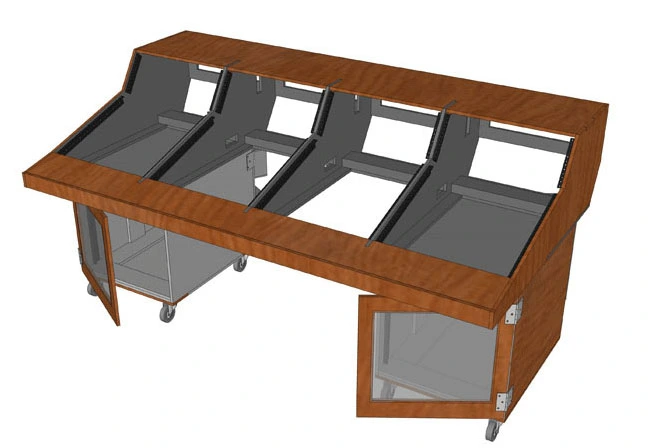

this is a design for a desk i recently built. basically designed on 4 19" rack widths and the desire to angle the mixers. for a wider mix board, you'd take out the middle divider. not sure what the dimensions on your board are but most seem to follow multiples of 19" racks... you could then either rack it or add something to lay it flat. the other considerations in this design were have 4U of racks across the top for patch bays and effects, and 2 iso-cabinets below for recorders and PC. on wheels so moving is easy... seems to be similar to the x-studio design but is entirely my own.
its built using 15/32" finished plywood and has interlocking parts to increase rigidity and keep weight down. cost me about $500 in parts total (lowes, local hardware, and Amazon) and took me about 30 hours to cut and assemble (glue and screw) and finish (I used a gray stain but you could use what ever works).
I have the design in Sketchup (free from sketchup.google.com) and you can pull it apart to get the dimensions (about 79"W 36"D 16"H (desk) 21"W 24"D 23"H (cabinet) - puts the lip of the desk around 26"H). make a copy of each part onto a 4x8 sheet of plywood.
I can't attach the sketchup file - too large for this site but you can find a copy on the www.johnlsayers.com - search for console desk in the studio design forum, or PM me.

i did a quick check - the 24 channel Ghost mixer is 41" wide so you'd have to expand the mid-section on my desk by 4" to leave 2 19" racks on each side.

Thanx Gollfo that sketch looks really nice i would love to get something like that.
You could make a really nice one for less then $500. A simple one for $100. Plan on spending around $2000 for a new manufactured desk.
