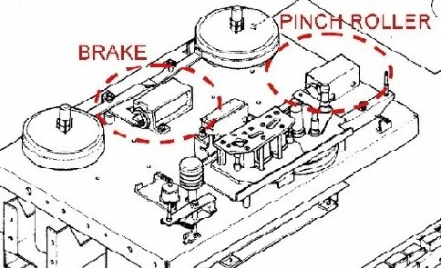

I'm not sure if the 38 has 2 or 3 solenoids: one for the pinch roller, one for the brakes, and maybe one for the lifters. I think the location of brake and pinch roller solenoids are as pictured below. Keep in mind the parts shown in the diagram are from a 32 with the skin off, but it should be pretty similar. Hope this doesn't confuse things further. I imagine you can get to both the brake and pinch roller solenoids just by having the upper dress panel removed, the same one you pulled to replace the capstan belt.

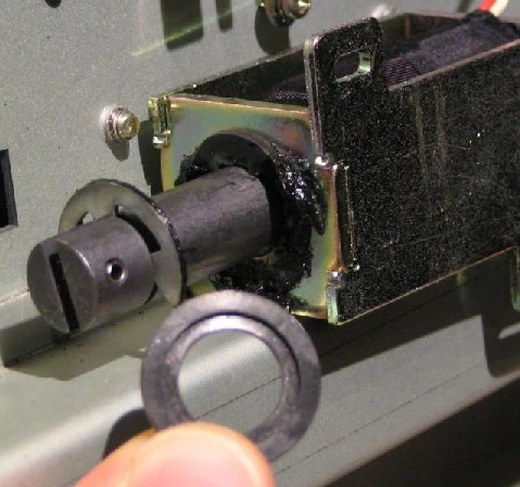

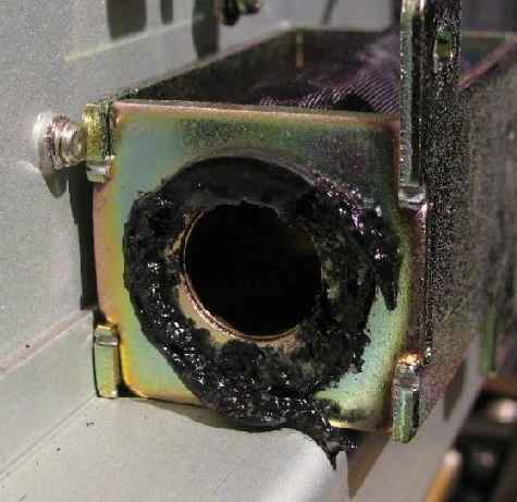

Here are the pics of the solenoid with the gooey cushion
The first one shows the solenoid with the plunger, and I'm also holding a new cushion in the foreground.
The second picture is just a more clear picture of the dessimated cushion without the plunger blocking the view.
Yuck!

AK, yeah, isn't that gross?! :eek:
Phew! Thank goodness it comes off with iso alcohol.
My 58 was the same way. Its wierd because it was only the solenoid cushions and not any other rubber, and in my 48 its only 2 out of the 3 cushions. All supplier dependant. :rolleyes:
Man, that is pretty gooey indeed, Cory. :eek::D
On my 34 TASCAM they were close to that but not as bad. Still I pulled them off but never replaced 'em, as they're really not essential for proper operation. All that the cushions do is make functions more quiet and aid mechanical adjustments, where the solenoids are involved. So I guess they are pretty important in that way.;)
