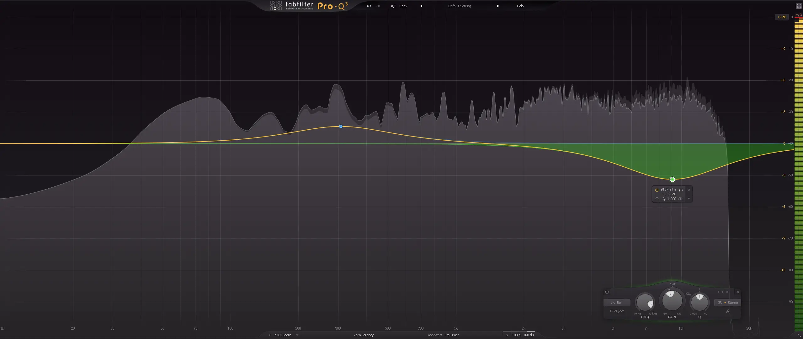

Hiya, cool song.
For me the mix isn't bad but it's pretty bright and I'd be looking to tame it around 9K.
Just as an example, having pulled down 9K by around 3.5dB:
View attachment A.mp3
P.S. I don't think you should just put an EQ on your master bus and tame it that way, it's just an example, fix it in the mix!
P.P.S. You can ignore that boost around 300Hz, it won't help in this case I just couldn't help myself...

Do you think the problem is more the vocals, beat, or both?

This is weird to me too, I'm hearing an obviously fatiguing over bright mix with a big build up around 9k where others aren't, weird indeed...
I'll listen again when I get the time.
I made some tweaks like you suggested. Is this better? I think it is, but I might need to rest my ears a few days before I attempt to fix the rest of the tracks.
  • Almost Perfect EQ reduction.mp3
