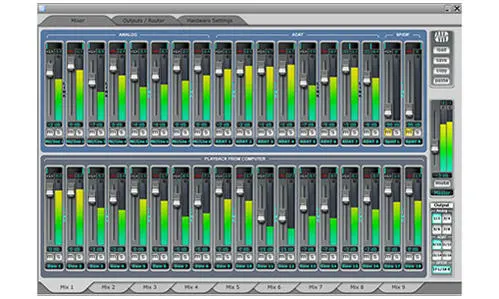

One thing to mention: I believe most audio inetrfaces have software that mimics a mixer, It can be handy because you can save mixes, rename channels, route ins and outs etc.
For example I have the presonus firestudio, you can set up multiple mixes and route them to any outs you want. It's pretty handy. NO EQ though, if that's a deal killer.

I like it! That's what I was talking about. These babes are like little recording studios all by themsleves..
It's a bit over my 400$ though... I think I'm just going to wait and save some more money.
