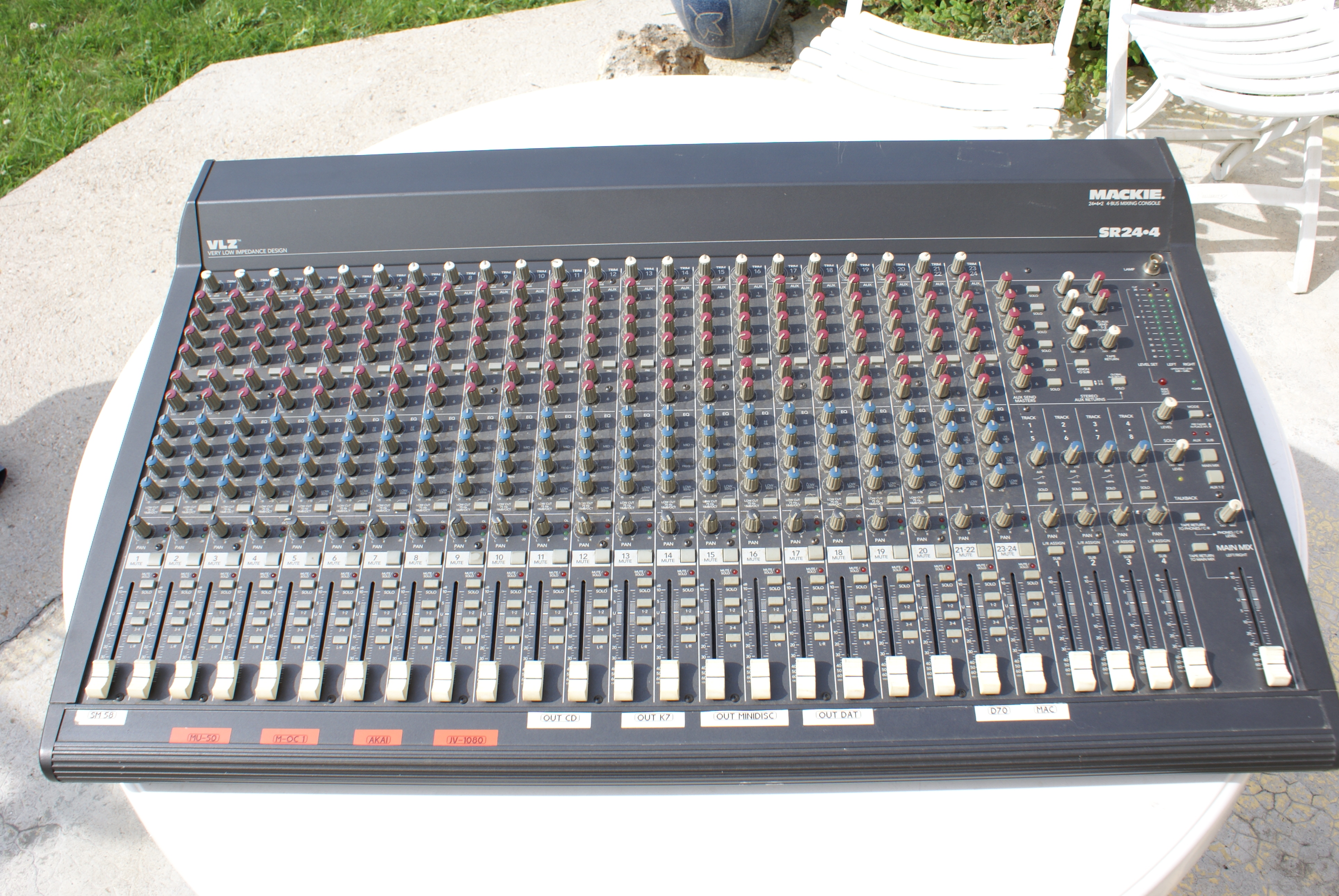

I need some help trying to figure out what would be the best equipment for my particular situation to be able to record sound from a live show. The stage is small and the recording would be for plays. I have all of the gear set up for live sound but want to incorporate recording now. The mixer is the Mackie Sr24. These are pictures I found online of the front of the mixer and back panel. http://medias.audiofanzine.com/images/normal/mackie-sr-24-4-vlz-256886.jpg
http://www.mackie.com/products/sr32-4vlzpro/images/24_4VLZPRORear.jpg
There are 2 passive speakers connected to an amp for the live sound. On stage there are 6 hanging mics and we use 3 wireless mics as well. So my question would be: what would be the best way to record just the sound from the mics that are going into the analog board already?
Probably the easiest and cheapest way of doing this is:
1 Get hold of a Behringer UCA202 interface.
2 Down load Audacity (free) or Reaper (not free, but still cheap and more powerful) onto a laptop.
3 Connect the recording outputs of the mixing desk to the UCA202's inputs.
4 Connect the UCA202 to the laptop via USB.
5 Load up Audacity (or whatever) and hit record.
