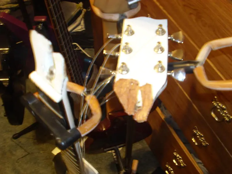

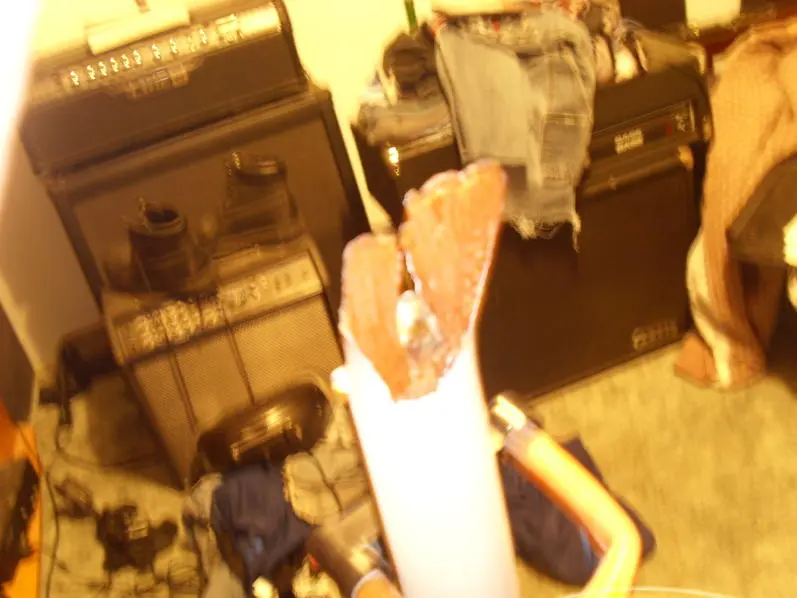

So a friend gave me an Epi LP set neck with a wasted headstock and broken neck.
It was bad. The headstock itself was broken in half with the other half missing. So I made and shaped the other half and set it with 2 roll pins and some Tite Bond glue.
Where the top of the truss rod is...is where the neck was broke. I used the Tite bond again and it held for about a year. When my daughter knocked it over, it snapped in the same place.

As you say the pics are not the best.
The main problem you have now is that that break is now full of titebond. Titebond isn't easy to clean off and you need good wood on wood contact for most glues to bond well.
From what I can see you'd need to get a splice of new wood in there. Either routed out channels with inserted fillets either side of the truss rod channel or scarfed onto the break by removing the fracture and gluing in a fillet to replace what you remove, possibly both. Another thing I would do if you not bothered about the cosmetic of the finished result would be to strip the face and back of the headstock and veneer them after you've repaired the break. That would add to the strength a little. You have to be careful about the thickness of the finished headstock so the tuners still have enough post to wind the strings on.
If it was me I'd scarf joint a new headstock on and veneer the face and refinish. That's quite a bit of work but not impossible.
