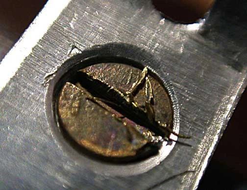

And while I'm posting pics, here's a screw in the 219 before I ever touched it. Looks like Olga was having a bad day on the assembly line. :D

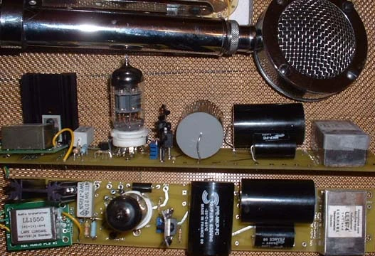

Yes, I also always remove the thinner mesh, and silk thing as well. It improves clarity, and reduces standing waves. However, the pop screen is a must, and no outdoor use (who cares?) Have a look at my coming projects--old astatic lolipop mic is gonna adopt a tube and K87 (above on the pic). Two strips of my new tube pre, I just stuffed tonight. All these on wire mesh, I use for grills:

Let me go to sleep first, then tomorrow, if I have time I will finish PSU and turn it on. Yeah, it is based on Kevin's phono pre without EQ stuff. For now I am gonna fit it into Burgerjack Ultragain (remember, I talked about this deal?). BTW, do you know any way to get rid of its logo. :) Oh well, now I have to find the way to remove it from ECM8000 as well.

<I've really been bitten by the Lomo/lollipop concept. I want to make it easier to swap capsules on and off head amps, plus, I think a largish (3" maybe?) spherical grille would be an ideal acoustical size and shape for the clear/open top end I'm after.>
Michael, the astatic one has exactly that shape. The capsule is removable, and there is a 3 pin connector, which can be subsituted with 3 pin gold plated XLR. I can make a pic later today.

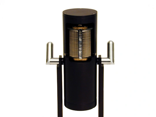

Look at this beauty--Dick Sequerra's ribbon mic. No shielding or screening at all:
