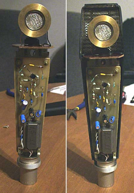

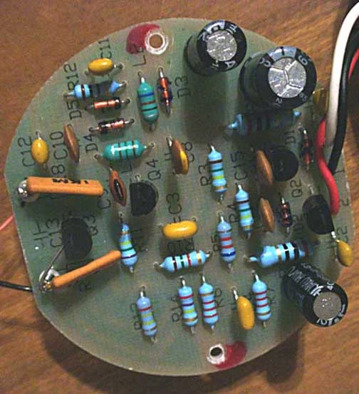

Here's another mic I've got apart. The FET is marked K170 GR 1K - I'm hoping it's a 2SK170 GR. The two orange yellow resistors R8 and R9 are are marked 1KM which I assume is 1 gigohm.

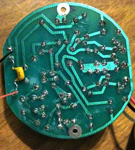

Reverse side.

Considering that the attachment has MXL990 file name, I would guess that it is a Marshall ;)
Attachment: mxl990bsm.jpg
Anyway, I saw them inside :)
Where can you see the filename of an attachment someone posts? What browser do you use? I can't find the attachment name even in the pages source code in Netscape 6 or IE 5.
Yes, the FET’s a 2SK170GR.
From what I can tell, it’s the same circuit as the 603s (on a different board, of course).
For improvements, replace the cap on the bottom with a 820-1000pF COG ceramic, polyester, or polystyrene – try all three and see which you like the most. Replace C3 and C9 with a 0.22uf metalized film (Panasonic “V” series) or polyester. A larger value like 0.33uF might be better if it will fit. A larger cap in these places will pass a little more low-end.
Lastly, I’d try removing C1 and C2. This is just personal preference, though. You may not “hear” a difference, but I just feel like it’s unnecessary clutter. If you start picking up radio stations in Moscow or something, I’d put some 0.01uF ceramic COGs or some type of polys in their place.
Q4, L1 and L2 form part of a DC-DC converter that boost the phantom power voltage to a higher value. This give the mic more headroom and can improve the sound. Other MXLs like the 2003/V93, and 1006/57/63 use this method. I’ve heard that SP does this with their mics too.
(edited to correct info)

Those (C14 and C15) are marked 102 - does that mean 100pf (0.001uf)? C2 is 223 - 0.022uf? C3 224 - 0.22uf?
What does COG mean?
I didn't even notice the inductors in there - they just look like slightly fat resistors. :)
"102" stands for "10" and 2 zeros, thus it is 1000pF or .001uF.
Oops! I screwed those up. Go back and re-read my post since I edited it concerning this and the other caps I said to remove.
What does COG mean?
"COG" (also known as "NPO") is a type of dielectric used in ceramic capacitors that is very stable, much more so then the X7R and Z5U dielectrics used in lesser expensive caps (we're only talking a few cents here, but when using thousands of caps, it adds up). If you look in a Digi-Key or Mouser catalog you'll see them listed as COG, X7R, and Z5U.

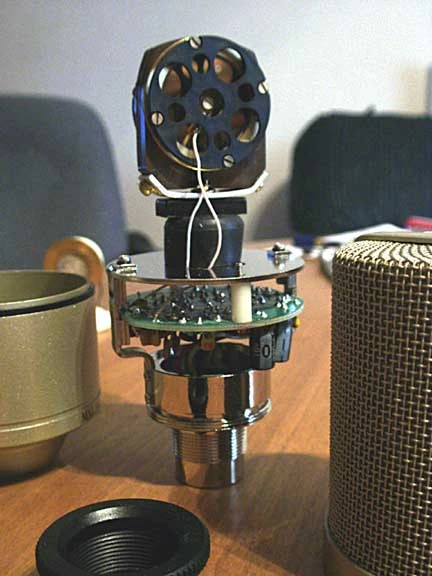

Here's the first of the two chinese-russian bastards. Now to crank her up and see what she sounds like.
The second will be the 990 capsule with the 219 board and housing. That's going to be a tougher fit physically (sort of like the stallion with the donkey).

Crazydoc--this is good approach! Make a chart and give us report. Give a chance to the 319 body as well :)
Doc, that is just too cool! :D

Here, BTW, is little Guan-yin's tall, thin brother Piotr.
