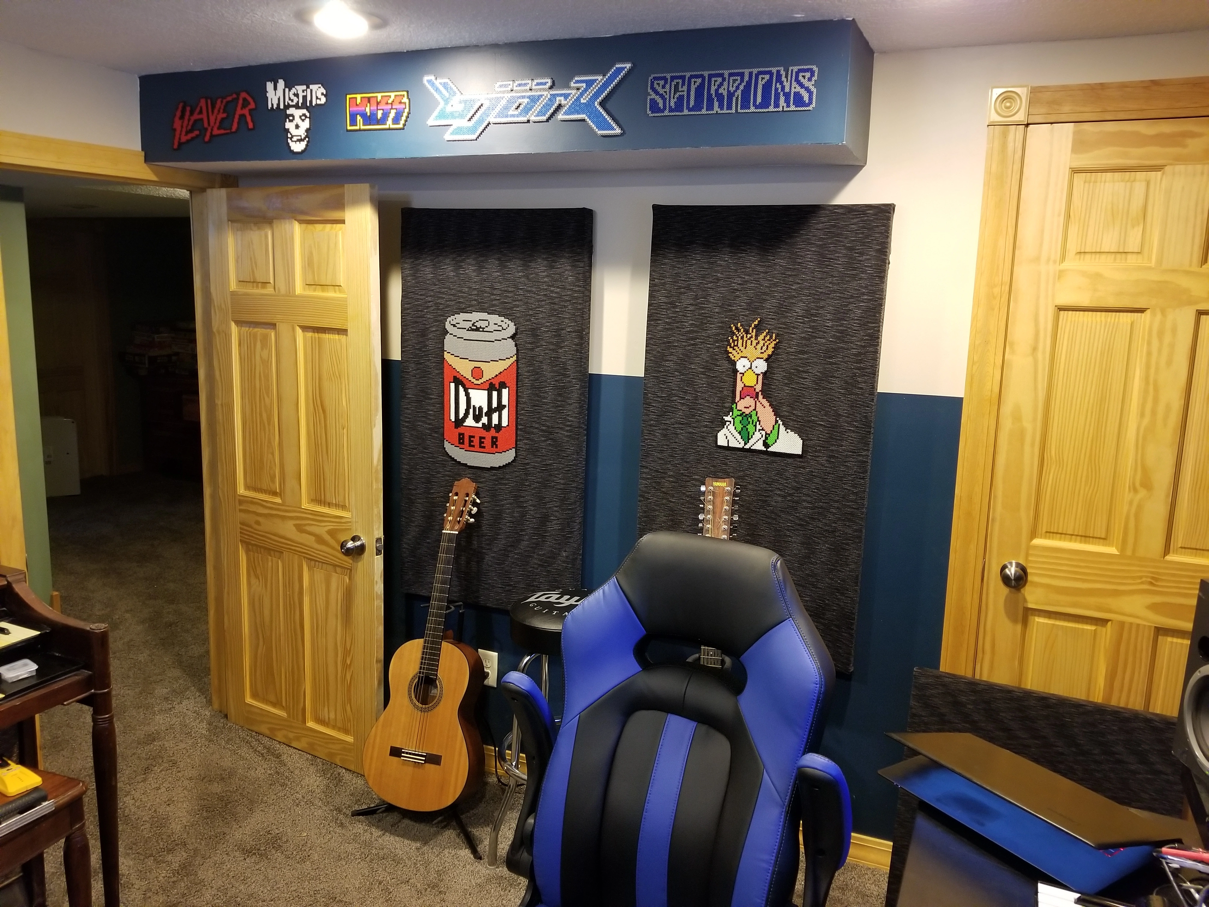

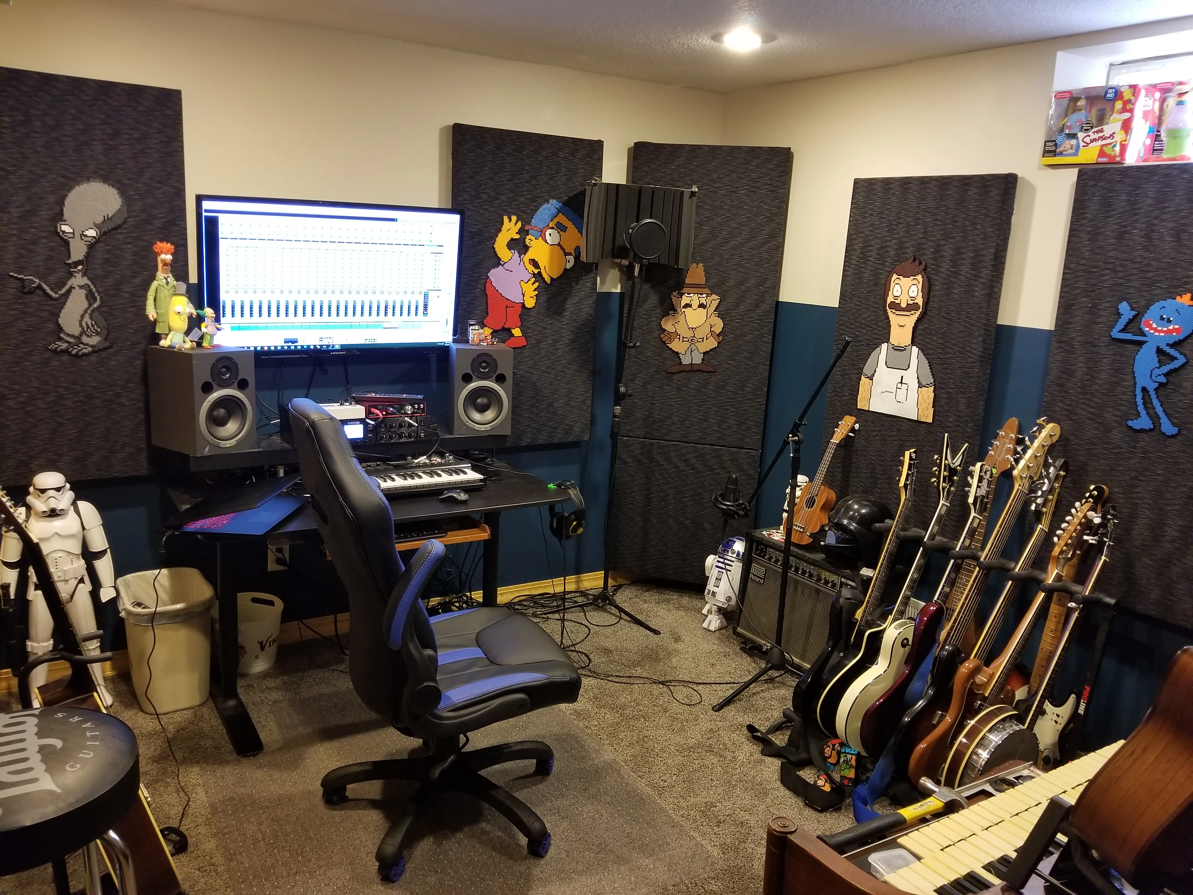

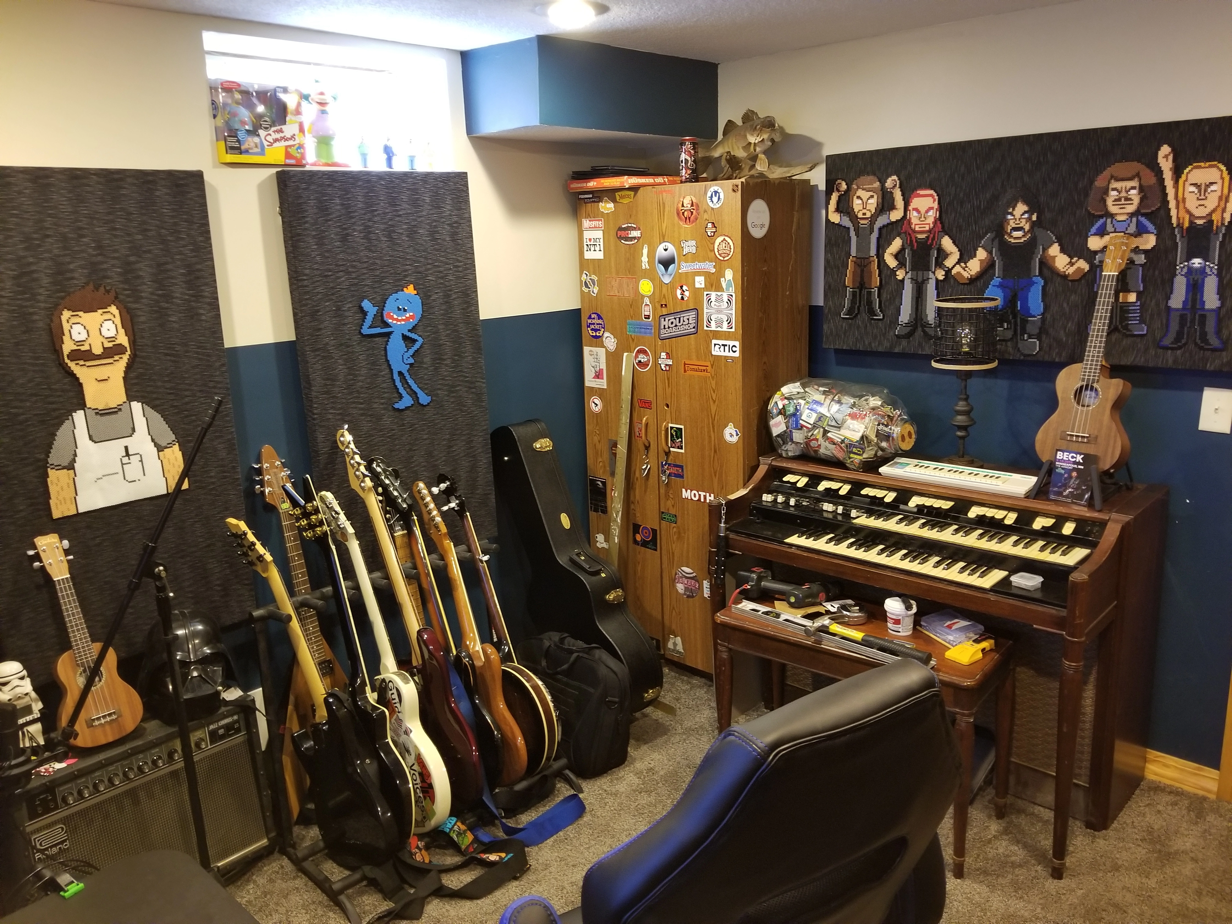

Here's my studio. It's a 10x10 room in my basement. Adding the acoustic treatment to the walls was the best decision I ever made. I primarily record only myself and acoustic instruments, plus vocals. Electric guitar and bass are usually direct and keys are typically done via midi. For my drums I use SD3.
View attachment 103885 View attachment 103884
View attachment 103887 View attachment 103886
I was curious about your panels. the covering too. Can't tell if it's just fabric or maybe something textured?

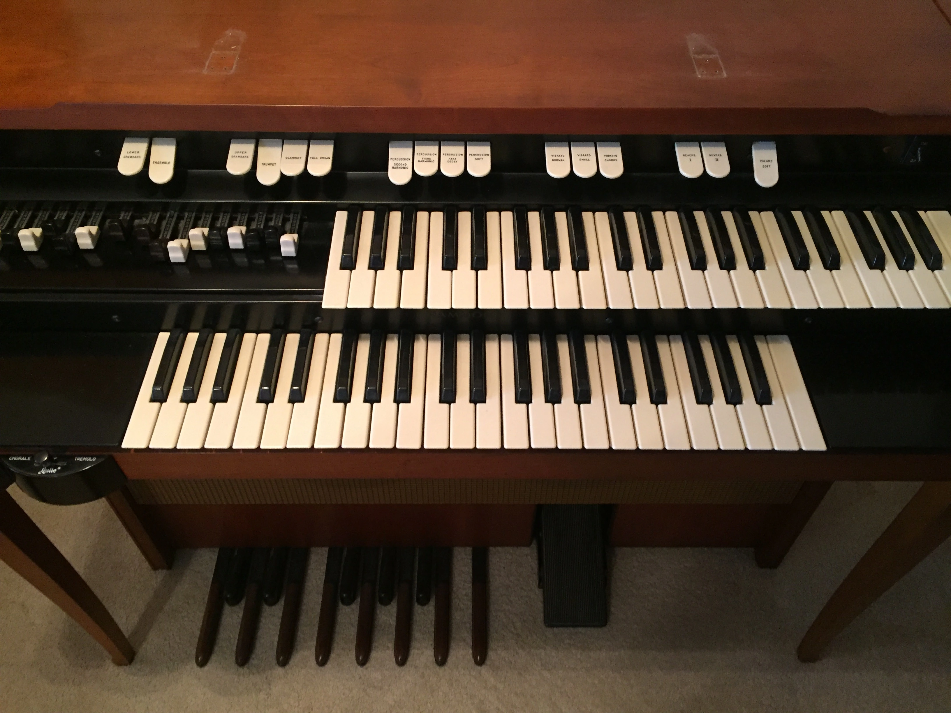

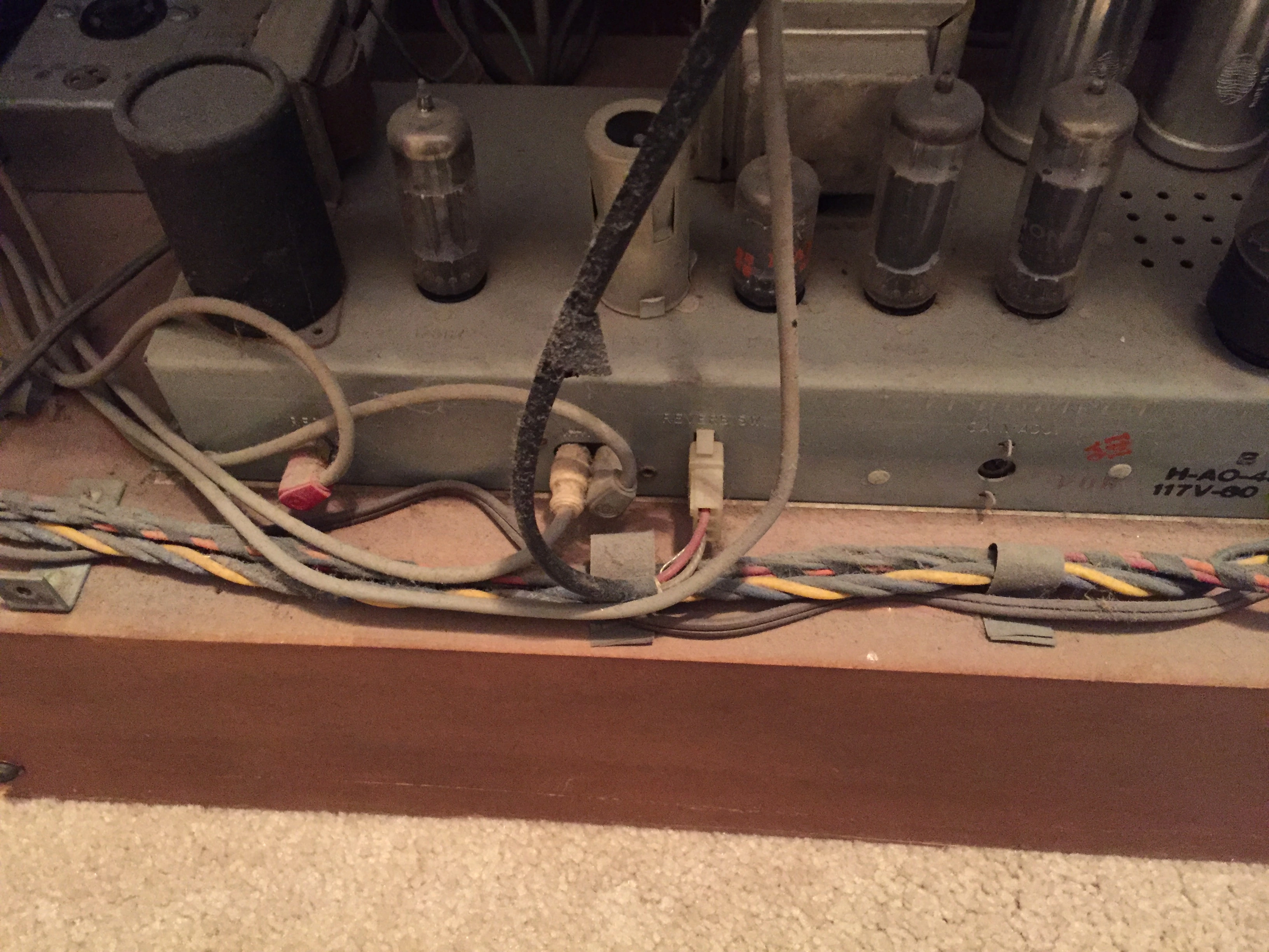

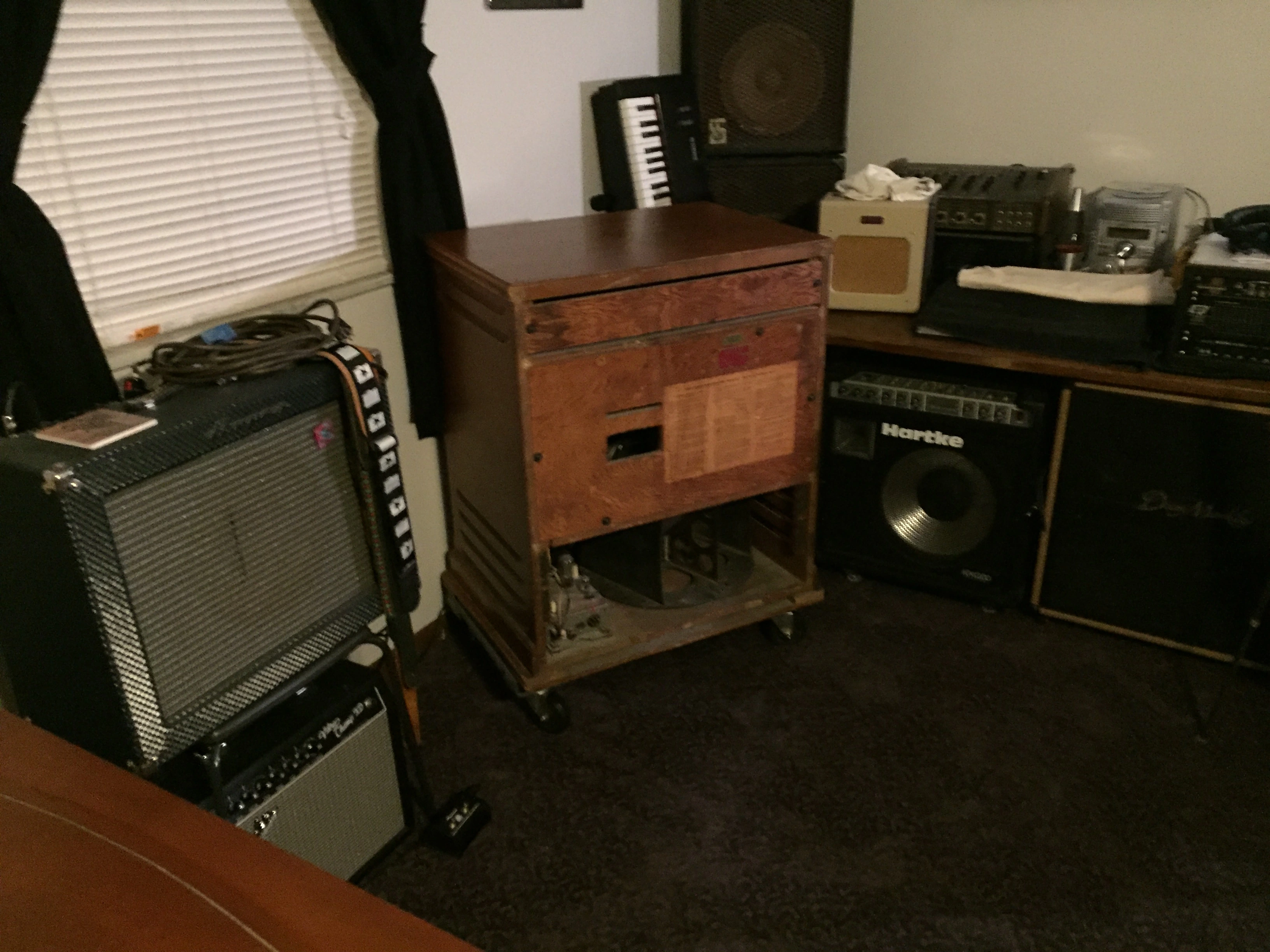

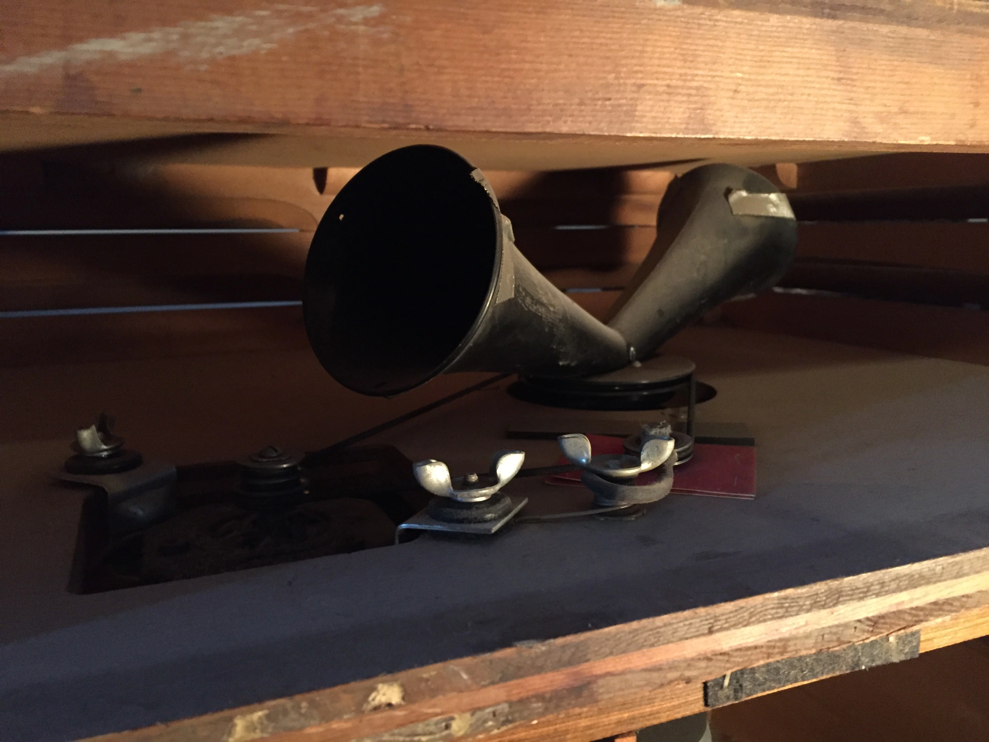

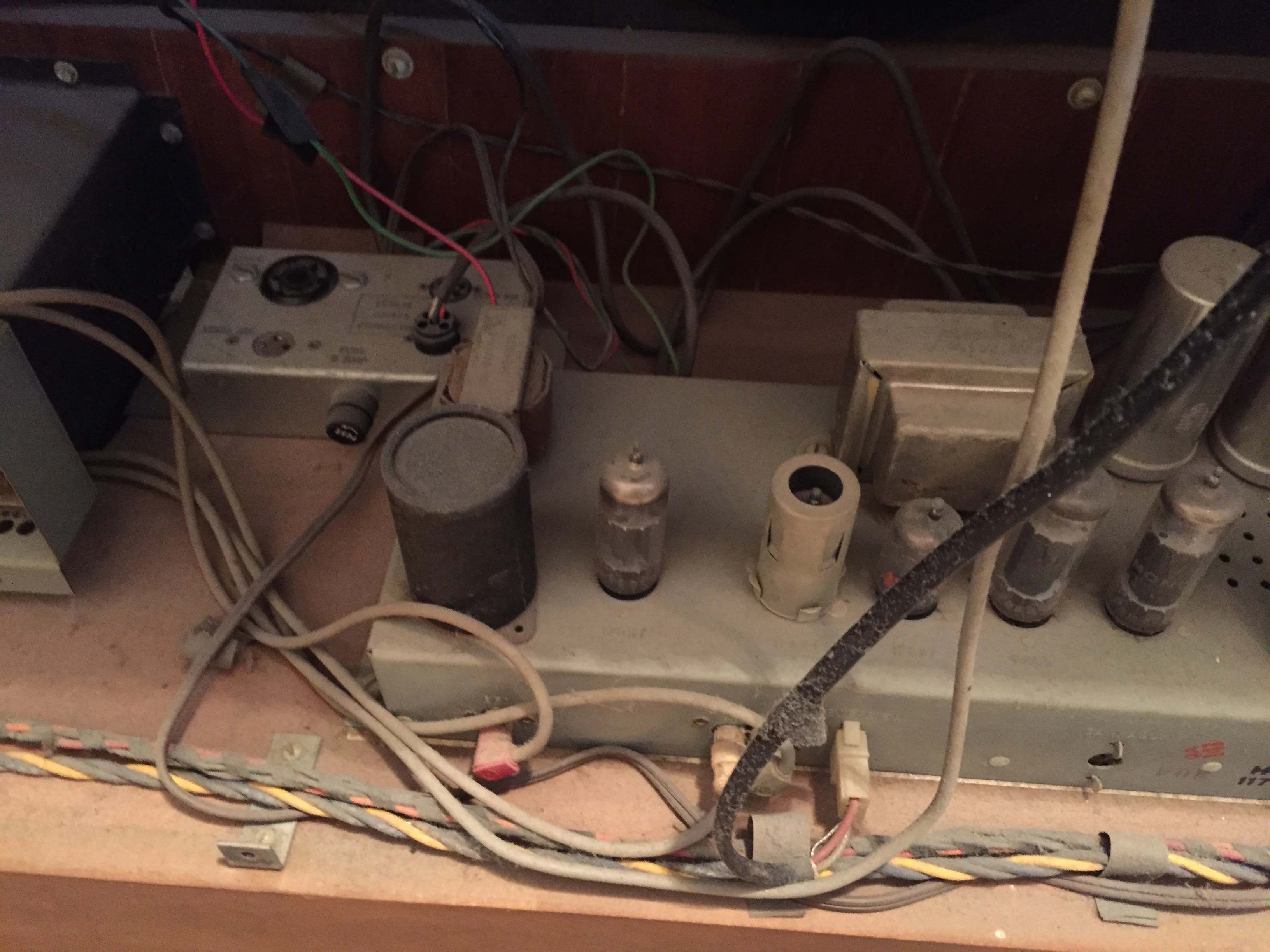

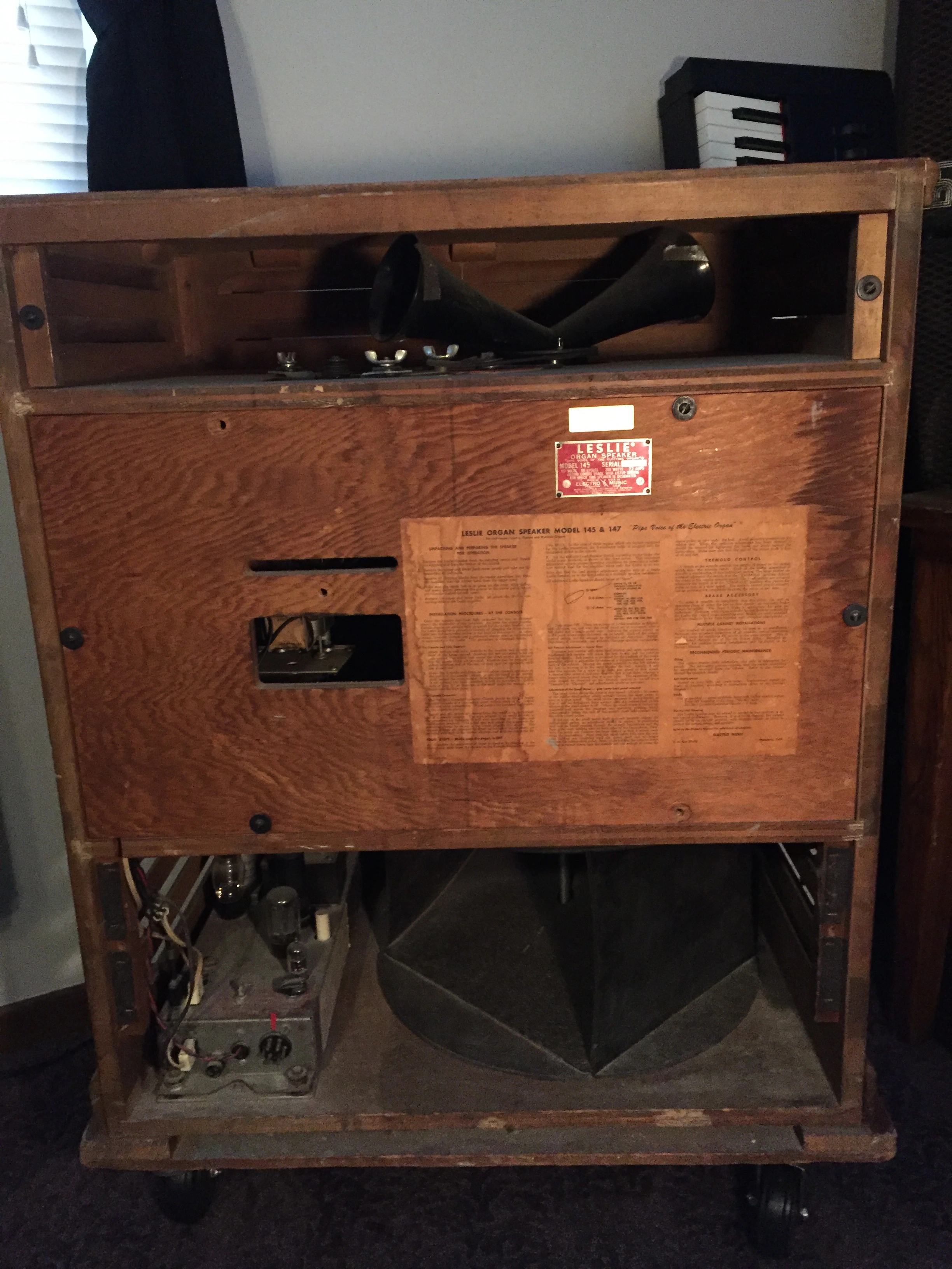

magoo comment:

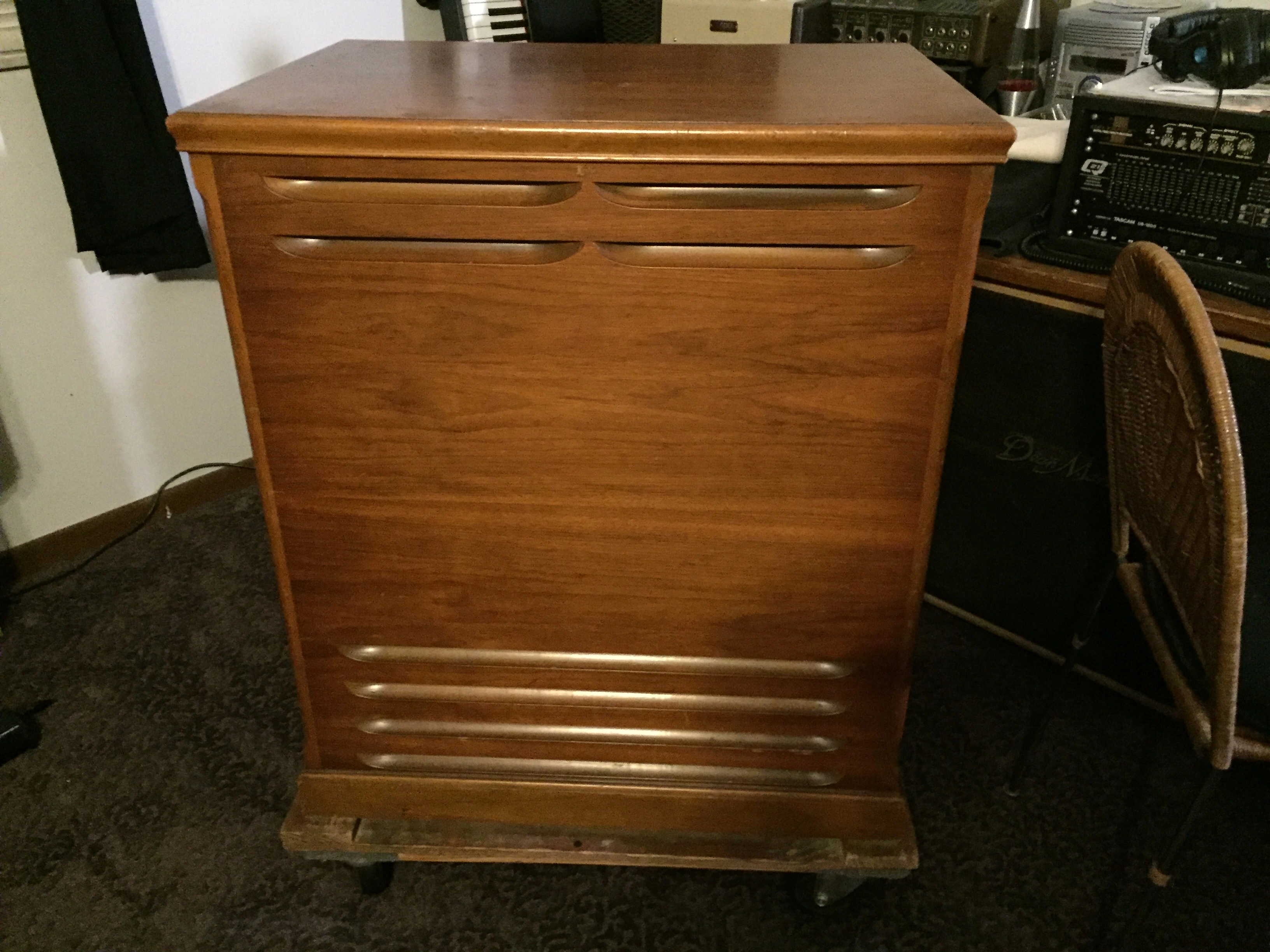

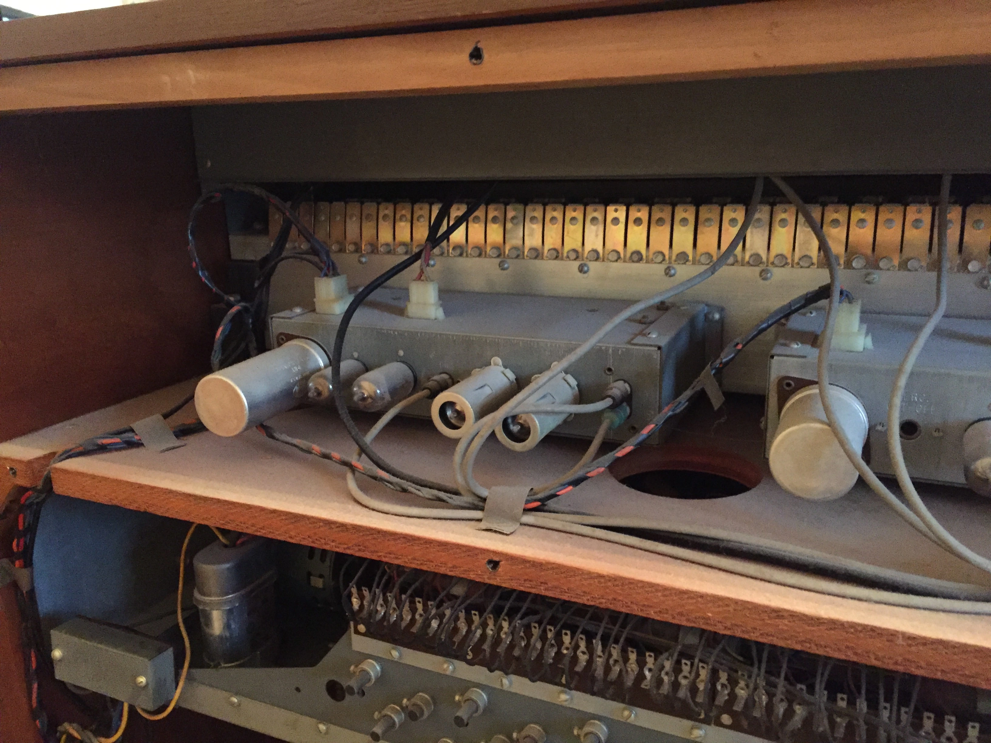

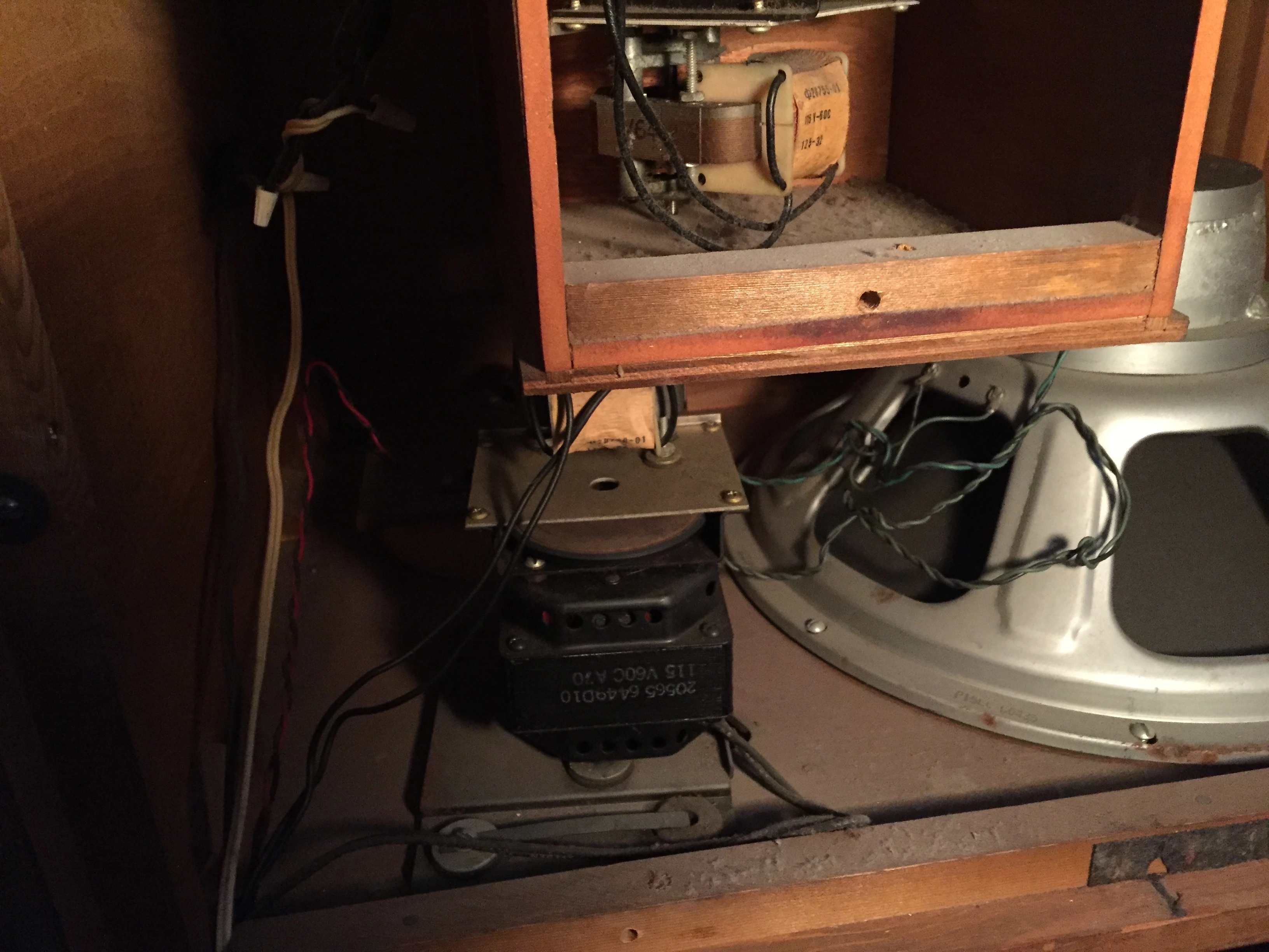

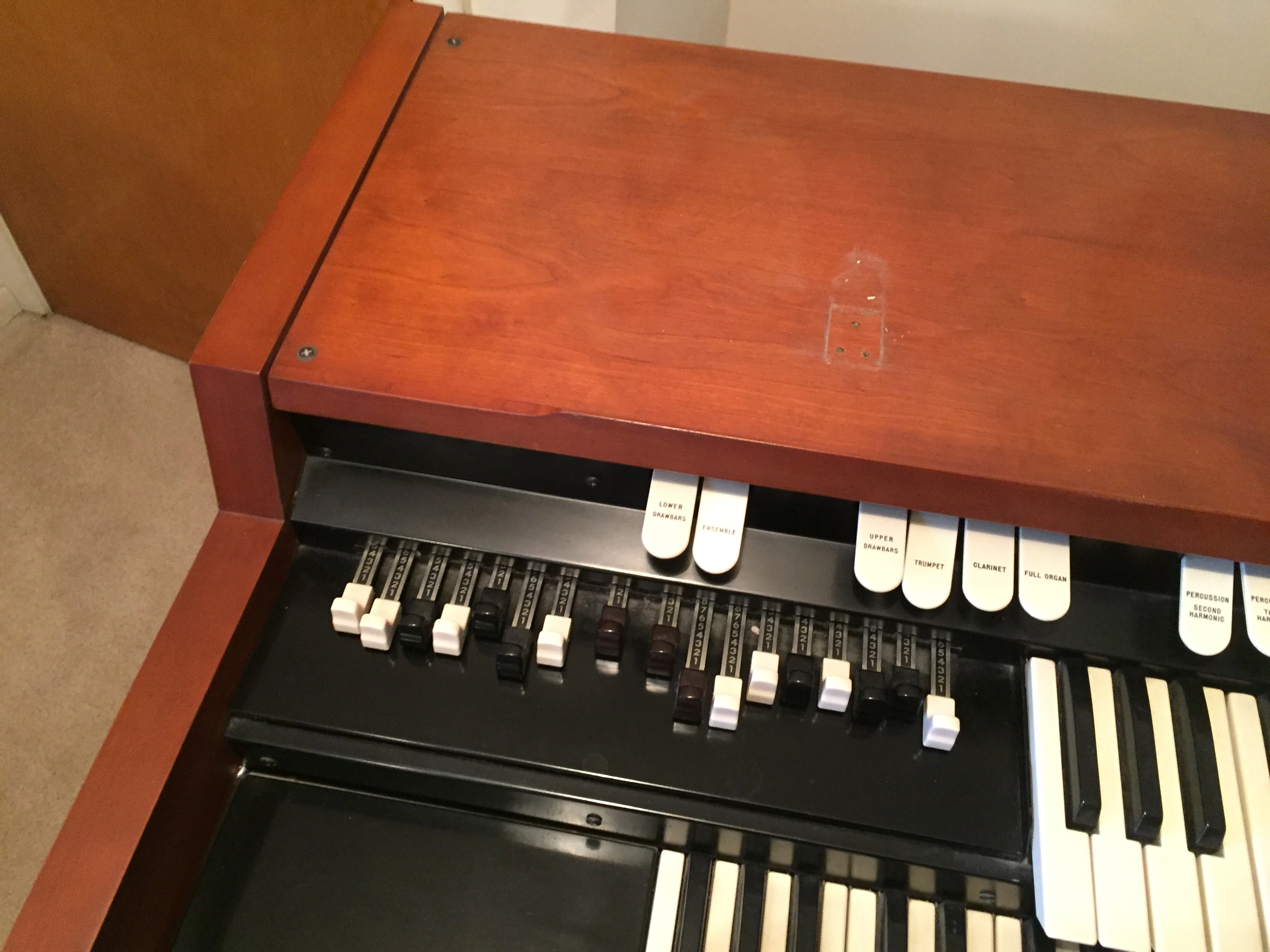

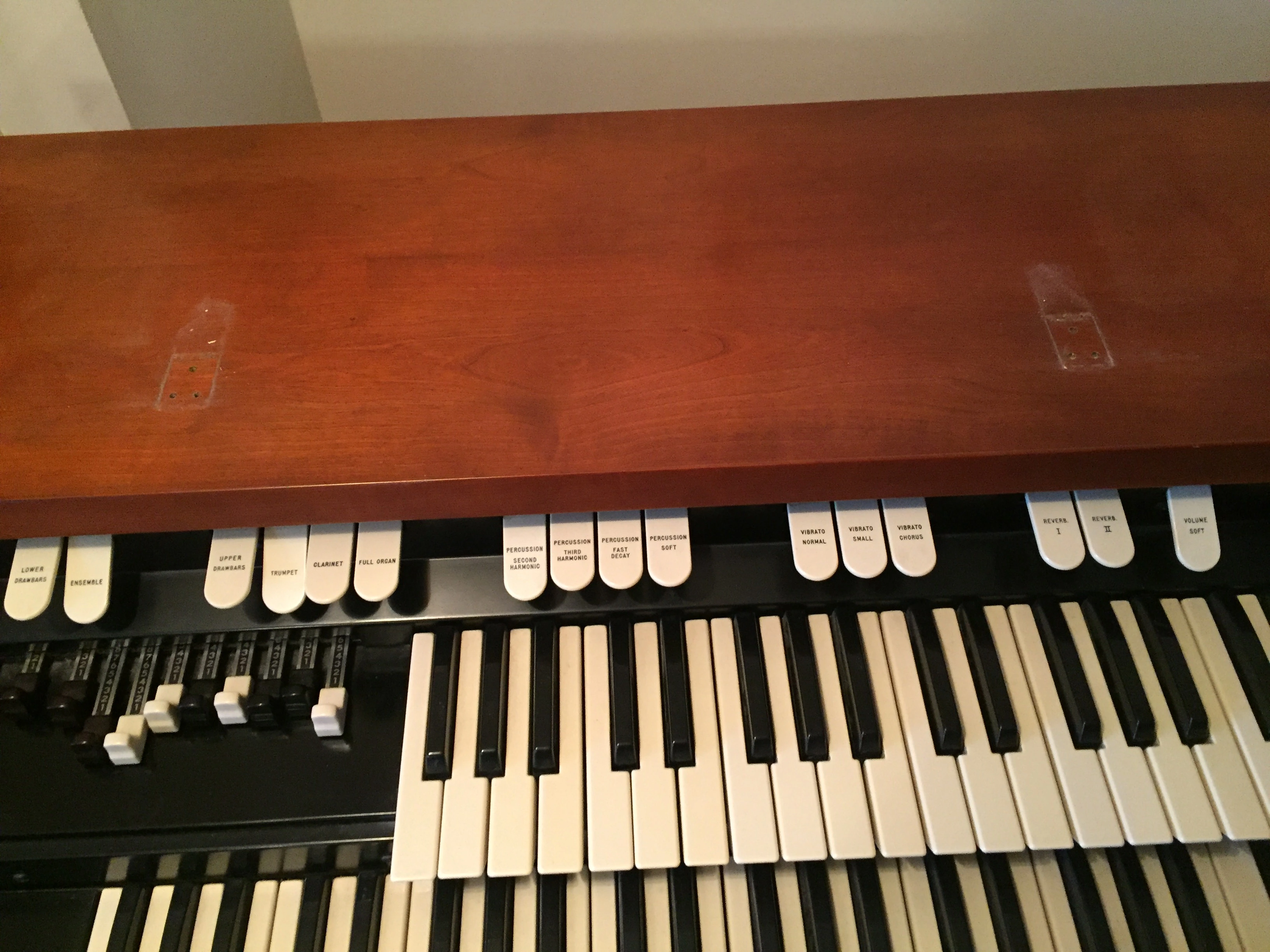

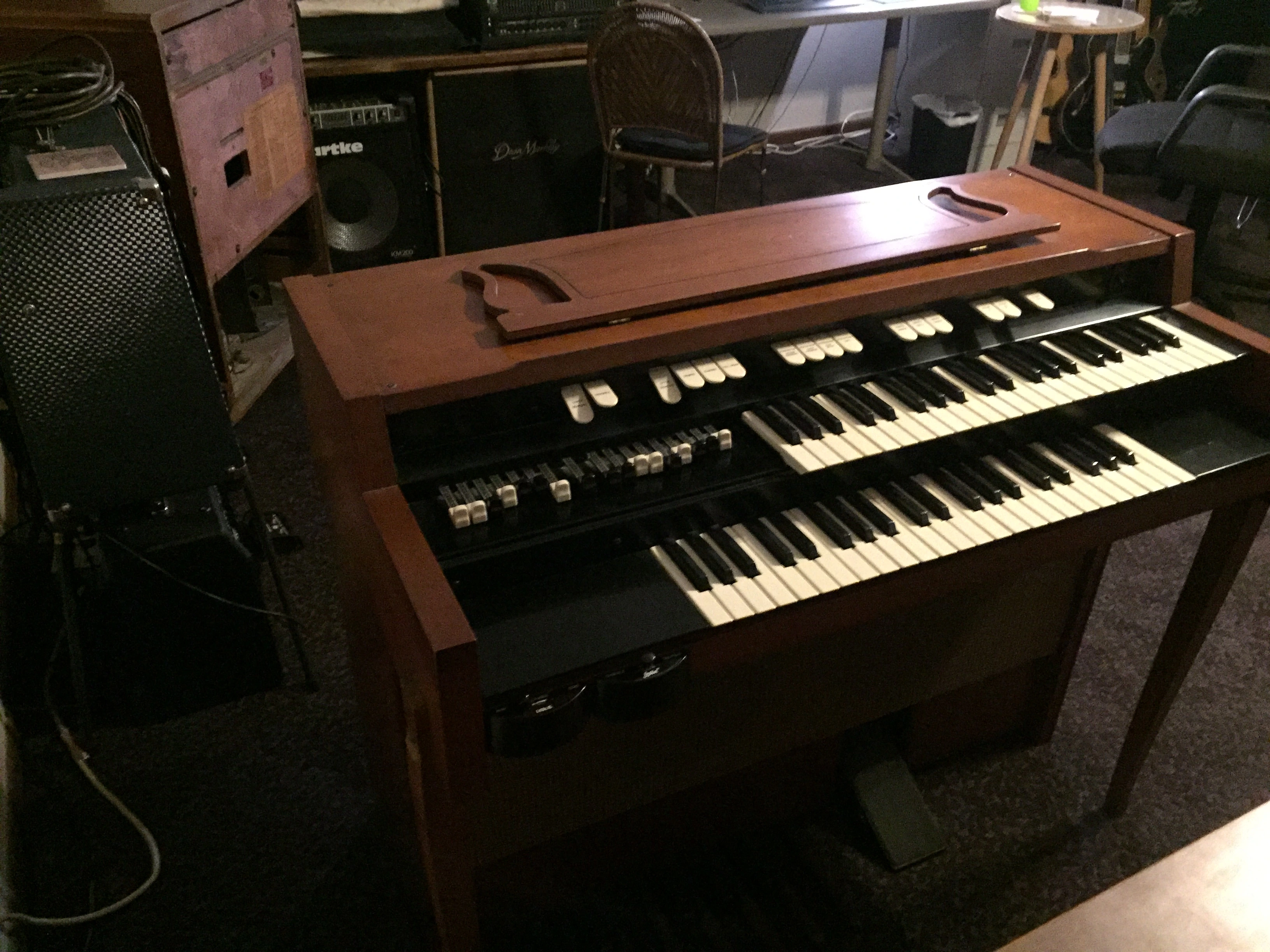

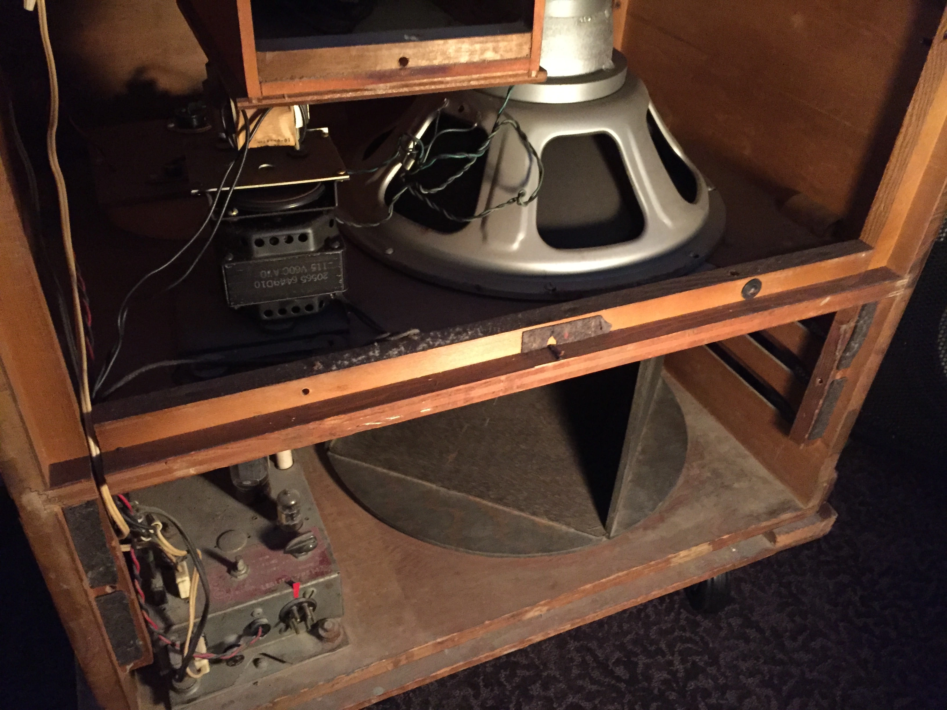

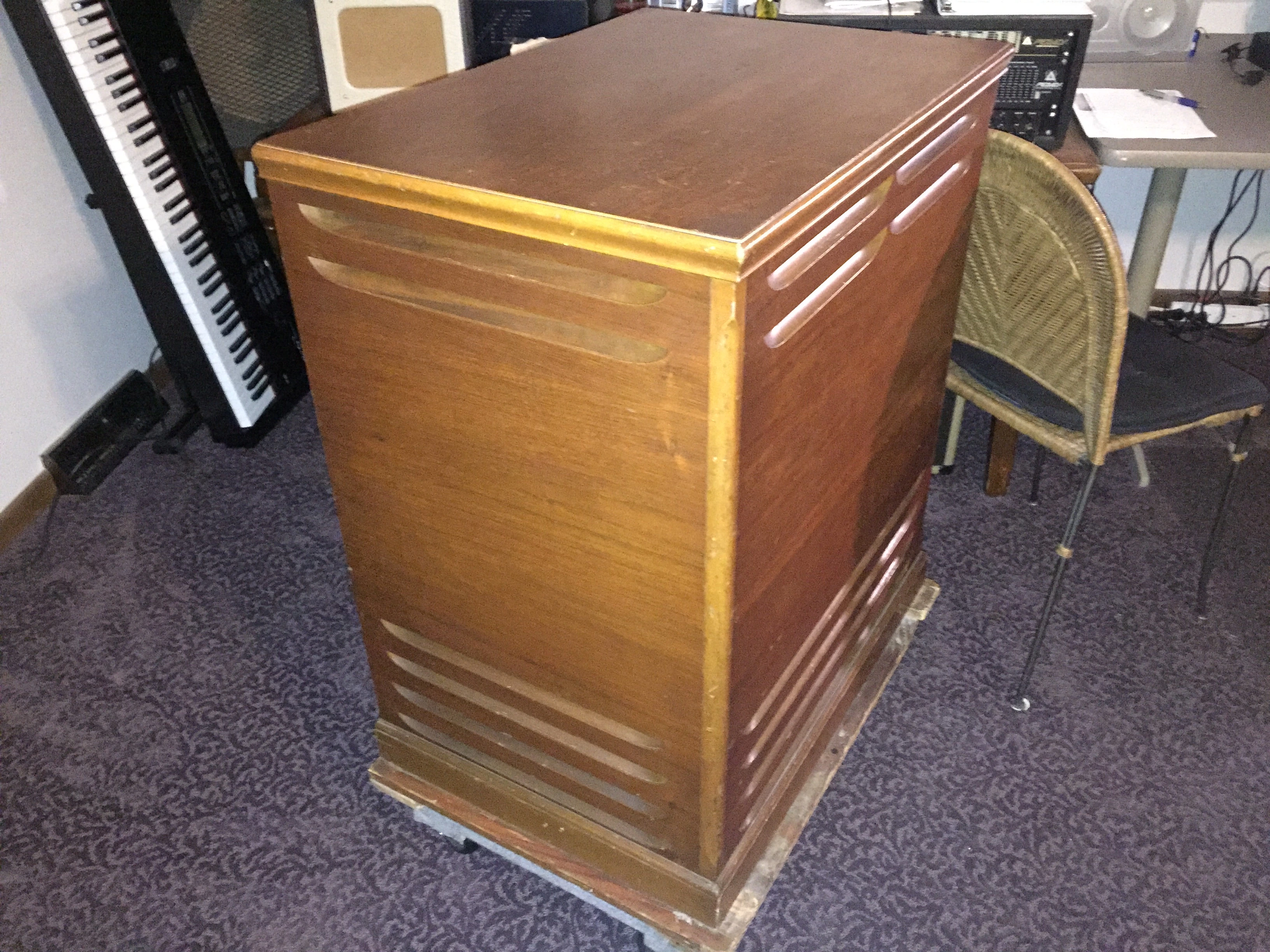

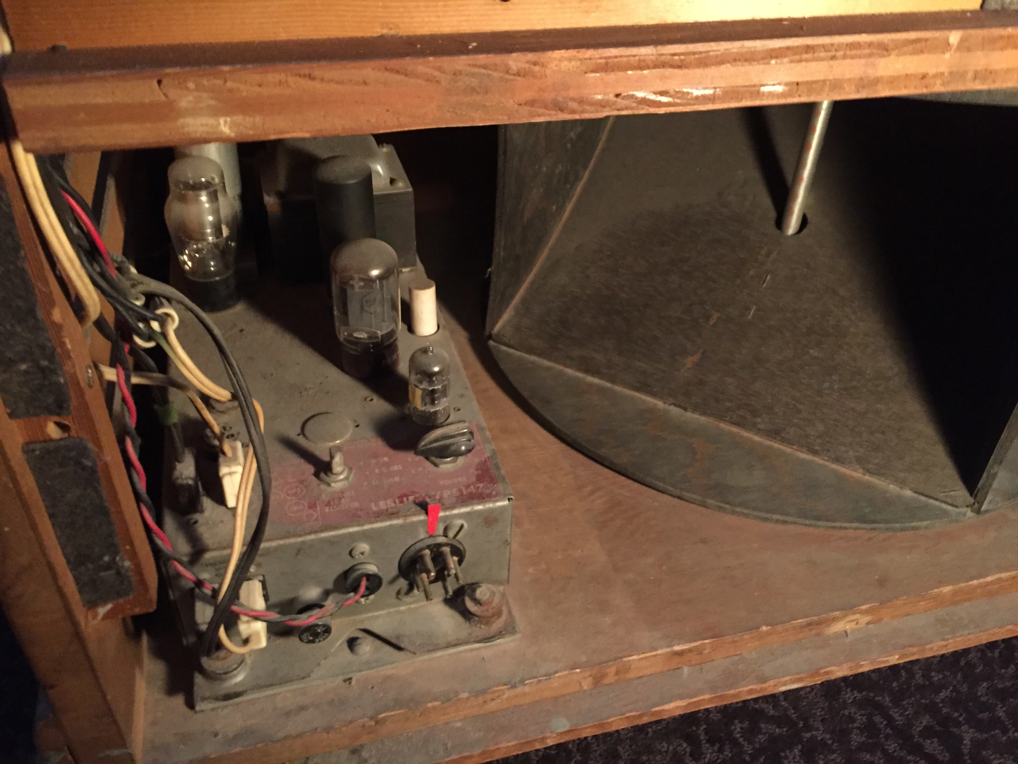

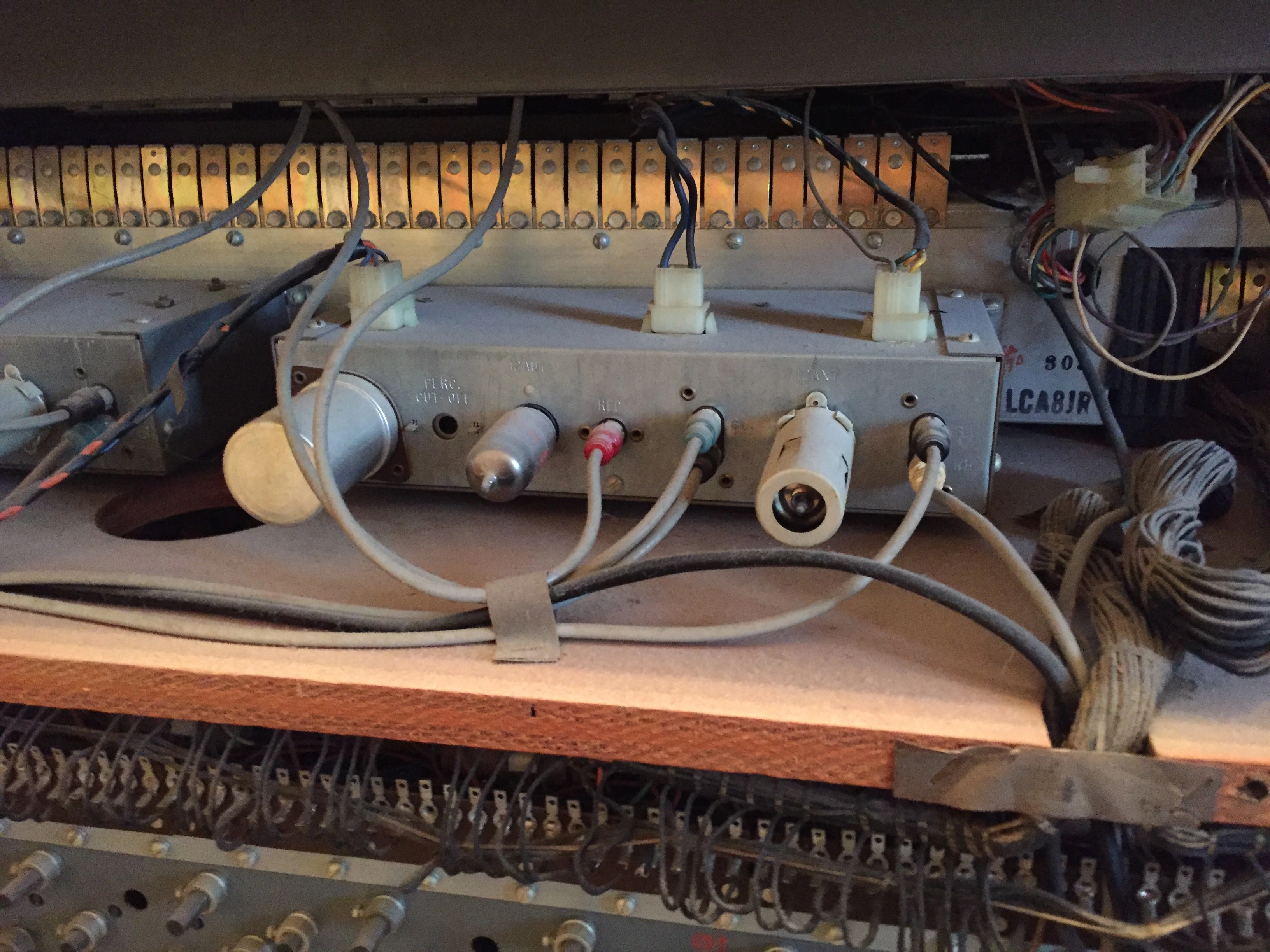

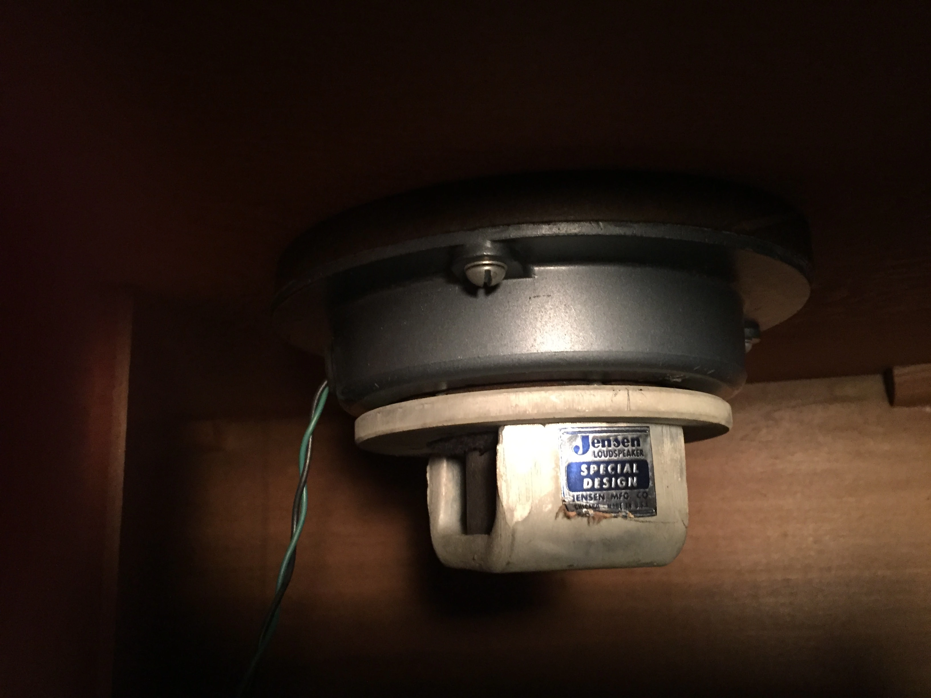

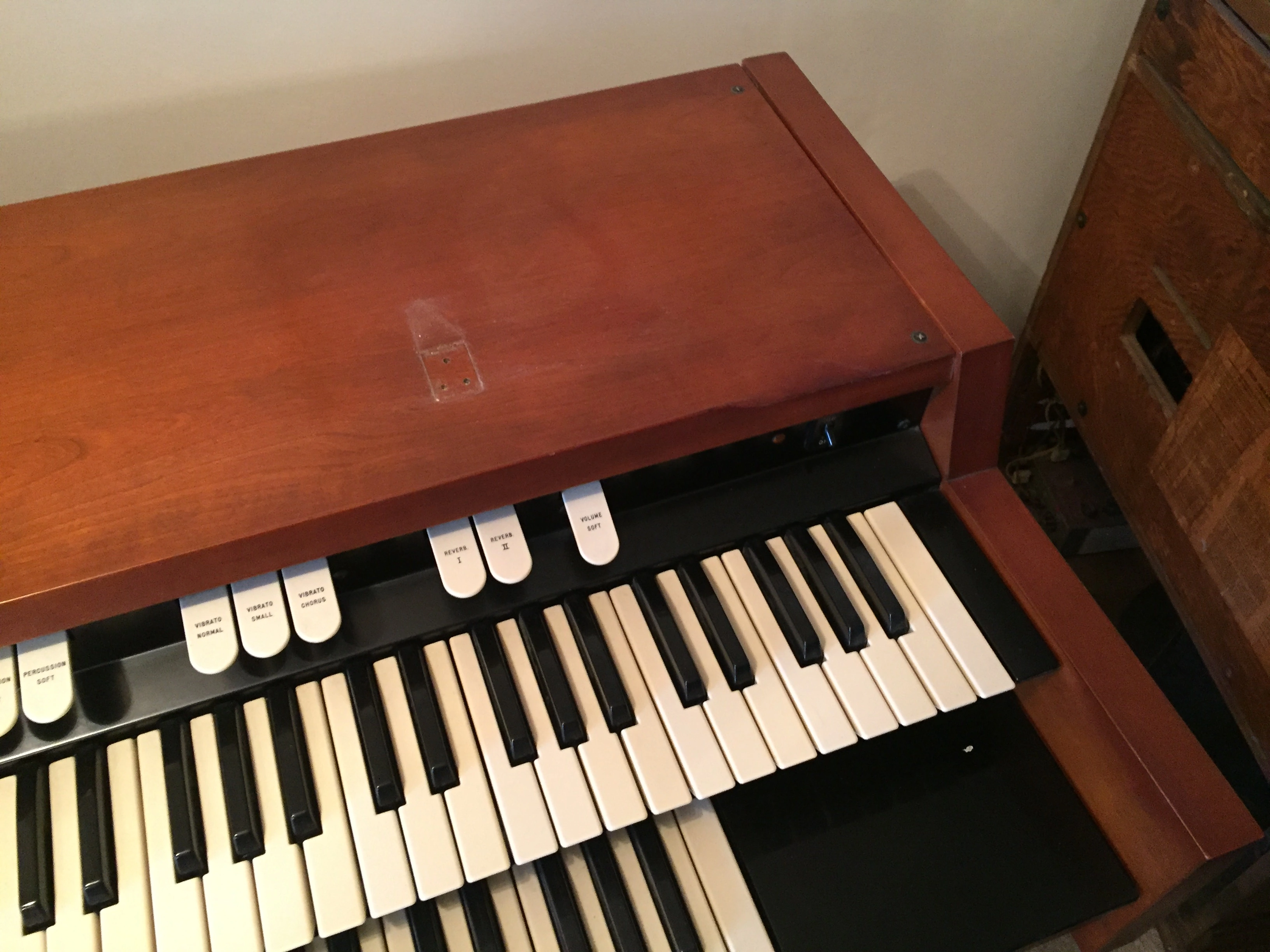

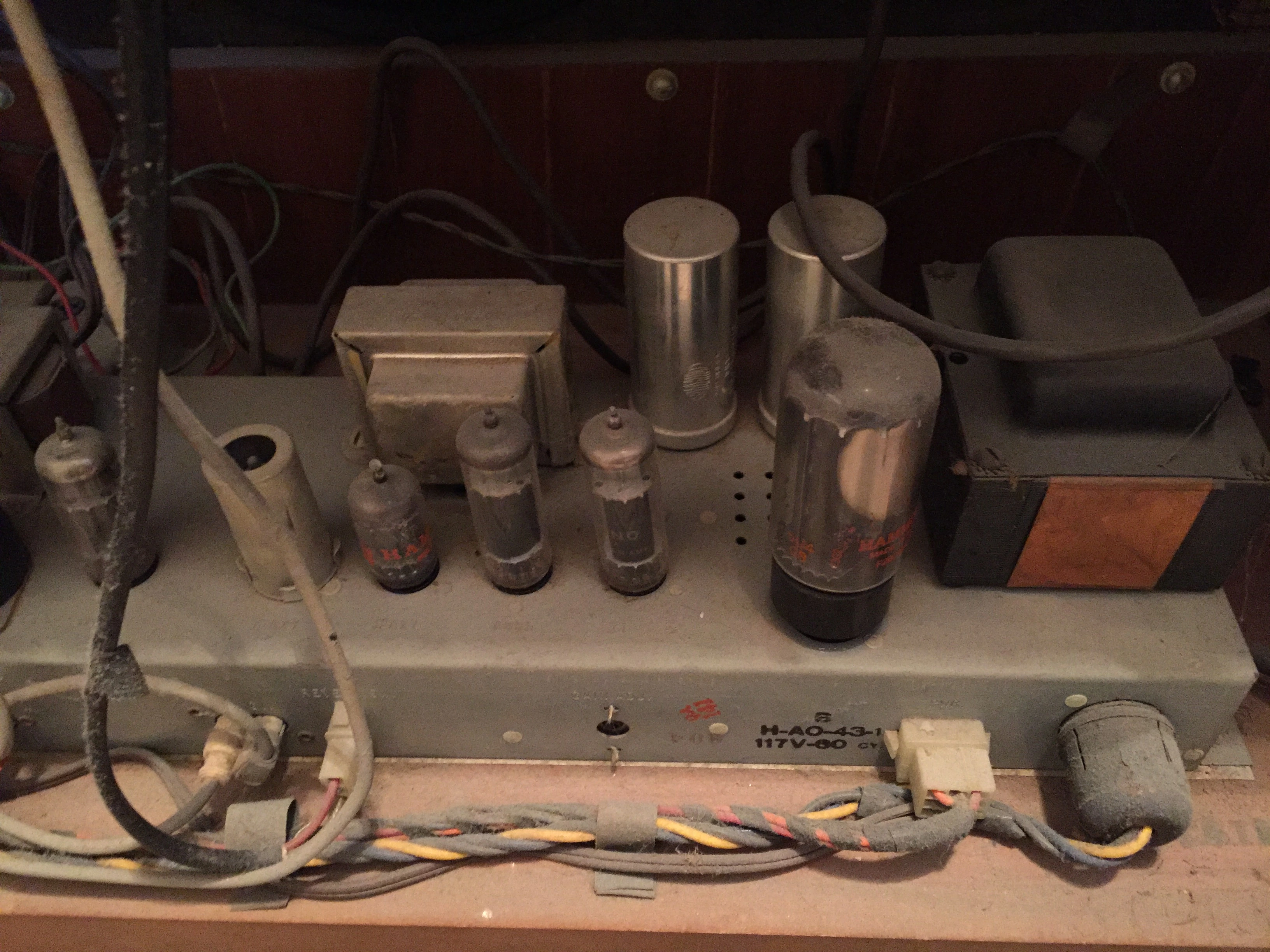

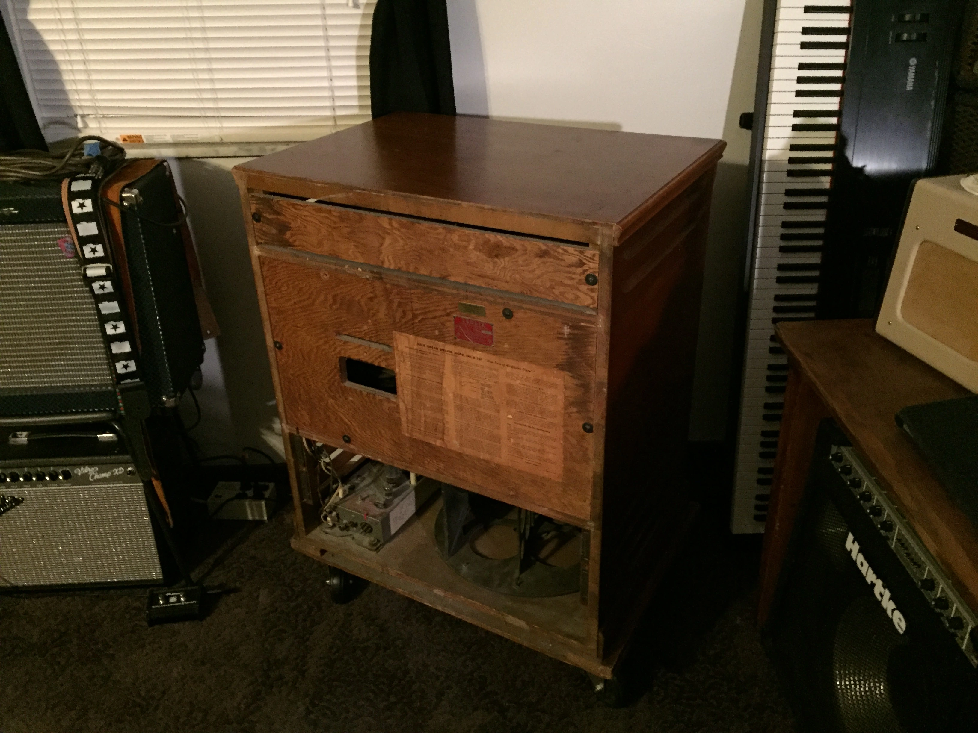

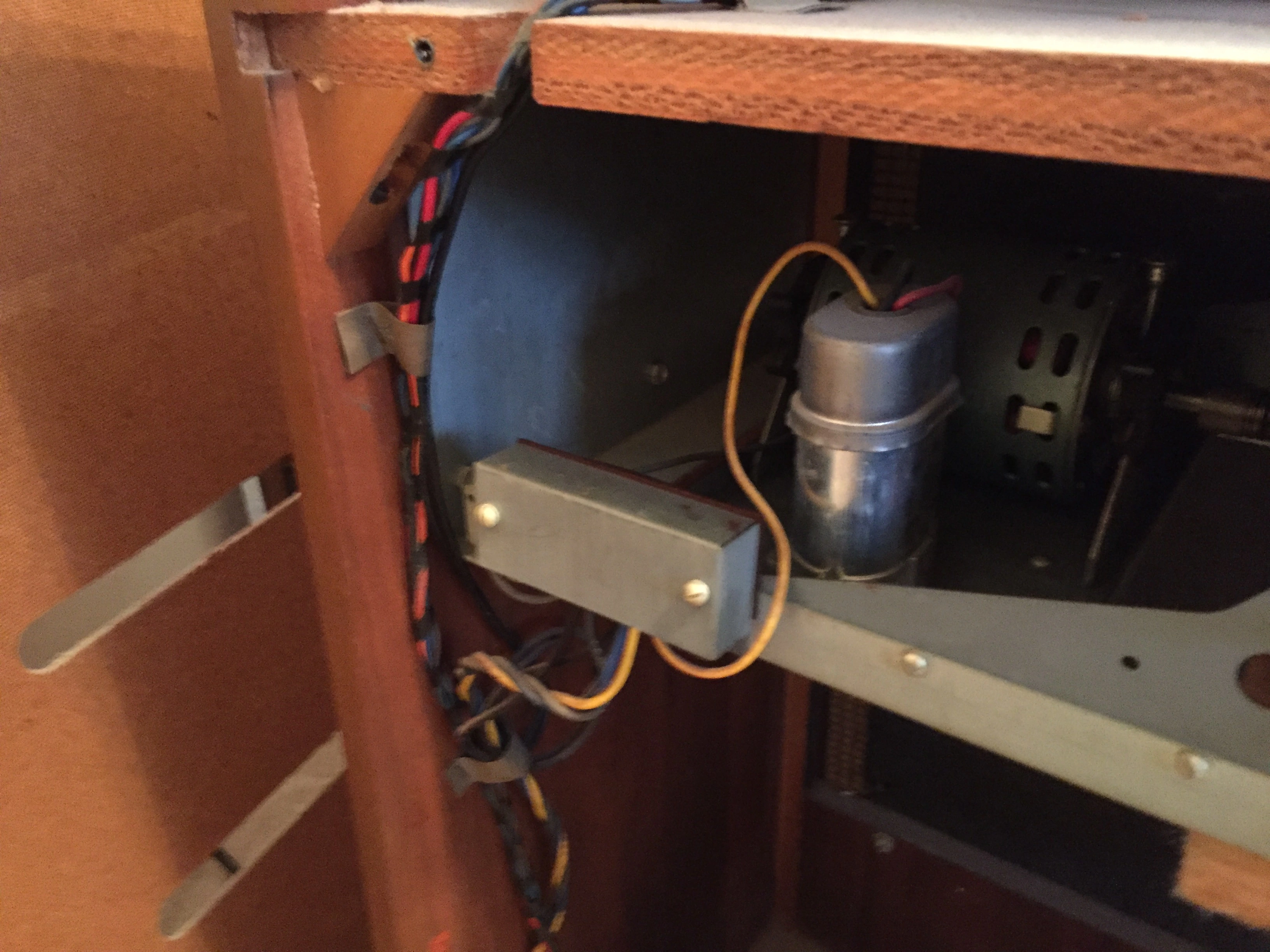

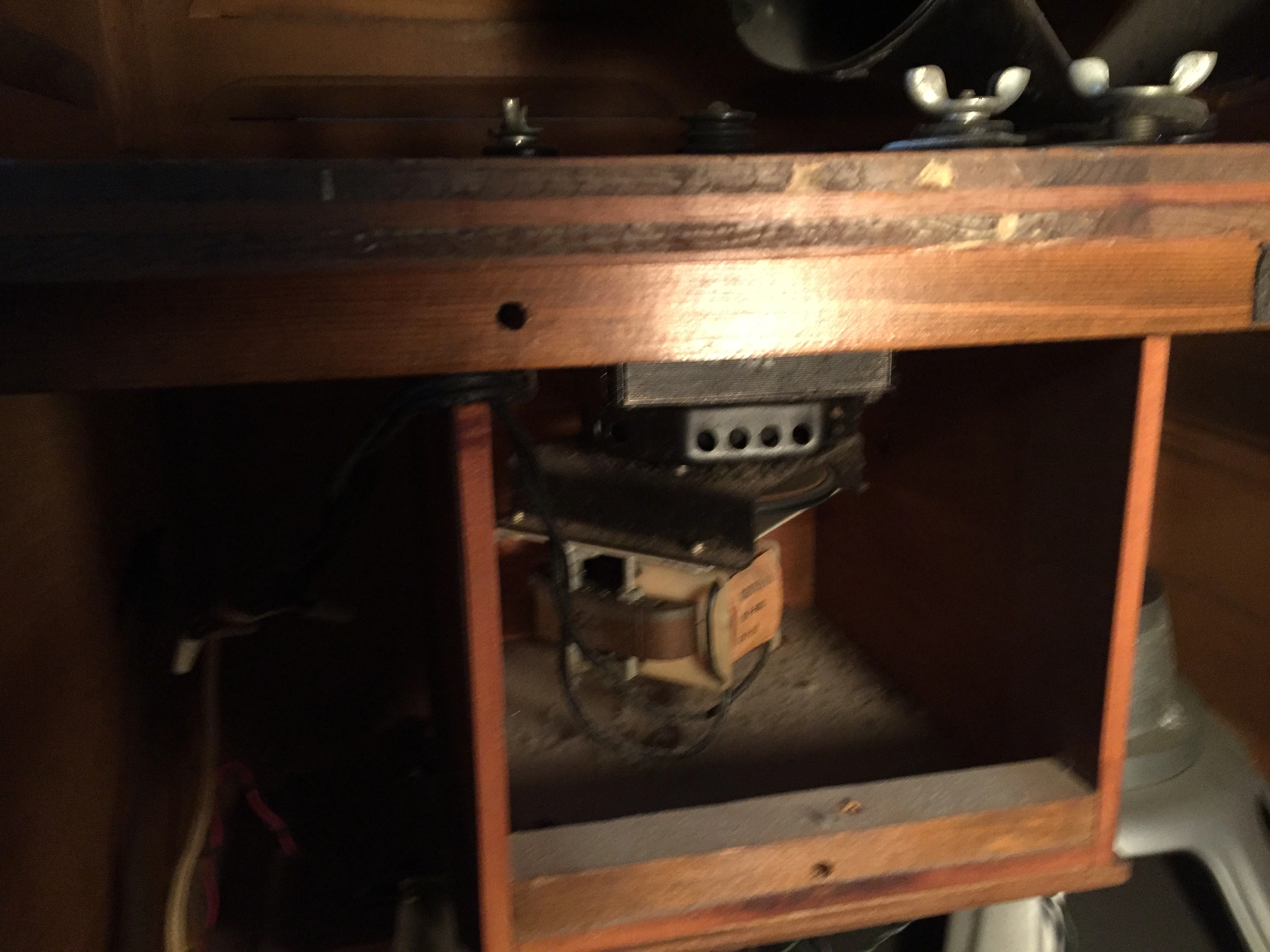

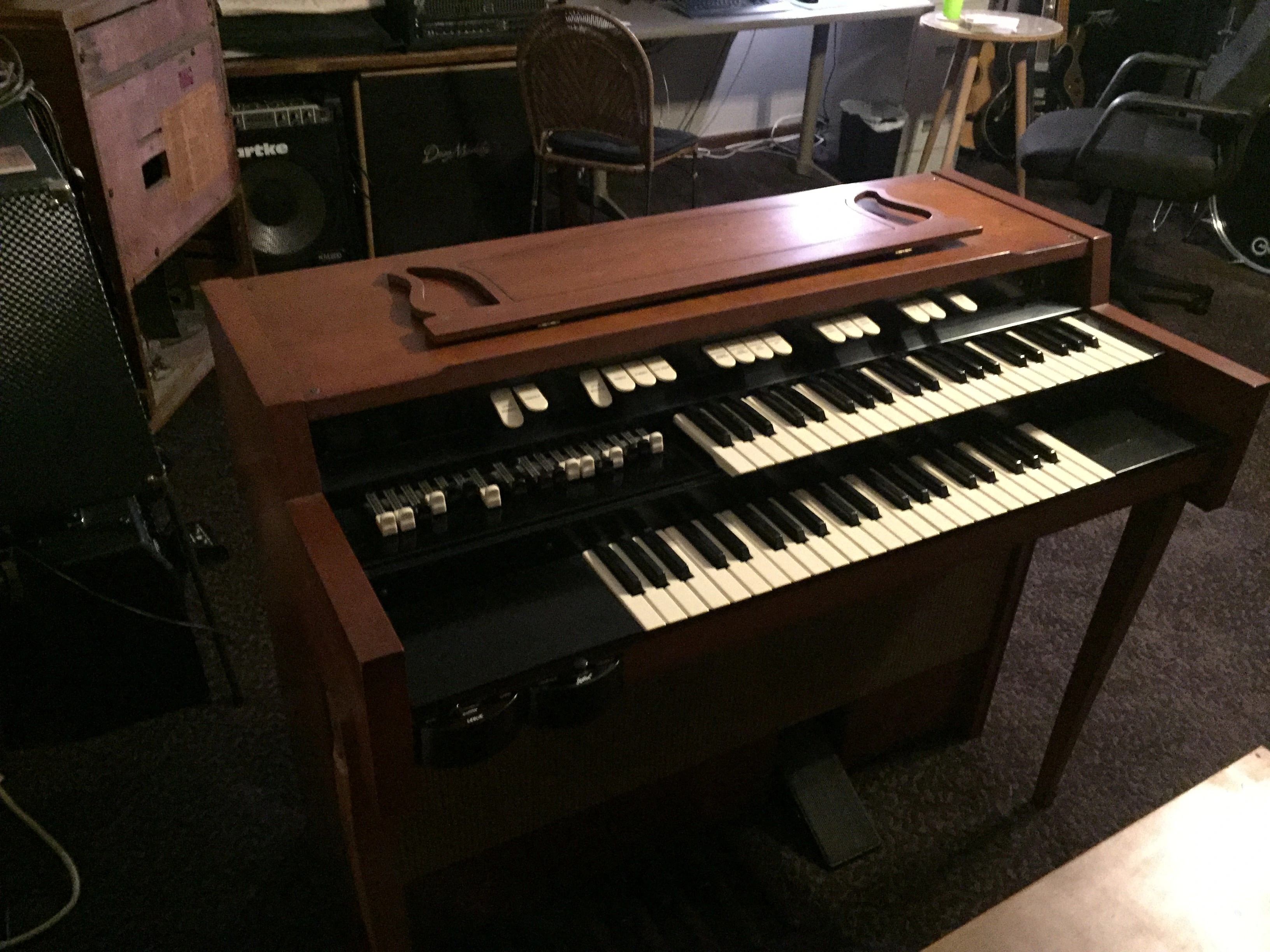

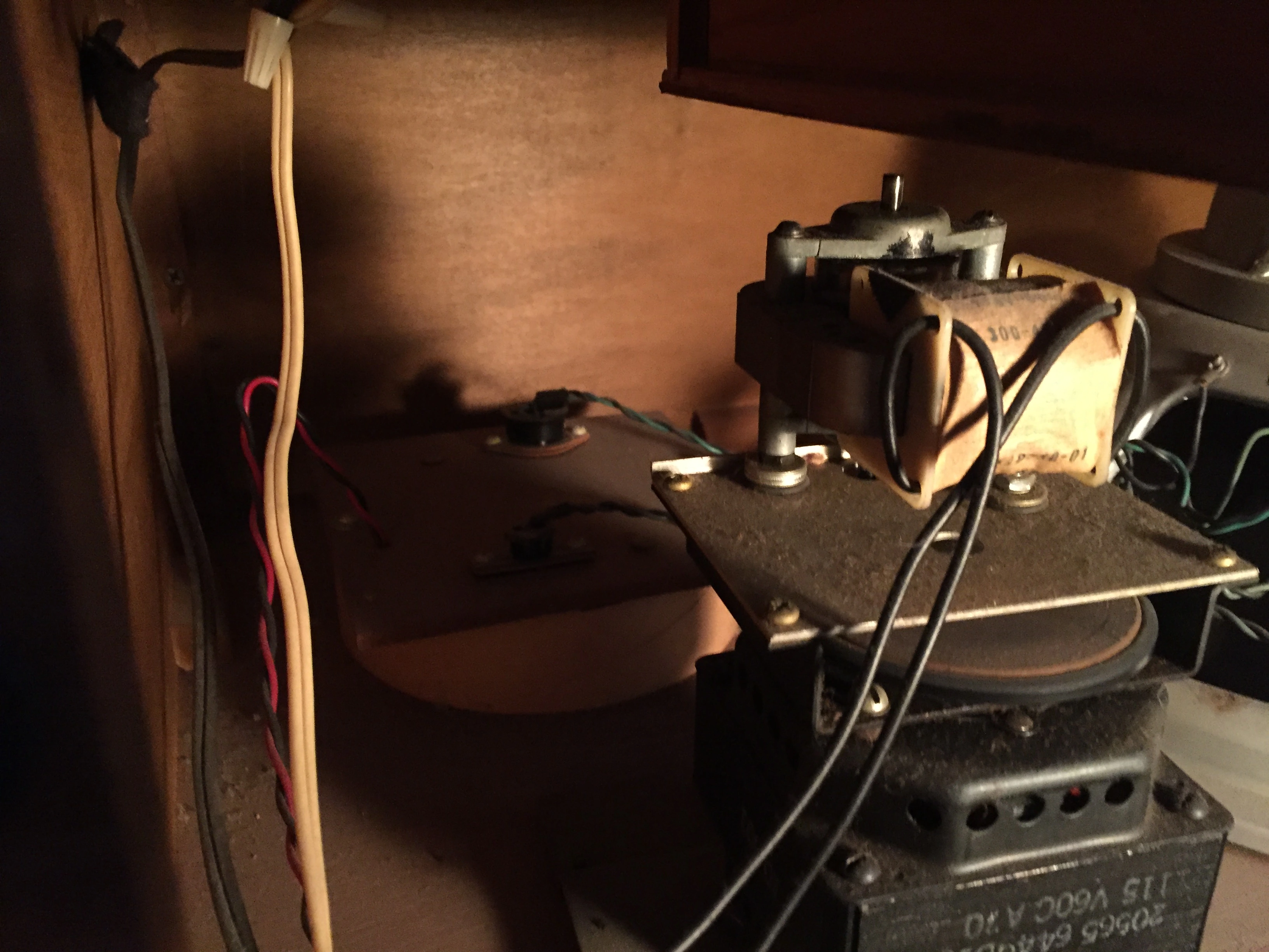

I know, not the right way to reply with quote but gets it done. I am going to attempt to load some pics here so hopefully that will work and they might be right side up?
First, the Leslie 145 is the shorty version of the 147. It has a 15" woofer firing downward into the drum for the low tones, AND a high frequency driver firing upward into the spinning horns. One side of the horn is blocked and no sound comes through that side. It is just there for balance. The 145 is a dual speed Leslie. When turned on, it spins at the low speed (Chorale) and a switch on the organ allows you to switch to high speed (Tremelo), and back. There are ways to have an off position so no spinning, but most just leave it spinning slow, then switch to fast. You can add a "brake" which makes it go slow immediately, but I like the coast-down sound best.
There is a Leslie (kit) to make the connections. The 145 Leslie has a 40 Watt tube amp built into it and it's very powerful. You need to use a kit as the Leslie motors and amp get the 120V power directly from the organ. The Leslie connects to the organ through a 6-conductor cable which also carries the speed switching conductors. There are variose kits for various Leslies, so just have to get the right one for the Leslie model you find / desire. If the Leslie you find doesn't come with a kit, you can find them on E-Bay and other sources.
My organ was built 1962 and Leslie is 1963. You can go online and use serial numbers, capacitor and speaker date codes to figure out year of manufacturer.
Repeating to the OP, please make sure you use real Hammond oil to oil the tone generator and motor. Only needs oiling one time per year. Other oils can clog and cause other problems. Your whiring noise is normal, but you may be getting additional noise from the tone generator if not properly oiled. A 60 cycle hum is also common, usually attributable to old electrolytic capacitors in the power supply and amps that may need to be replaced. The thing is likely at least 50 years old and those electrolytics go bad.
Please take a look at the power cord. At the age of these units they may be crumbling and very dangerous if not changed. Also, if it hasn't been done yet, replace the motor run capacitor. These things are loaded with pcb's and can explode without warning making a real mess. This is very important and inexpensive and easy to do so please do not put it off. It just makes sense to change this cap. A generator running slow or fast or up and down in speed may indicate this cap needs changing immediately, but why wait for it. Just DO IT NOW. Could be very dangerous to not replace this one motor cap.
NOTE! There are extremely high voltages associated with the electronics in these organs. Capacitors need to be discharged, CATION, CAUTION, CAUTION when working on ANYTHING with the amps and power supplied exposed!!!! CAUTION. If you aren't comfortable back there, get someone who knows what they are doing with tube amplifiers to help you!!!!!!!!!
Back to Miro, yes, you can get dual speed Leslie and switching at the organ even on the humble spinets like the M3, M2, M100 and L100 series organs. It is all governed by the Leslie model you choose.
Now, here are some pics...maybe...
These pics are from BEFORE clean-up. Taken on the day I brought it home. All tidy and clean now and sounding great. You will see that motor run cap I was talking about in a couple pics, right in front of the motor on left side of organ as viewed from the back. Two wires, easy access and Critcal to get changed out if never done before.
Enjoy...

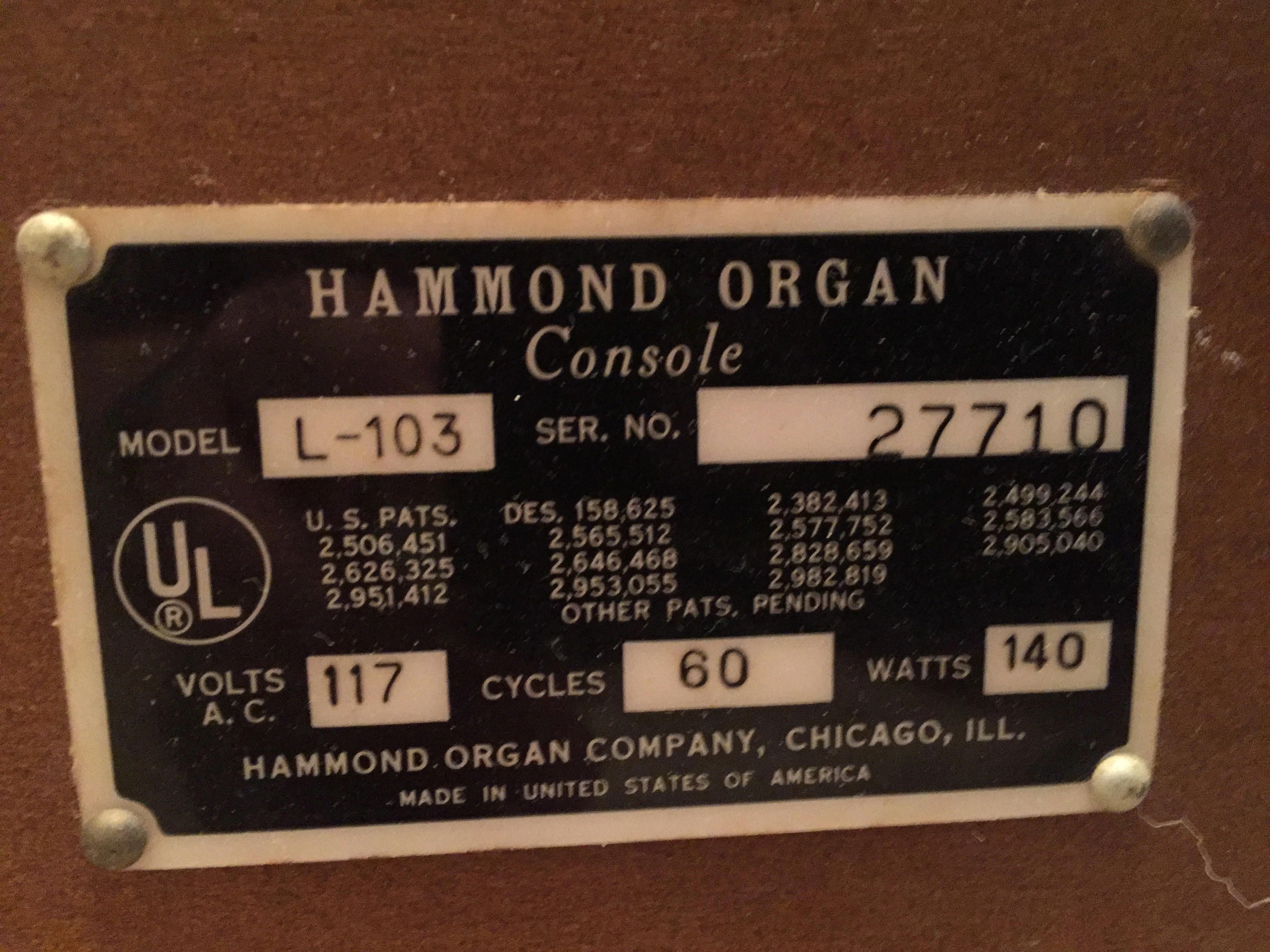

My L-103 is from 1965...was a one-owner that belonged to a college professor. It was low-use, and he maintained it very well, with a yearly visit from an organ tech...so when I got it, it was in great running shape, and I didn't have to do anything to it. I scored it for $200...and a work friend and I then had to carry from a second floor room, down a spiraling staircase, and lift up into the back of a pick-up truck. A bit of a struggle, but we made it happen.
Since getting it, I swapped out the Percussion preamp, though the original might just have a bad tube, but I had spare Perc and Vib preamps, so it was simple to just swap it. Other than that, I just keep it oiled yearly, and it's been running great. Maybe that motor cap was tended to at some point by the professor's organ tech...but it's an easy thing to swap out, I'll just have to find a new one.
I built them with Owen's Corning 705 built wood frames around them and covered them with fabric. I can put a link to the plans at a later time if you like. They were a game changer for my room.

You can get the motor capacitor from many sources but Tone Wheel General Hospital is where I got mine They have just about anything you would need for restoring or just servicing your Hammond. Beware, it is a very addictive time comsuming hobby when you get to digging g into these things but sooo worth it.. I looked again as the back is off of my organ and it is 3 wires for the cap but a piece of cake. It you go to Organforums.com there is a Hammond section and tons of good advice and just interesting material there. The guys there are very helpful. And can point you to solutions for many common problems. Just search for Tone Wheel General Hospital and check out the organ forum and those people can fix about any problem you may have.
I am really glad to hear you are going to replace the run motor cap! You will save yourself a lot of potential trouble.
Good luck h with your equipment. I know that you have the experience wiith electronic gear to be successful at whatever needs be done.
If you want to get some growl out of that L100 before you get your Leslie, a simple line out can be had at the expression pedal output. It is an rca cable and a simple rca to 1/4" phone plug will let you plug into any guitar pedal, then on to a nice tube amp, or other, and you can crank it to get a serious Jon Lord thing going on! Plugging in this way you will not get the organs reverb, but of course that is available on your guitar amp.I used an old cheap DOD chorus pedal for this and it worked great! The chorus was effective enough to get a half assed Leslie simulation, and cranked into a tube amp the sound is awesome!
Don't want to hijack this guy's thread so once you get into it just PM me with any questions. I haven't the knowledge of the organ forum guys, and I am a Hammond noob myself, but might clear up some simple stuff for you.
Have fun!!
Cool thanks. Similar here, standalone panels.

Yeah...no problem with working on electronics...been doing for years.
I've done some basic overhauling on the Hammond since I got it, but generally it has not needed much because it was in such great shape when I got it.
Mostly though, without the Leslie, I've not wanted to get into a lot of deep mods...but I have found ways (the line out option was one) to get more out of the L-103. Most recently I've used a guitar attenuator with a line out...but another cool way was to use my Radial JDX box and a Line to guitar level conversion, and than plug that into a Pigtronix Rototron Leslie simulator....but nothing will be the same as a real Leslie.
I just ordered a new run capacitor, but I ended up getting it from BB Organs, only because they accept PayPal, the Tone Wheel General Hospital doesn't.
Anyway...same capacitor at both places...but one thing I'm puzzled by...the original caps are 3-wire...but when I look at these new ones, I only see basically two connection points on the new cap, so where's the 3rd wire going...?...or do each of those legs offer an isolated connection point...?
(I'm sure it's going to be obvious once I get it and open the back of the organ. :D)
I guess I'm basically thinking there would be just a positive and negative, like most caps...so what's the third wire...back to the switch?
{EDIT}
Never mind.
I got my lazy ass up and decided to look in my L-100 service manual with schematics....DUH!...and I see that the Red and Yellow wires connect together at the capacitor, and then the red goes to the motor (black too) and the yellow goes back to the power terminal and the power switch, like I suspected. :)
Looks like about 20-30 minutes worth of work to de-solder the wires, remove the old cap, and drop in the new one.
{EDIT}
Never mind.
Yep, Easy Peasy. I used spade connectors instead of soldering on the cap. If I remember right they were 1/4" spade connectors (Insulated female disconnect connectors). anyway, you know what I'm talking about.

Hey...just wanted to let you know I scored a Leslie 145! :cool:
I wasn't even looking for one.
There was a guy closing down his studio not too far from me and selling everything...and he had some mics and rack gear I wanted to check out, so I went.
As we walked around, I noticed a Hammond (not sure which one, but looked similar to my L-series)...and he then goes and points to one of his booths and there was the Leslie, and he was selling that too, and I didn't need to also buy the Hammond to get the Leslie. :D
It came with a Leslie Combo Preamp footswitch pedal, and a long 6-pin cable. So it was all set up for instrument level signal...and/or I could get the kit for my L-series, but I am already able to get instrument level from the L.
Anyway...works great. I just finished doing a full cleaning overhaul and replaced the belts, motor O-rings and the cloth shroud that goes over the lower rotor.
I'll post back with more info...and some pics...but just wanted to let you know I finally have a Leslie to go with my Hammond.
Great news! Congrats! Sounds like you did a better overhaul on yours with the new scrim cloth for the rotating drum and all!
I have neglected to do much more cleaning and maintenance on my Leslie 145, but it just keeps sounding better all the time. I should really dig back into it to keep it up. Haven't been playing it much lately, but when I do, I just love it!
Congrats again Miro! You're gonna love the Leslie.
