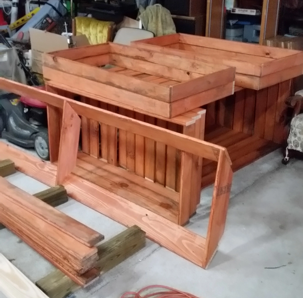

the frames are finished! for the main room anyway. I still have to build the frames for the control room, but since it is small I will build 16 inch by 48 inch frames for it. I am sick of staining! :D

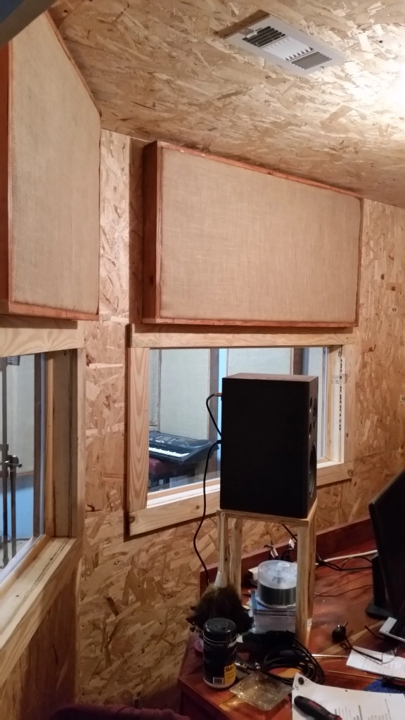

this the revised layout, for the wall panels, should I stagger them as far as height is concerned? for the control I plan on putting a panel anywhere I can fit one. Thanks:D
How do you even squeeze behind the desk in that 'control room'? I certainly would not want to try mixing in it!
LOL, its not to scale, I have about 2 feet from the back wall to the desk, I guess Im just used to it. as far as mixing in it, now that the mixer is gone I have plenty of room for drinks!:D

That's what I figured. That's not much room! I wouldn't be able to push my leather desk chair back far enough to get out of it in that space. Look slike you've filled all the wall space/corners you can with trapping, but its not a symmetrical layout, so the stereo image may be really skewed.

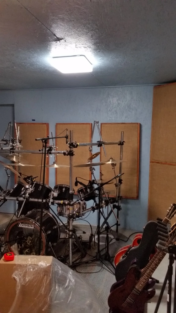

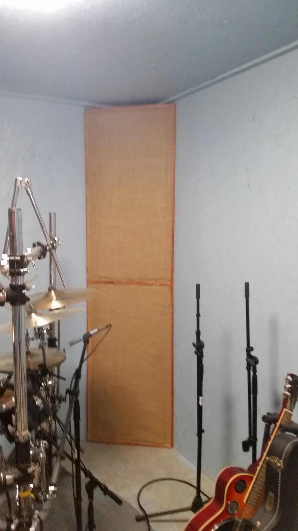

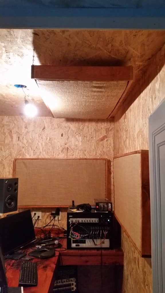

the walls are complete. on to ceilings next.:D

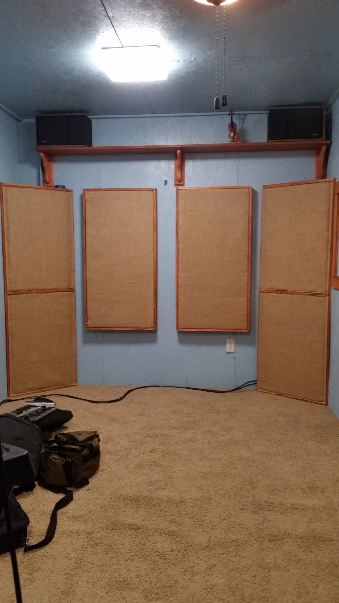

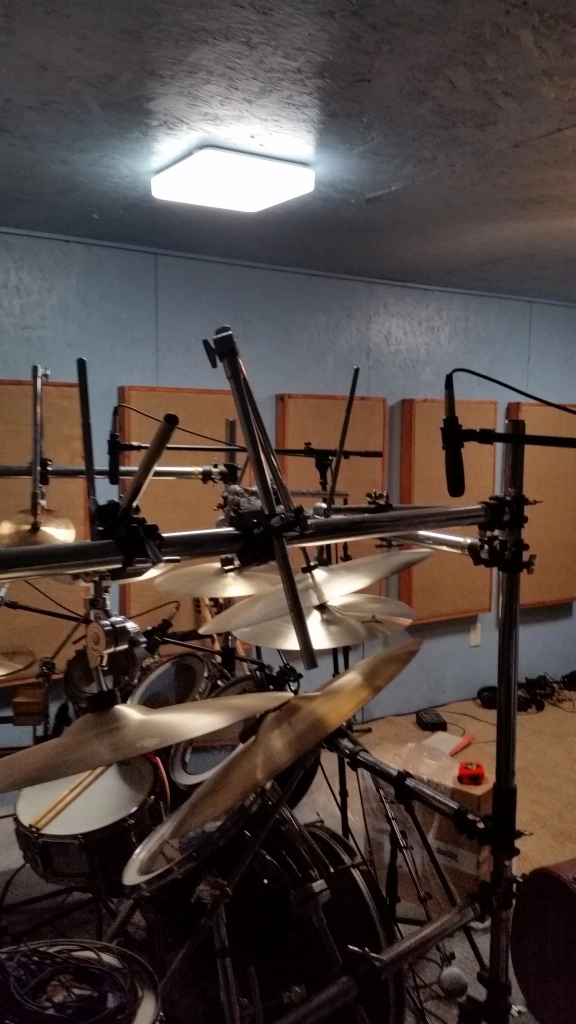

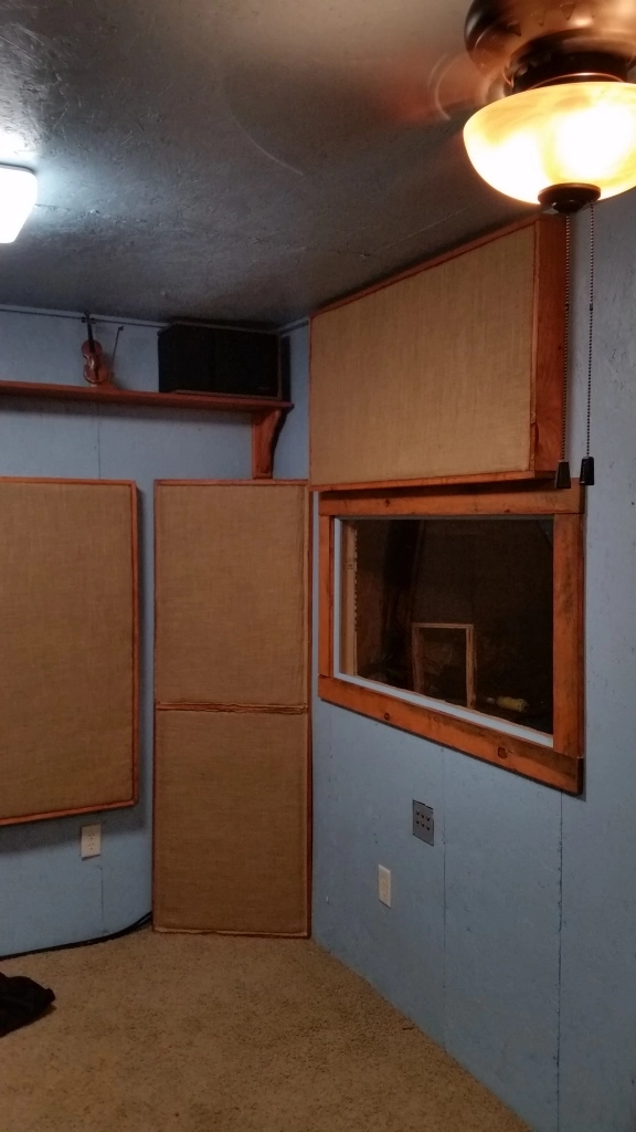

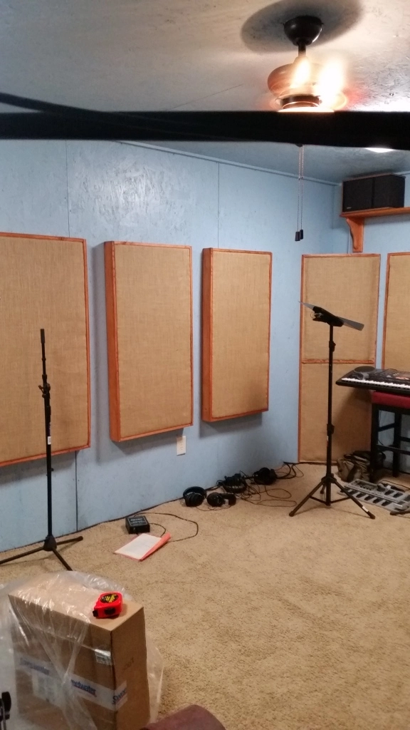

Are those speakers on the small shelf at the top of the wall with the keyboard? Are you trying to boost their bass response by putting them in an untreated corner? The shelf itself creates another 'corner' to bounce bass waves.
they are Bose 301s. I use them for playback and just to listen to music. I am going to also use them for talkback when I get around to setting it up. Thanks

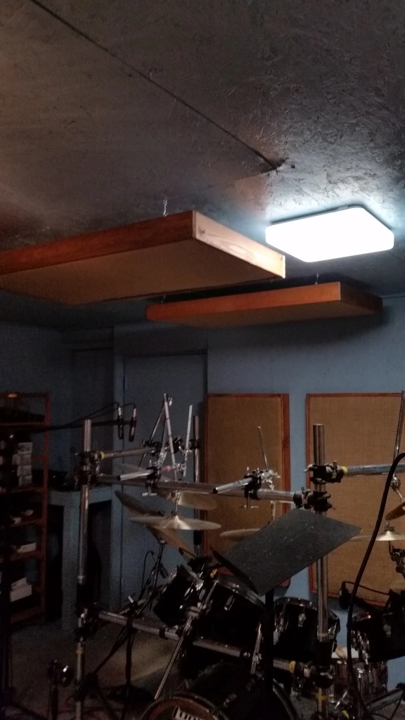

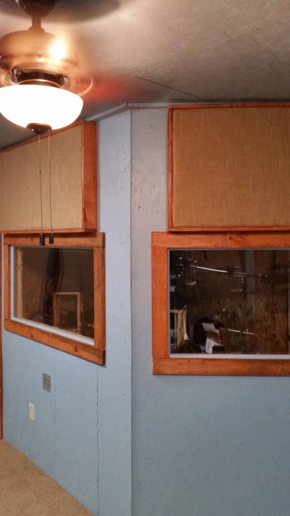

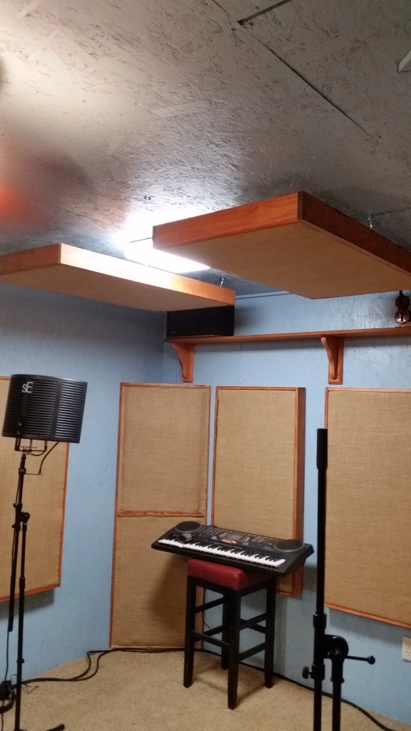

Ceiling clouds are done!:D

Starting to look wonderful. Needs a coat of paint or two in spots. Maybe you could get the wife to pick out some wall paper...:D
Are you planning any QRDs? I guess that will depend on how well the damping works from the panels, huh? I did just a bit behind my head when all was said and done to drive away some 800-1200 Hz problems. Worked wonderfully.
Bass problems went away with the traps (corners behind the mid fields and ceiling/wall behind me. Echos went away with the side walls (primary reflections). Flutter went away with the ceiling clouds. Hung more panels on the walls behind me, but still had the mid problem, so I built some simple diffusers from 1.5x1.5" on 18x18" pieces of plywood. Measured the lengths according to a program I downloaded (but don't remember the name of) and POW, no more problems. Lot of gluing, though. :)
Thanks! the main room was just painted, my girlfriend picked the color. have to admit I was not a big fan at first. but the colors came together with the traps. I am pleased with it. I dont think I am painting the control room. I like the contrast. as to wall paper? I will slit my wrist 1st! The worst fight me and the EX ever had was hanging wall paper.:laughings: I still have to figure out how to cram a couple of corner traps in the control room. it has made a big difference in the main room, I can tell by playing my drums it is much better. I hope to record some stuff this weekend. I have some more roxul panels ordered. I still may put some 2x2 traps in above the existing wall traps. :D
