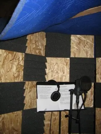

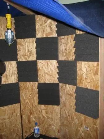

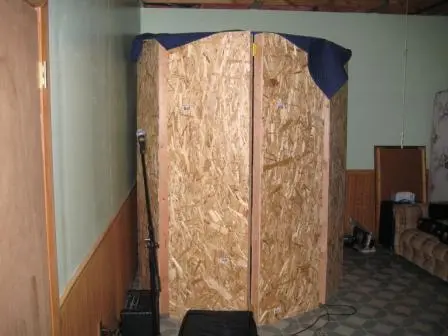

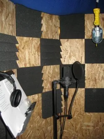

Dimensions and materials:
4'x7'
2x4 Wood Frame
4" Ultratouch in between pressed board.
Auralex tiles.
Door hinges to connect a pair of walls together
Moving blanket above
Seems to work pretty well.

What's the point of the pressed board?
I think (if it were me)
I would have put all the mass of wood on one side, left the ultrabond pressed between the studs and then covered the ultrabond side with some fabric.
It would have made it a lot more absorbant.
If you were going for the dry sound that is.
to hold the ultratouch in place.
But that will cause the sound to reflect. Not much will be absrobed by the ultratouch. Why not remove it and hold the ultratouch in place with fabric?
Me too, or just no mass anywhere. The mass wouldn't really help much anyway.
wow..sweet. it looks like it can get pretty hot in that cave
That's probably what I should have done...I originally had no board on one side, but the ultrabond kept falling out. maybe I could've used strips of wood or the cotton that you were talking about. Too bad I might have to sell these things soon...
