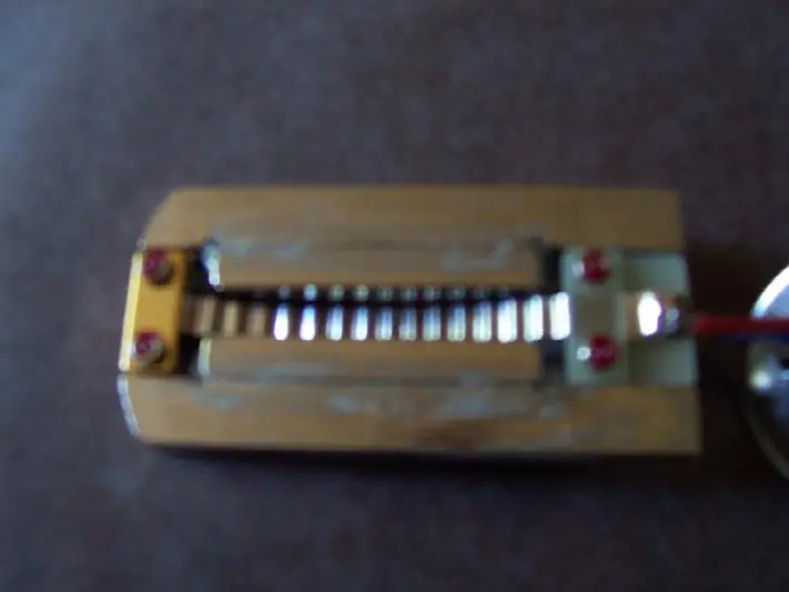

Alright, I think I might have figured it out. How slack/taught is the ribbon supposed to be? The one in my HRM-10 is very lax (see picture -- sorry for the blurriness). Should I attempt to take out some of the slack (and how exactly would I do that)? It is just flopping back and forth, which may account for the buzzing. Any thoughts?
It's hard to tell from the pic as it is blurrie but it appears like the red dots are screws. If that is true it looks as if they were loosened a bit you could increase the tension on the ribbon then re tighten the screws. Did you open your other ribbon to see if the ribbon inside looked the same tension wise?

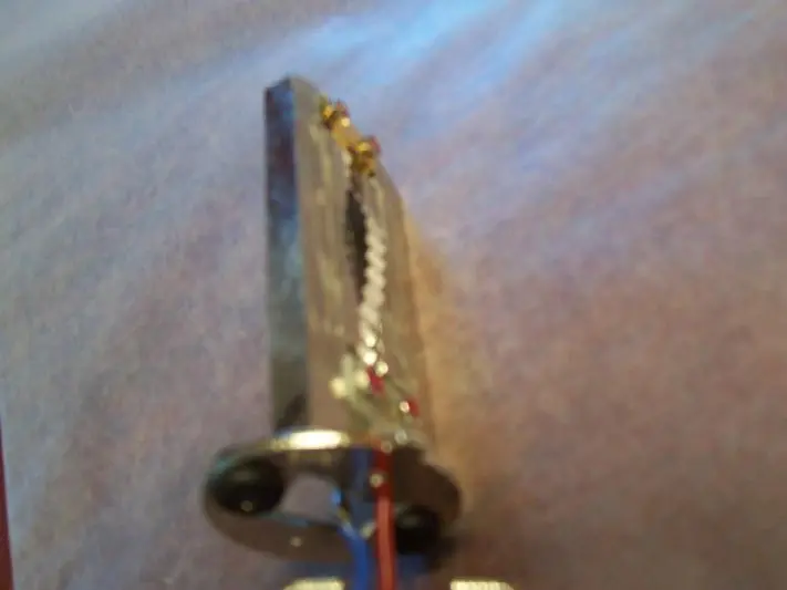

No, I haven't looked at the other one, yet. Here's a slightly better pic. The ribbon could easily be vibrating against the mesh cover with this much slack.
Yep, that was it. I pulled more of the ribbon through, so it is a little tighter (but still corrugated), and that took away the buzz. Yee-haw! Thanks to everyone for helping out. :cool:

Well, I loosened the two nuts at the bottom of the ribbon, took some tweezers and (very) gently pulled the ribbon to take out some of the slack. I made sure it was still centered between the magnets and tightened it back down. Not too difficult, but a steady hand does help. The ribbon is extremely thin, so I could have easily been sending this thing off for a re-ribbon had I slipped. I was also very cautious about which direction I was breathing during the entire episode.

Yeah, good on the repair, ribbons should definitely NOT sag like that. My secret weapon tool for moving ribbons is the flat plastic toothpick that came with my swiss army knife. A dab of isopropyl alcohol on the tip causes the pick to gently adhere to the ribbon.
