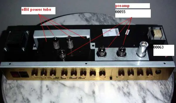

So I found another tube, 00063. It was underneath a silver cap/cover next to the transformer.
Is this a 12x7 type too? ECC83S?

picture showing the tubes and "odd" capped tube
thanks Legionserial
I looked at the schematic on the link ...and all 4qty "preamp tubes" are ecc83 on the schematic.
however, physically I removed 3qty Marshall 00055 and the "odd" one -Marshall 00063 (silver cap)...
very strange to a amateur tube-smith:D

I guess v4 is a "phase inverter", (the "odd" one with a cap.)
but the schematic shows all ecc83...so I'll get 4 ECC83S's or 12ax7 what ever GC has.

the silver cover is nothing more than a cover. it offers some protection.

hate to say it, but it's time to replace those 12ax7's. i'd start with V1, which should be the one under the cover, and then work from there. they do NOT need to be matched, but you probably want ones with balanced triodes for the phase inverters (typically V3 and V4 and closest to the power tubes).
The phase inverter is going to be the one closest to the power tubes.
That one is closest to the input jack, it's going to be the first gain stage. It has the cap on to give a little protection against noise, since the first stage with the low-level guitar signal is the most vulnerable..:)
