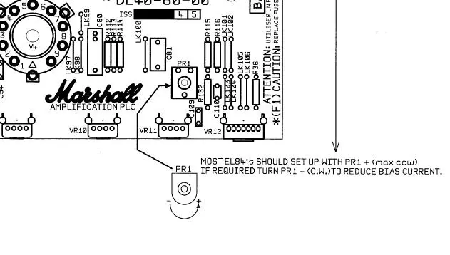

I read the Bias and its only .555mV (DC).
So I cranked the pot to 1.375V as the notes state and at full max I can't get 1.375V on CON5 Pin 1 & 3(grd). DSL 401: Model. At full open, I can only get 1.025V.
Anyone think I should adjust it back to .555mV ?
Or leave it at 1.025V?
Great thread and pics in below link...but I still can't get 1.375V? I did find on the schematic it says Max. pot...ccw to reduce bias.
http://www.historiclespauls.com/music/index.php?option=com_content&task=view&id=22&Itemid=48
Marshall's recommended setting seems a little hot according to Bob at Eurotubes. Anything between .8 and 1.0 volt is fine.
it would be hard for me to make a specific recommendation without knowing the B+voltage at the very least...on the one hand i would trust marshall to know their amp... but a quick look at the sheets from a bias probe indicates for instanc that a 100wt with 4 tubes running at 400-450V should have a plate current of 31ma per tube.... looking at the blurb you posted from marshall the pot reflects 2 tubes so i would expect it to be around 62ma of draw on that side....that's read from pin 1-2... to balance side to side i would check for a voltage between pins1-3 and zero them out... then recheck 1-2 again... alternating till it settles in.... check the B+ voltage and if it's not around 400V then PM me with the voltage and i'll look it up for you... if the voltage is lower you want more draw... higher less...
Some of the previous posts may have listed some other amps, some with a PR 1 and PR2.
This 401, only has one Bias pot, also its CON5 (connector 5) that has the voltage readings/ 3 pins. but 1 and 3 read the same thing. 2=ground.
401 has 4 tubes, and the 201 has 2 tubes.
I forget the name but the Pin 1,2,3, has 1 & 3 as the same reading which I found was true with the DVMeter.
I set the DVM to DC, 2V range....red lead on CONNECTOR 5- Pin 1 or 3, and the black lead on Pin 2....and tweaked the PR1 post with a small screwdriver.
The response was immediate. all that work for a 2 minute tweak?:confused:
