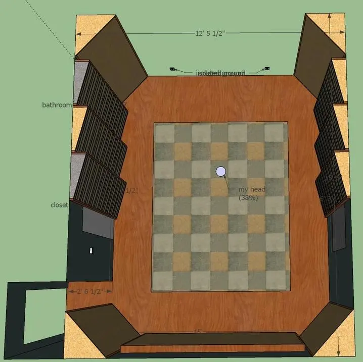

Well, I think I've finally come to a point where I can begin to treat and prepare my new room. I don't have a desk yet. I plan on building one. I also don't have a recording computer or interface anymore. I sold my old ones with intentions to upgrade and that's next after I set a good plan for the treatment. My hope is to get my main areas of concern and then fine tune treatment when I can test it properly.
Attached is a Google SketchUp of my mix room. A couple of things of note...
- The small thing on the wall is the thermostat. That can't be moved or covered so I'll have to build any treatment around it.
- The door closest to the thermostat is a closet
- The second door is the door to the bathroom. I was thinking of building around it and making my treatment (wood slats if needed) on hinges to be able to get through it.
- I put a single simple light in the center of the room with the intent to build a cloud and put recessed lighting in the cloud
I welcome treatment suggestions or plans. I'm hoping to buy all my wood (for slats, treatment framing, etc) and OC703 soon. One particular point I'm wondering is if I should go with hanging bass traps in the corners or super chunks.
I've done quite a bit of research on the topic of building and some on actual treatment (I have Rod's book and have read it a few times). I've been out of the game a while (because I just moved into my new house that was built) so I'm needing some refreshing. Another point that I'd like some direction on is where and when it is appropriate to use wood slats, etc. I've looked at quite a few of John Sayers' Sketchup drawings and plenty of pictures.
I can take actual pictures of the room if necessary. I'm not really worried too much about sound proofing. I'll be tracking in the room across the way from the bathroom (it's a Jack & Jill bath). But I'm a hobby recorder and I don't really do it on a regular basis. My nearest neighbor is quite far away. Two of the walls of the room are outside walls, which are brick. The area of the house we sleep in is on the opposite end, but that doesn't really matter.
Hope I didn't miss anything! Would sure appreciate some help/direction to get me going. I'm itching to get in this room and start using it but I know I have a lot of work ahead of me first.
I started to have my builder double up on drywall and do a staggered stud system for the room but I was already 30k deep on having to put in my own money on the house. I don't record often enough to worry that much about sound proofing. So...I elected not to do that. Just FYI.
I have a SketchUp file available...I couldn't upload here.
Alright, here's my drawing. Forgive my lack of SketchUp skills.
On the side treatment, I'm thinking of making those to where they're not fixed...so I can move them around if I need to. On that one bass trap, I'm thinking of doing the same thing. It'll be obvious which one I'm talking about once you see it.
I'm also open to other suggestions. I'm thinking of more bass trapping where the wall meets the ceiling on the back wall. That's why it's shorter. Thoughts?
Also, I know the front wall is "missing". I'm going to mount a 42" LCD there and treat it exactly like the back wall.
I'm also putting in a cloud about as far back as the angled side treatments go.
I would REALLY REALLY appreciate some thoughts, input, or something from this. I've toiled and toiled and worked hard on this drawing.

I'm going the slot resonator route by suggestion of some drawings that John Sayers did. I figure it will really help to redirect some of those reflections away from my sweet spot. They'll do broadband absorption and look cool while doing it, too. Everything I'm doing is DIY as well. Nothing really all that fancy. I just want to make it nice.
One of the topics I'm debating right now is superchucks vs slot resonator bass trapping. I'm not sold on the idea of having slot resonator bass trapping. Also, that rear wall (and the front wall) will have a 4" trap...2" of OC703 with a 2" air gap at the rear.
The rug, well, that's just for aesthetics. I don't figure it has very many acoustic properties anyway....not enough to damage or help, anyway.

I'm no expert on acoustics, but this looks like a very smart design. The wall on the left where it says 2' 6 1/2" is slanted (bottom being out that far), right? That's a great idea.

Well, I'm dealing with stuff on the back wall. So they are getting re-directed to a place where they will be further absorbed. I do not have stats on resonators vs absorption by room size and I certainly can't pretend to understand what those stats would mean if I had them. I'm just trying to do the best I can with what I've read and what I've seen. I know that every room is different but I'm trying to accommodate what I have with what people are suggesting. I mean, this room is going to have panels EVERYWHERE...traps in the corners, resonators on the sides, traps on the front and back wall...a cloud...I'm really trying to be pretty thorough. :D

Are you saying that these things are more difficult to build than I'm anticipating? These things seem like pretty simple construction skills. Given some known variables...build a box with some insulation in it. I mean, I know I'm over-simplifying it but, these things aren't hard to make. Makes me wonder if I'm missing something here...

You should have seen what I was trying to do before this. This whole situation has been a series of compromises since I moved into my new place.
You're looking at a 3D drawing in 2D form. That wall is not slanted or splayed at all. It's just an entrance into and out of the room. That measurement you see is just how long it is on that particular wall.
