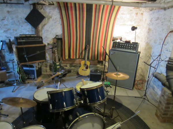

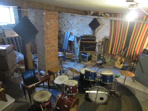

Those are pearl drums the red ones, and probably Star drums the blues.....the blues are WAY more high pitched sounding and the reds fatter. I believe the blues are older.....more keith moon sounding. The snare and bass drum have re-rings, but the toms do not, which is why they sounds so high pitched I think.
The red drums do have re-rings on all drums and as a result I think they sound less '60s-ping like and more '70s wooly-like sound so it's cool to have a bit of both.
+1 on the Star kit; I just got one recently, and I love it - it's just a cool little kit to own! I was thinking it had to be a jap kit of some sort, but wasn't sure. Cool Vistalites also BTW...
I'm still trying to figure out the VocalMaster on top of the showman cab!

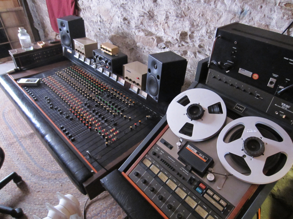

Lovely setup you have there! :-) That is some size of a machine for a 1/2" 8 track! That desk looks like the big daddy of the Teac Series 5 desks. I have one in storage and have been meaning to restore it and start using it with one of my 8 tracks. Them desks are so heavily built it's amazing! Really diggin the toy piano too! DING DING!
Your right it's a Teac 15!! Thanks for the kind words.
I have yet another recording I made on the 80-8 - perheps the best one I've made yet. I seem to be on an upward trend in terms of getting a good sound out of the 80-8. I'm not posting this recordings because the song idea I had was good or that the playing is good, cause it aint, but to demonstrate just how great the 80-8 can sound. And this was recorded on 1/2" tape FROM the '70s !! Reason being is that I've seen a lotta trash talking toward the 80-8 on the net. Usually these machines sound bad because people don't know how to get good sounds recorded. And honestly, this recording doesn't even show 60% of the 80-8's potential: add an extremely tight plate reverb, mic the guitars instead of direct like they are here...have a vintage stereo compressor at the master buss like the old DBX 162....etc etc............better mics...better bass drum mic.....and this recording would sound even more deep. The teac 80-8 is not a machine to bad mouth nor is the Teac 15 mixer; they really do sound as good as any '70s record I had just as long as you can use them right. It's not easy....it took me 2 days just to get this drum sound ......back and forth into the control room and into the music room is very time consuming.
Also, the drums are recorded to only 2 channels on the 80-8. It's like 5 mics send to channels 2 and 3 so the EQ had to be pre-dialed in on the drums. The snare's mic, a vintage shure 545 is running through a 1960s Bogen tube pre amp.
All the guitars, and bass are run through the same 1960s tube preamp that I love. It's a miraculous piece and can be seen in tan color sitting on the meter bridge - i got two.

+2 or maybe +3 on the Teac 15. Always fancied one. I'm assuming the pres are transformer coupled like the smaller model 3 and 5.
Is that why a flea market operator can say with a straight face that his old beat-to-hell Model 5 is worth $1200?
