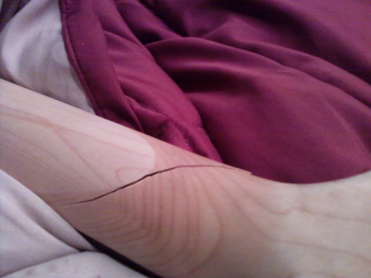

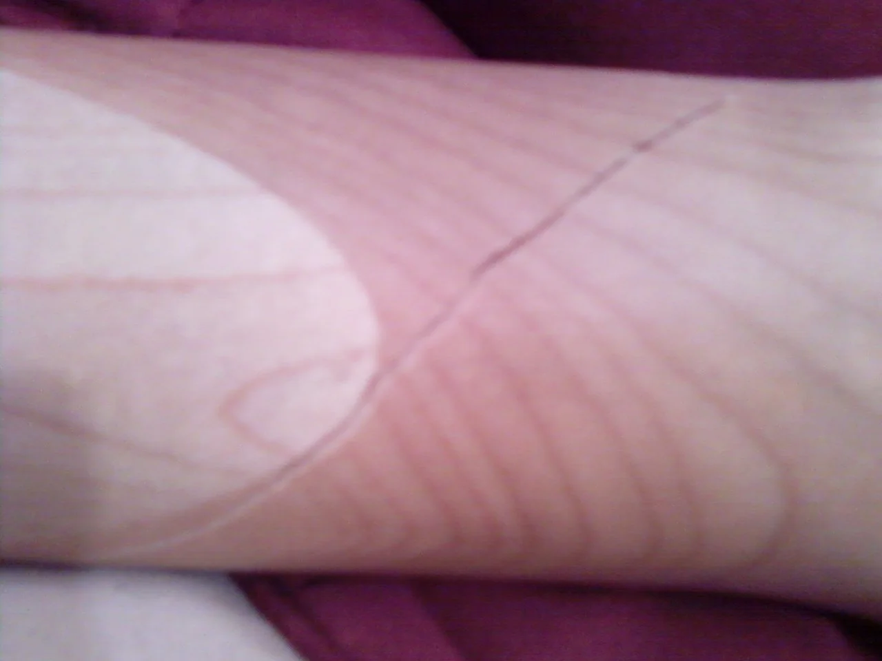

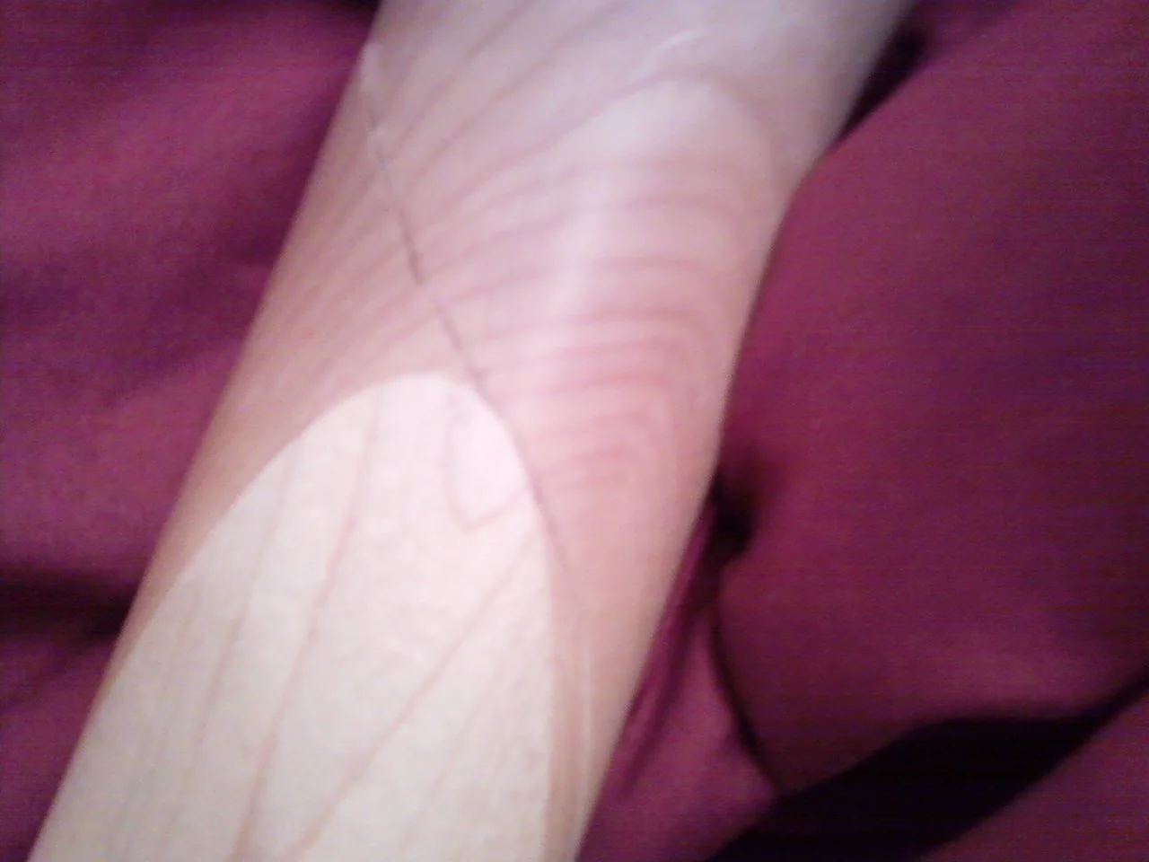

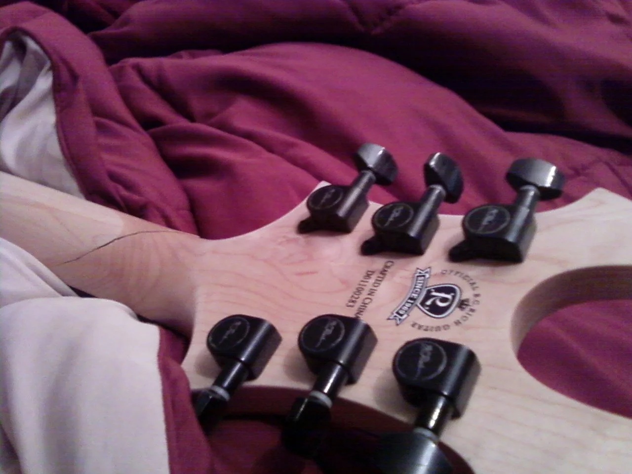

So i was wondering if you guys would take a look at my picks and tell me if you think this is fixable im guessing no but any help is welcome please help me!!!! I havent even owned it for maybe 6 months i dont have alot of money and if it is not fixable can you point me in the right direction as far as a website goes to get replacement necks perferably a bc rich avenge sob or a Warlock. Thanks for any input it is much appreciated.

To be the the bad news bear, no. Something like that is usually not fixable.
And, as a fellow BC Rich fan... ouch! That pains me to see that. You're gonna need a new neck for that. Even if it was 'repaired' in some form, your tuning, intonation and tone would be drastically different from what it was originally.
How did it even break like that?
Well im in a band with some buddys and our lead guitar player took his guitar off of our 3 guitar-guitar stand and he had his strap attached to the guitar and when he grabbed it his strap caught on the stand and knocked the other 2 down and well mines the one the cracked. Sucks. Hey do you know where i can get a replacement and would it be ok if i replaced it with a Warlock if i cant find a SOB????
I've seen much worse. That neck can be repaired with some glue and clamps.
Incorrect on all counts. It is fixable it will not be cheap but should be cheaper than replacing the neck.
Care to explain how the intonation and tuning would be affected. It is also unlikely it would affect the tone in any significant way.
Your best bet is to find a decent repair guy near you and get a quote. Google around for a replacement neck if you want to go that option.
That looks like the crack started where the head was spliced on. Sometimes they'll break at the glue joint. Won't cost too much to fix that.
It will definitely be cheaper to take it to a good woodworker, than a luthier.
Guys that break is not on the scarf joint. I'm afraid those things happen on instruments increasingly these days as availability and selection of the best timber is not as high on the list as it used to be. It is fixable.
We have all been lucky when stuff hits the deck but it only takes once to be unlucky. It is largely luck though.
Looks like a clean break so you should be able to repair it. If the repair fails you should be patient and try to find a replacement neck. OBTW get your own guitar stand.
It always amazes me the way BC Rich instruments break like no others.
