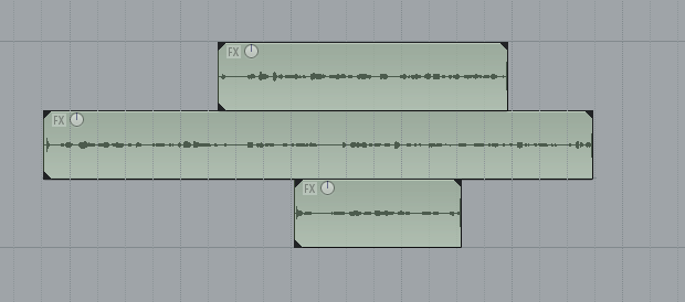

Also, the wave outputs (the graphical wave in the track lane) for -10dB were tiny, barely a blip on the line. Is that normal?

Yes, the small wave (compared to what you're used to seeing) is normal. There should be a way to zoom in visually.

Yeah, the wave is literally almost a complete flat line, with a few very small bumps to indicate strumming. Like, really small... I'll try and get a screengrab of it, cause I think it might be too small, but again, I've been doing this wrong all along so maybe not.
EDIT: Not my screengrab, but when I say the wave is almost a flat line, I mean it's similar to this:
Totally normal. I hate the thought of "mixing with your eyes" but that's a representation of a reasonably healthy track.

Your pics aren't much to go on because pretty much every DAW has customisable zoom settings.
Go on the meters, not the pictures.
