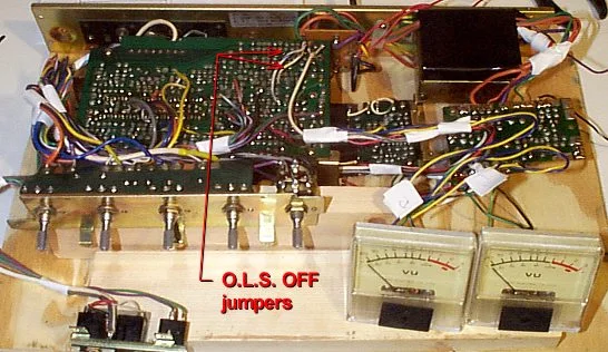

That's a GOOD thinking about ols. Actually after I've completed all the work and played with the 'device' around... I also had that thought: "Damn! I should of leave O.L.S. option available and design it 'into front panel' (I could of add couple nice miniature switches (separate for each channle, unlike original - one push-switch for both R/L) and add couple LEDs (OLS-"ON"). Still I may never need to use it in any possible situation ... but, You're right - you never know, and why not to have it?.
OLS is inseparable (on the 'main' board) and it is being disabled simply by two jumpers (see pic attached). I guess I still may add two mini-switches and make this option available, but it's pretty tight on the front panel as designed already, so I may add the switches on the back of the unit (you know,... in the style of 'inconveniently designed gear' ..lol , when the "user" is scratching his head and saying: "What the hell they were thinking while designing this thing ?"... :D :D :D )
