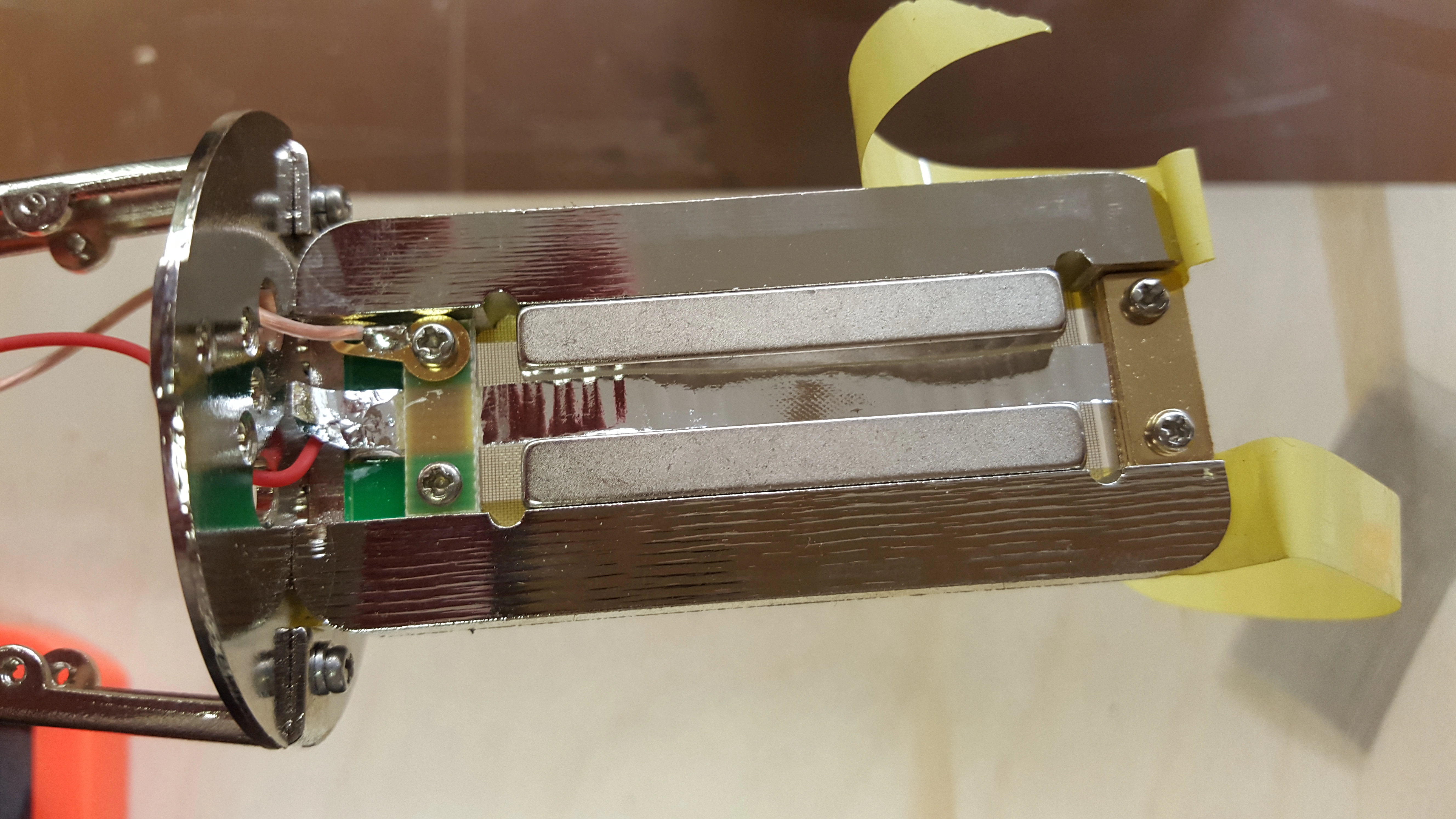

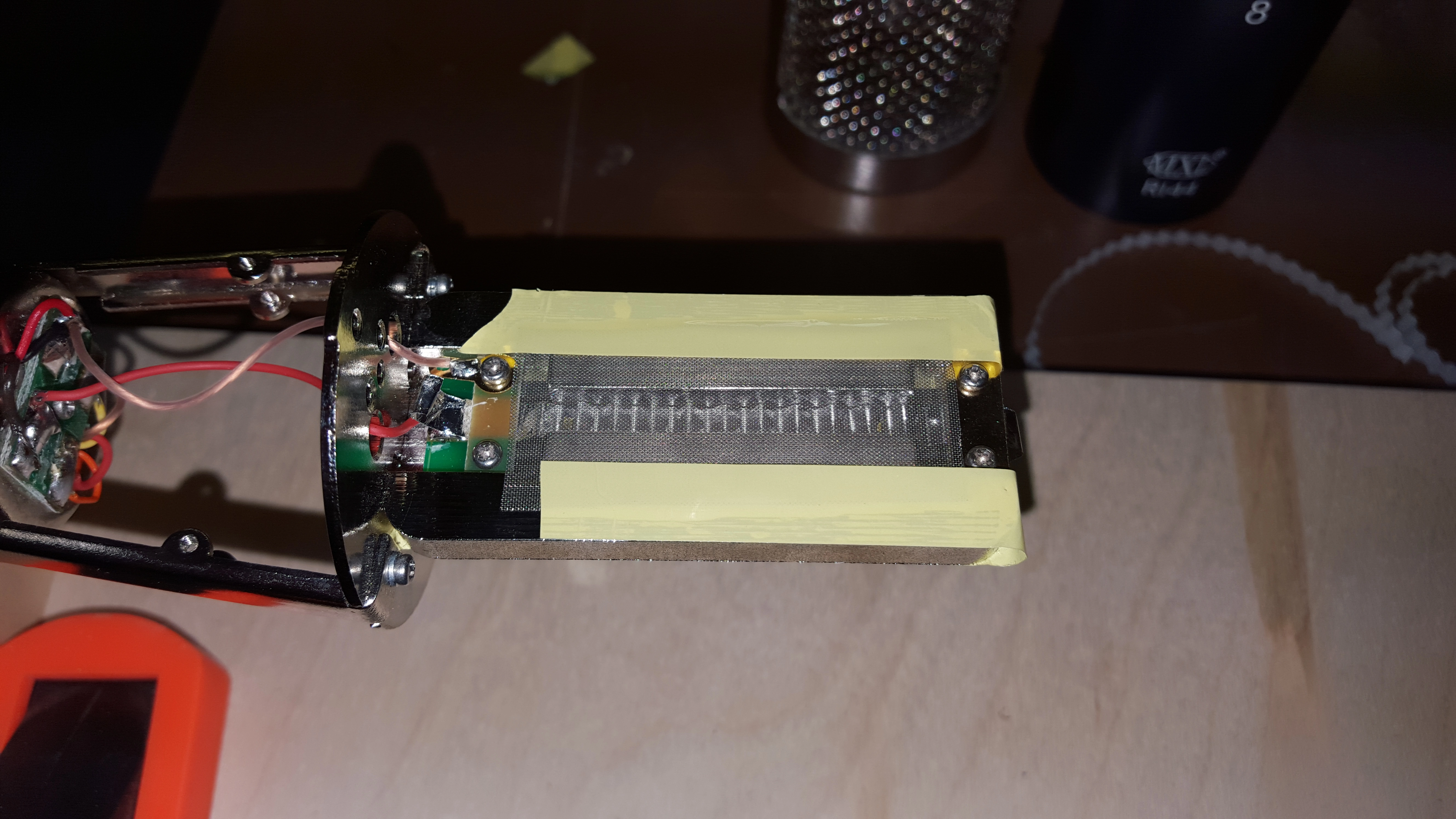

The MXL R144 is a perfectly serviceable ribbon mic. I replace the transformers with on made by Cinemag from Geistnote. I also install a new ribbon as most I have found stretched from the factory. Also, the 2nd layer headbasket mod opens it up quite a bit. I leave the mesh on the ribbon motor for a bit of added protection.
This is a proper ribbon.
This is a stretched ribbon.
